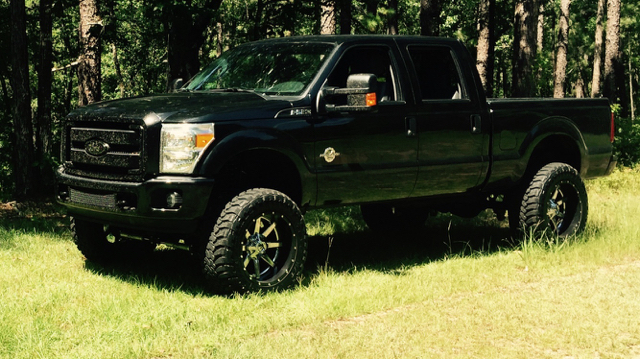

ImageUploadedByTapatalk1438665184.581411.jpgI installed a 6" zone radius arm lift a few weeks ago. Super impressed with the kit for the price. I went with the nitro shocks and added the dual steering stabilizer. Rides like stock IMO.
sent via tapatalk

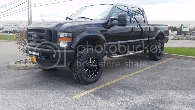

ImageUploadedByTapatalk1438750794.450954.jpgYep, 37's and 22's. Just added recons today so I snapped a front pic. Looks good with the zone dual steering stabilizer. I painted the shocks silver.
sent via tapatalk
