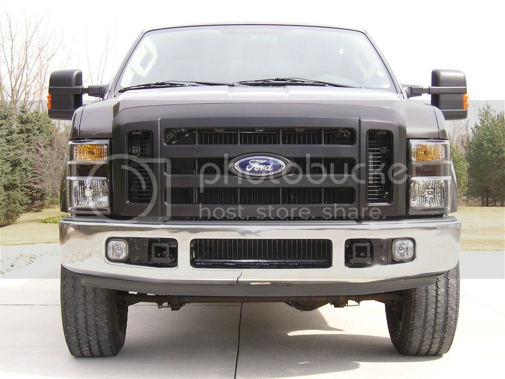

New grille and painted headlights.
[/URL]

Looks pretty damn good man! I really like the electric fan setup and the weight brackets. Stack looks awesome.

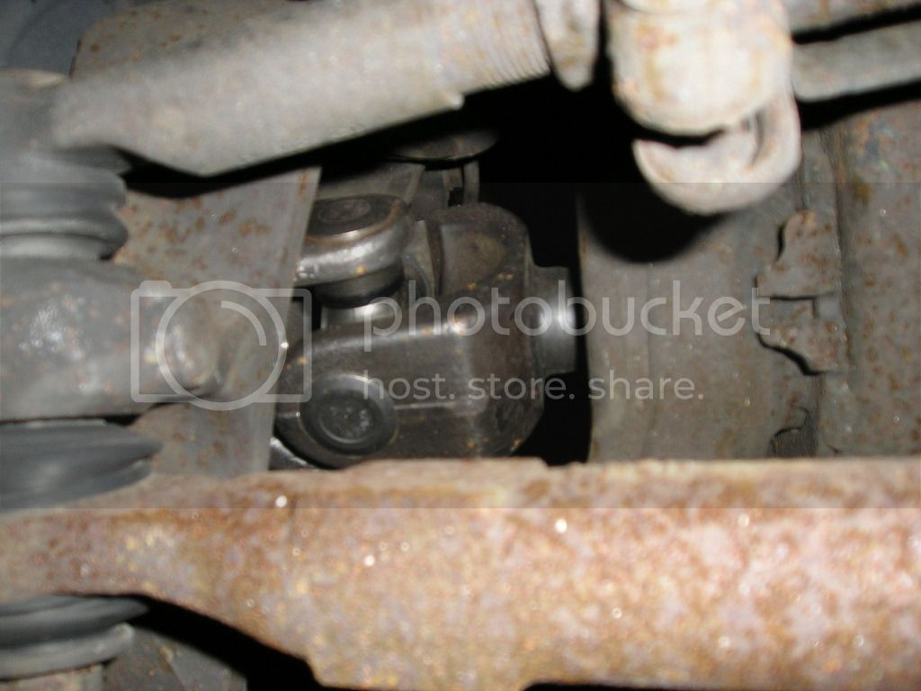

New front axle shafts with 360* snap rings.
[/URL]

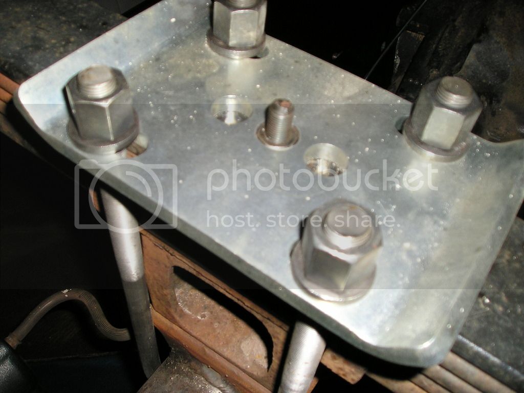

New spring plates and U bolts.
[/URL]

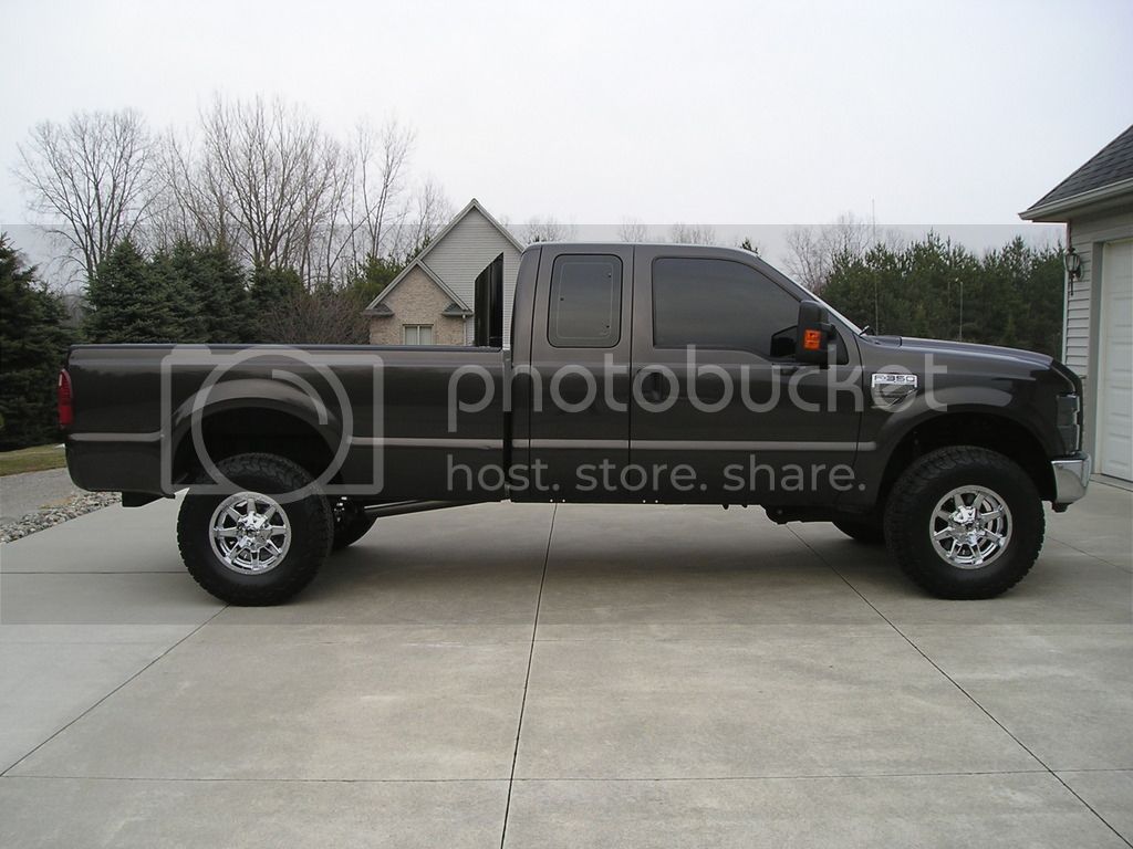

New tires and wheels. BFG AT KO2 35X12.50-17. Fuel mavericks 17x9 -12 offset. Big thanks to site sponsor Big Time Kustomz for the great price on the wheels!
[/URL]
And this is how it currently sits.
[/URL]
