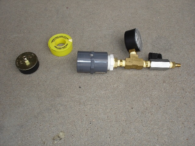

Gotcha, I'd make a detector for sure. Always a handy thing to have.
What would you use to make it? And would you put it in the intake of the turbo, or unbolt it from the turbo and out it on that pipe. I'd like to go from the turbo so its the complete system but don't know if I'm gonna hurt something.

I'm not sure if the seals on the turbo would like the static pressure, usually that turbo is moving the air, even if it's being forced in but I could be completely wrong.
I'd use a pvc pipe the size of the ID on the hotside boot, clamp it on with a cap on the other end that has a barb so you can put a hose with a T to a pressure gauge and a schrader valve.
PVC cap matching the size of the boot on the turbo compressor inlet, then tap it for a gauge and a air chuck. You shouldn't need much, 20-25 psi should do. You just want to listen for leaks and or see if it bleeds down quickly.
There are no real seals in a turbo, just a metal seal ring. Going through the intake is fine.
