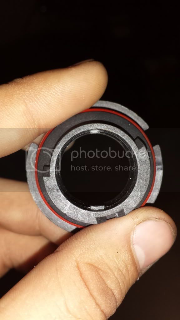

And this is to answer the same question in regards to 9007 LEDs... or at least the ones I got.
You can see that the tabs on the inside of the ring are different widths. The grooves in the bulbs match this. I cannot turn this ring 180* without filing that tab down to match the width of the other one.. I'm not willing to do that and not only ruin them, but find out that reversing the bulbs won't help at all. If both bulbs being lit up didn't produce a good high beam the first time, turning it 180* would result in the exact same high beam, just a different low beam.

So only lighting up half the housing on low beams doesn't have drastic effects on the beam pattern?
700
Austin, Tx
It actually doesn't on the older 9007 housings like my '03 housings. Those only light up the top half of the housing on low beam and the pattern was great on the road.

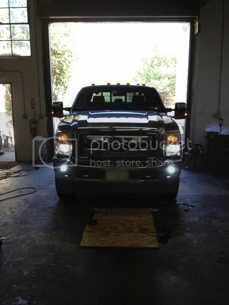

Geesh my post makes no sense.... not quite sure what my phone did there. I'm just curious how everyones luck with the beam pattern and bulb fitment in 08-10 headlight housings have been.
jimdawg185
1,869
I have an 08, and I love them!!!!!! With my Dually 2s I really light up the night...
