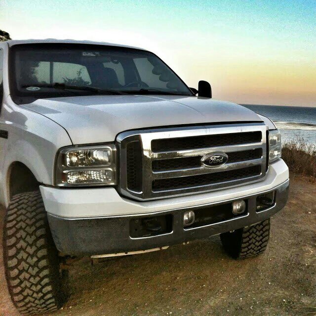

anybody have a picture handy of the 05 conversion reflectors? the concavity of the reflector on either side of the bulb is going to play a big part in how well it throws light down the road.

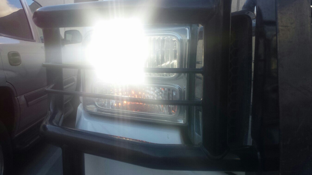

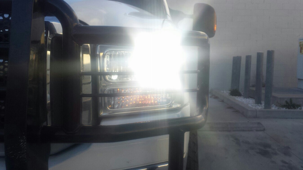

The answer to everyone's question......
On 2005-2007 headlights, yes, you can rotate the retaining ring to give you outside/outside or inside/inside LEDs as apposed to Left/Left.
I chose to put the lows on the outside because when I walked around the truck, these were the reflectors that blinded me of to the side (when both inside and outside LEDs were on.)
