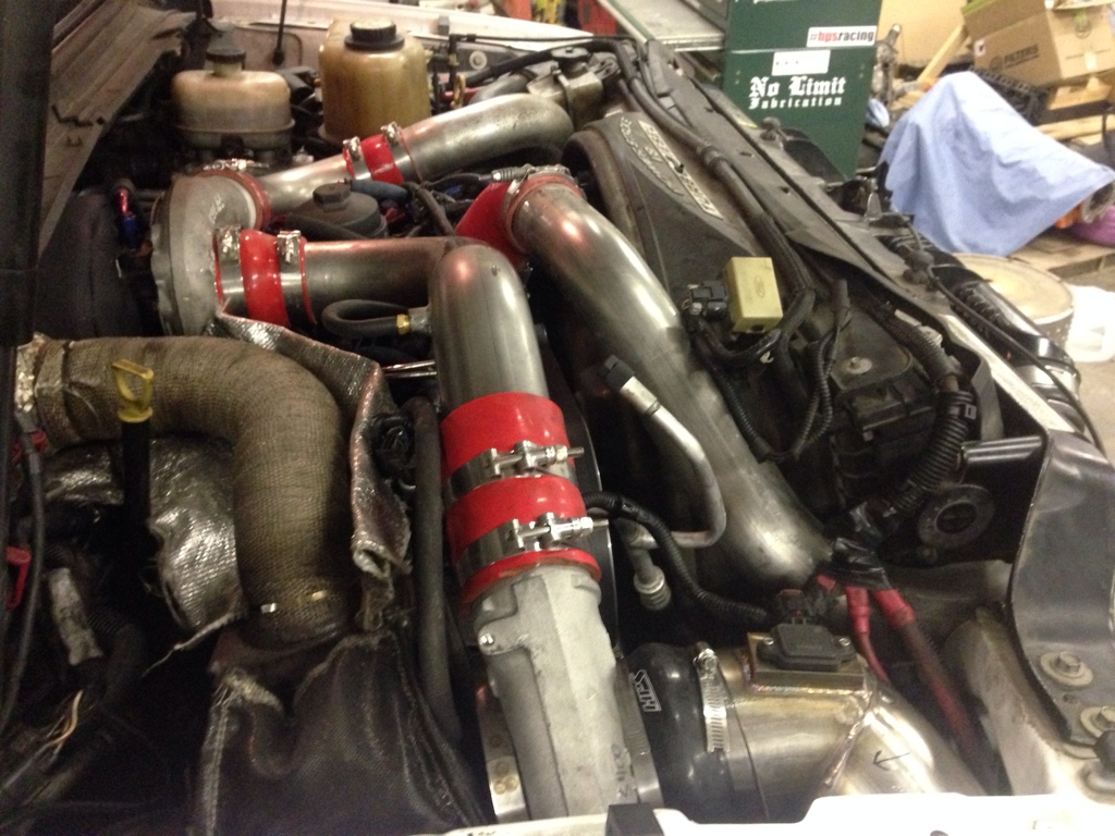

Little update, took off the turbos. And went a little larger. For those who haven't read to the beginning, we had an s360 and s480 combo.
New turbos are little more naughty....
We are now at a 63/68/.91-84/88/1.10 setup, billet, balanced 360 thrust.
They are beautiful pieces.
Only took a little under an hour to pop the old ones out.
There they are! You can see the new afe custom filter that we are using, it basically is as long as the whole front fender and skinny to fit real nice.
Here they sit all in place. Don't mind the battery cables. Lol it's still a work in progress. It doesn't get attention like a customers truck would. Always last in line.
Truck feels noticeably stronger on the street. Drivability is nearly unchanged. Although the atmo comes on sooner due to the tighter housing. Best of all it sounds wicked in the cab. The gate is set making around 85 psi total. Pulls very hard. But the poor thing is now pushing coolant. Guess we will take it easy for a while and only run it hard on the dyno. It hasn't even got the spray yet...

Why the change to the bigger chargers? Any issues back pressure or something with the 60 on there? Just asking for reference as I will be upgrading to a smaller high pressure.
madman1234509
Nov 20, 2011
2,669
mayfield, ny
It's a little laggy. Not bad and it's an awesome street truck. But it could be better looking at going to a 62-64mm with a smaller exhaust wheel. The truck Morgan posted a video of cruising recently looked to be making about 10lbs cruising. That's about where I want to be. If I'm barely on the throttle just getting up to 55mph I make Like 3-5 lbs.
