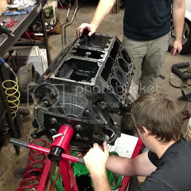

Made tons of progress today put it on the engine stand lol.

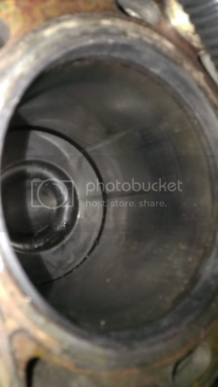

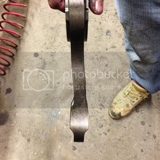

Pulled her apart tonight. Looks like the injector hung and hydro locked it and bent the rod. Piston got whacked from the bottom by the counter weight. The pin boss broke and the wrist pin came out to play.
no doubt the block is trashed. We will be buying a new block to build from.
