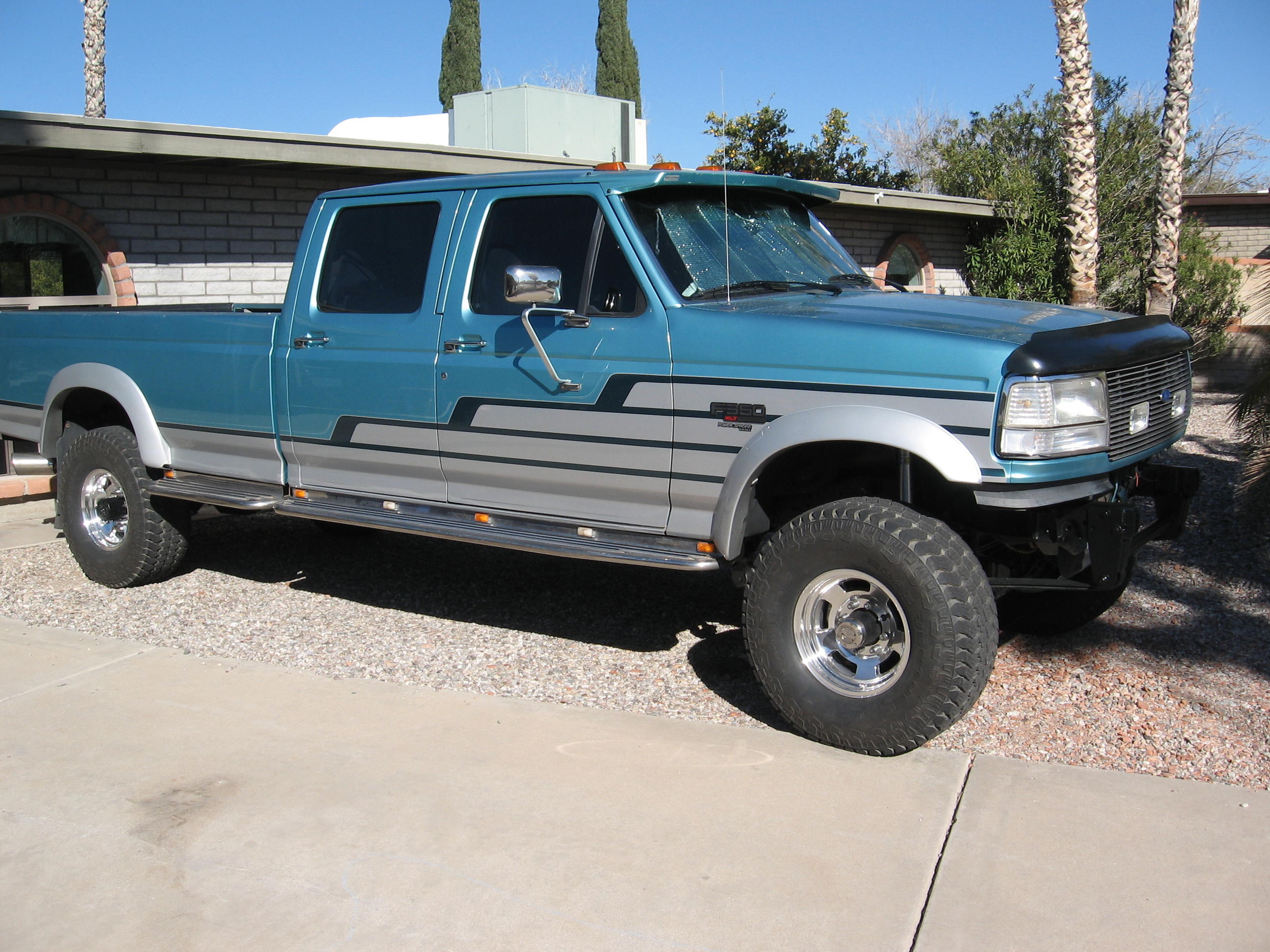

You MUST raise a truck enough to have compression travel..major flaw in the F250 as their isn't any..then add the fact the only way the axle moves is by twisting the shackle and spring bushings..destroying them in as little as 20k miles...add camber swings and the resulting tire wear...IMO its a piece of **** design that Ford finally saw fit to stop making.
TTB is great modded for a off road truck that doesn't care about these issues and the Camber radical changes that occur.
94TurboDiesel
Sep 5, 2012
28
Wisconsin
