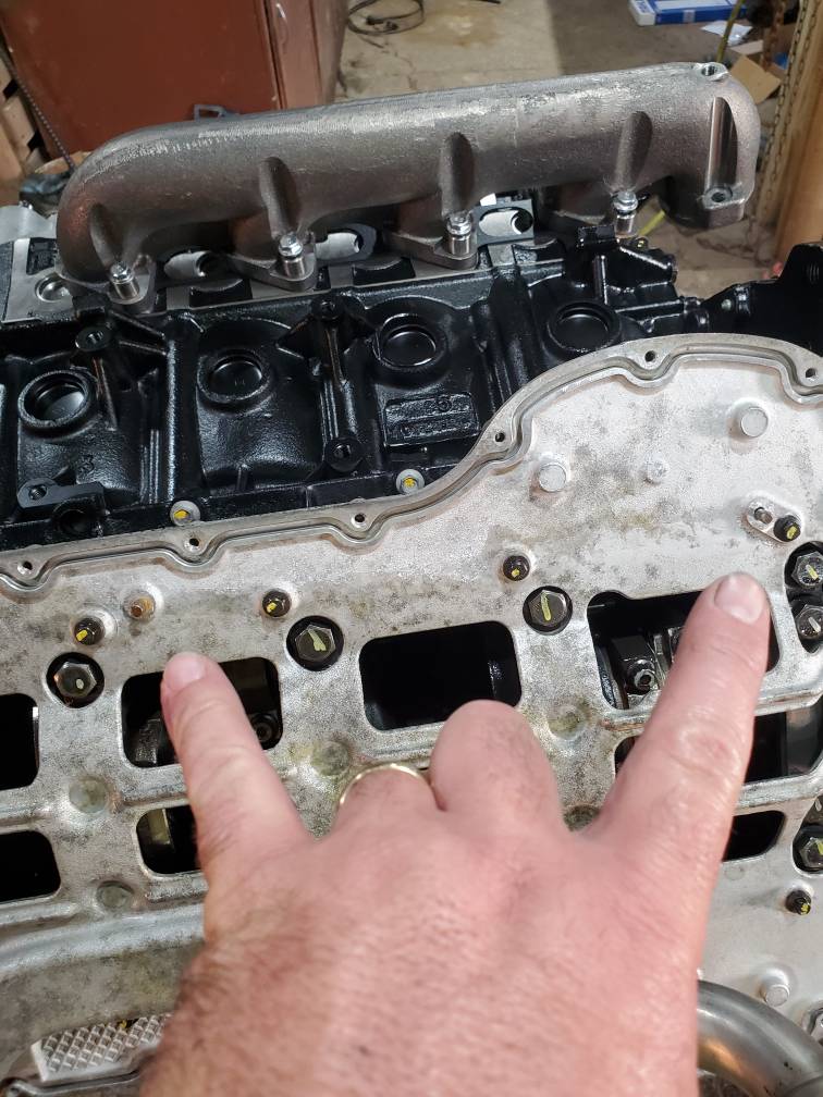

Was prepping for the oil pan, and noticed these 2 alignment dowels. I dont remember removing anything from these. We're these for factory machining, or have I lost my mind and misplaced something that goes there?
Sent from my SM-G970U using Tapatalk
Sep 9, 2015
3,602
165
Mesa, AZ
Was prepping for the oil pan, and noticed these 2 alignment dowels. I dont remember removing anything from these. We're these for factory machining, or have I lost my mind and misplaced something that goes there? View attachment 187601
Nothing goes there, you’re good.

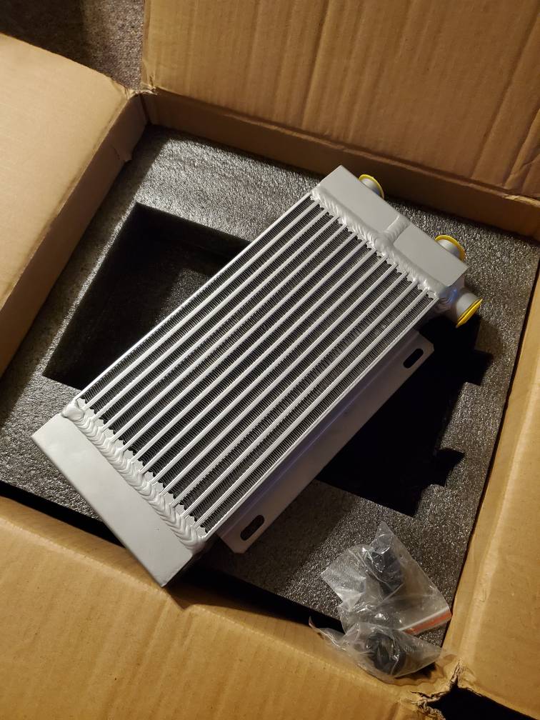

That bpd remote cooler?
Fluidyne cooler.

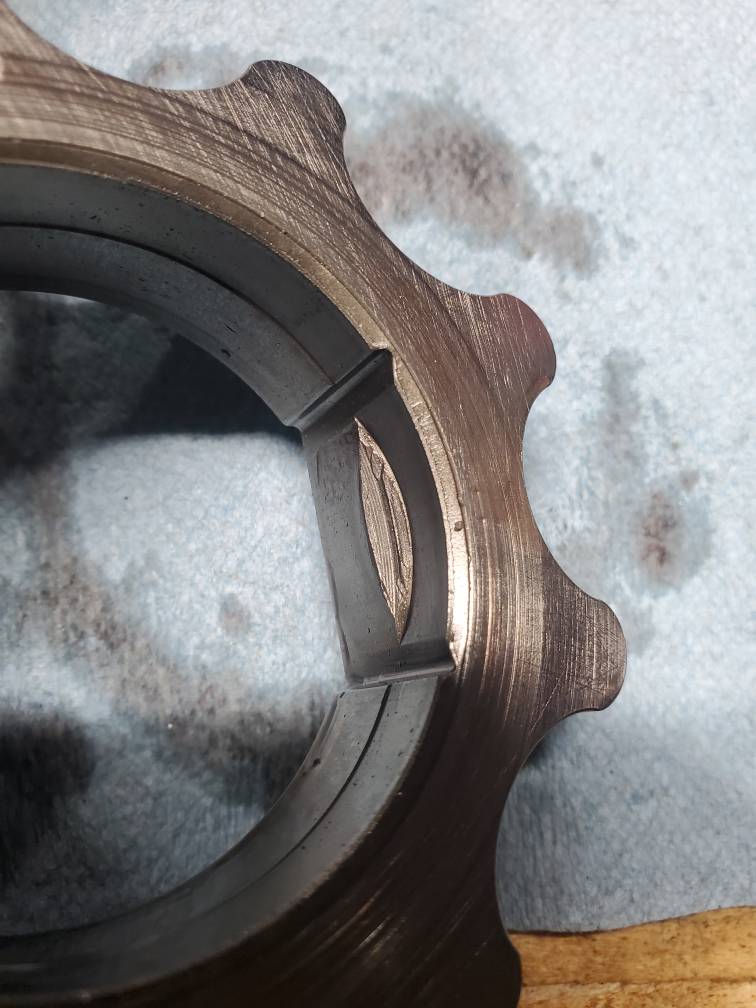

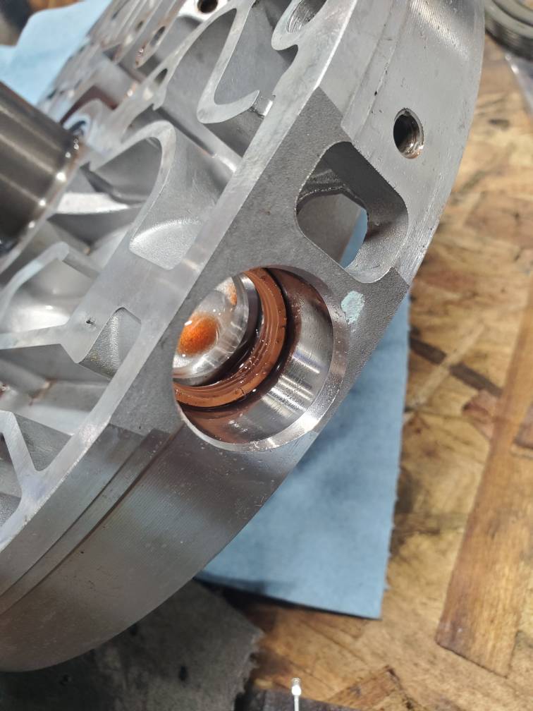

Learned some lessons on installing this engine. I never pulled the converter after I removed the engine, but apparently the converter got disengaged from the transmission pump gears. When I went to mate the engine to trans I thought things went together ok, alas no. When I got them mated I tried to turn the engine over and it no go, so atleast I didn't get too far along.
I figured since I never pulled the converter it would still be mated properly....nope. I must have pulled it out just a bit to disengage the pump. Anyway, I got new gears and some seals for the front. Had to drain the trans and pull the filter to remove the front portion of the trans. I think the trans filter seal is stuck in the pump housing(see pic). It's the reddish ribbed seal that I thought normally gets replace when dropping the filter. It seems really stuck in there. I already poked it with a pick, so now I feel I have to remove and replace it. What's the deal with this seal?
Also threw in pic of smushed pump gear.
Live and learn.
Live and learn.View attachment 187663View attachment 187664
Use a 1/2in drive extension. The edges are rounded so you won’t **** up the pump housing. Stick it in the pump, and get the tip of the extension on the filter seal, then basically pry it out. Should pop out fairly easy. You’ll be using the bottom of the pump as your pivot point.
