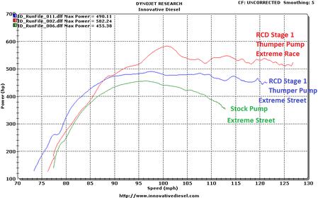

Ok, Eric sent this over this afternoon. He called me last Friday excited and filled me in.
Customers truck was running 225/100 inj and a Powermax.
He brought the truck in for live tuning and it would not hold inj pressure. (3200 psi) Eric sent him home with the pump, he came back a week later and this is what happened.
Eric loaded the Extreme Street back on the truck. The previous trip would only net 455RWHP. After swapping the pump, injection pressure jumped 800 PSI to 4k and netted 490RWHP.
Eric then loaded the race file back into the truck (Red Graph). He said it held solid Inj Pressure but would not build any boost as it was over fueling the turbo.
Eric will chime in early next week as he is taking a quick vacation. Must be nice...

I think the important thing to note is how much better the power carries out up top
Nice work guys thats bad arse
Thank you buddy means a lot!
Awesome that a truck with 225's and a Powermax is making 580+ at the rear wheels.
We need one of our Billet 68mm & 225/100 + Modded Hpop to see High 600's. Bet it would be a blast
