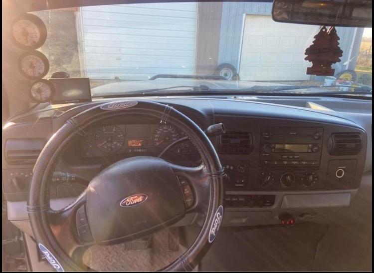

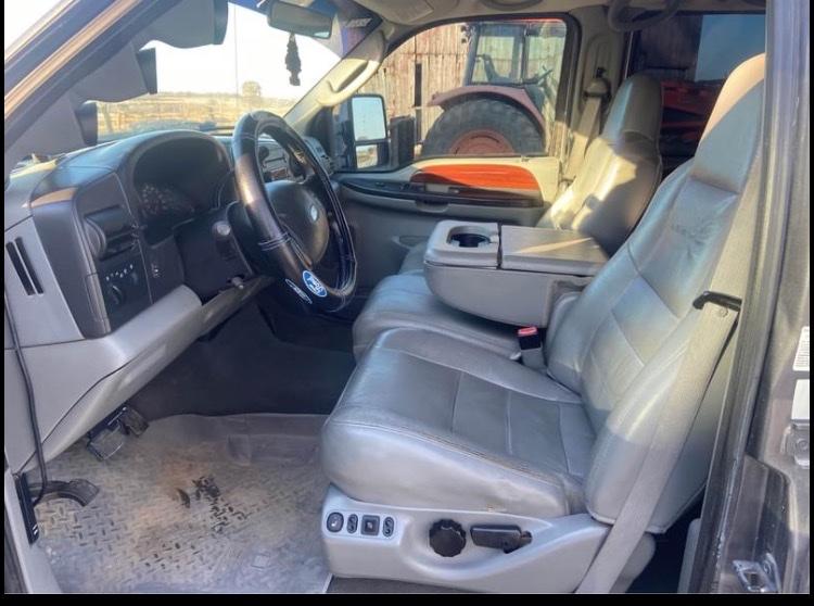

Looking at an 05 6.0 for sale. The guy listed it as a Lariat. It appeared to be fully optioned (minus sunroof) with heated leather, adjustable pedals, power slider, backup sensors, etc. HOWEVER... it has an XLT instrument cluster, steering wheel, and dash bezel. Turn nob hvac controls. I have personally never seen a Lariat without the white gauges, dual climate control and steering wheel controls. Was this a rare lariat option? Or is this just a fully optioned XLT?
Vin is: 1ftww33p55ea21004
I haven’t ran a history on it yet. Just perplexed and wondering before I drive to look at it.

Back of the seats should say lariat and appear they do but it would not have been a lariat without having eatc. Even the heater boxes are different for eatc to accept their blower motor resistor.
Wiring harnesses in the truck are also different for the lariat. It’s not only a dash and cluster swap.
Also there should be a storage tray in the roof between sun visors for a lariat and the visors both should be lighted.

Yeah I knew that the boxes and harnesses were different, but wasn’t sure how. From his pictures I cannot see the overhead console/cubby.
My guess is it’s an XLT that someone swapped lariat door panels and seats into.
Going to get ahold of a contact I have at the local Ford shop when I get back to town this evening and see if he can pull the build sheet for me to find out for sure.

Got the build sheet emailed to me a little bit ago. It is a lariat trim built with manual climate controls. It is a job1 2005 model. Build sheet lists all of the options I see in the pictures.
Looks legitimate, and factory. I never would’ve guessed it without seeing that build sheet.
