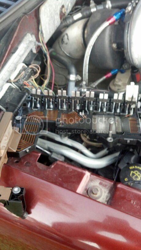

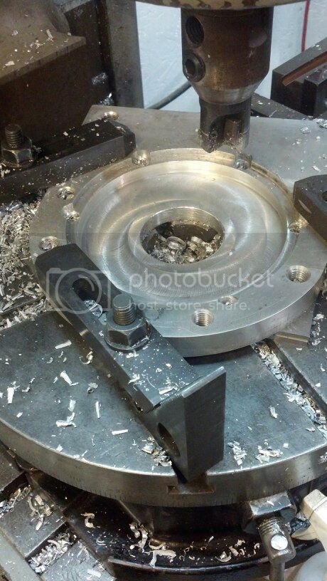

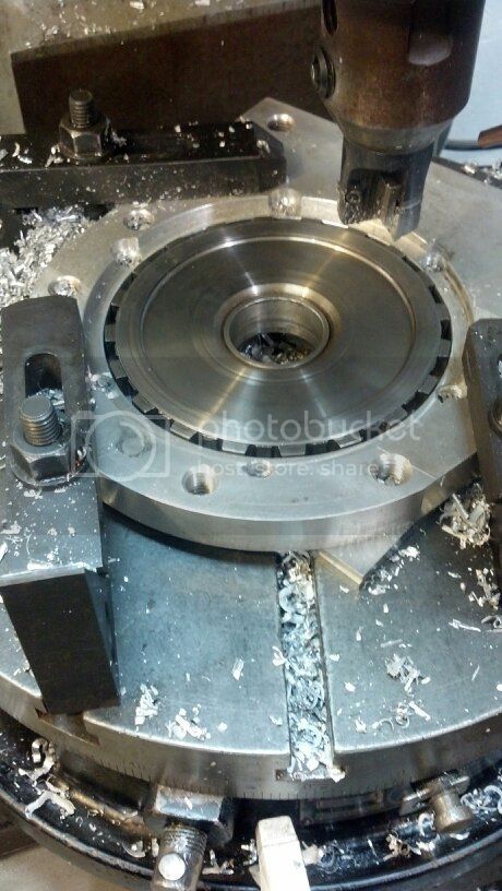

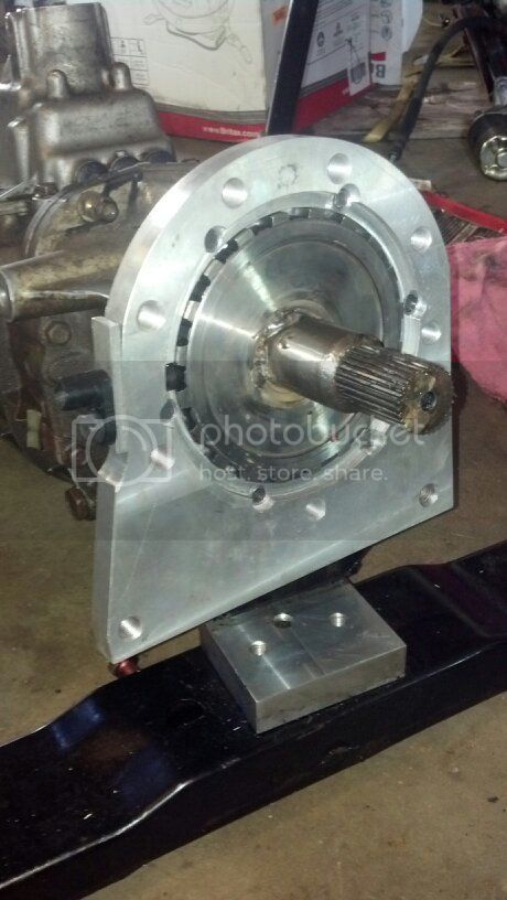

I'm now working on the speedometer pretty actively. I've had intermittent success. I believe my method is good I just need to improve some parts of the system. I'm utilizing the original 6r75 tcm. This module has a hard wired in vss that points off the tone wheel on the trans output shaft. I aquired an original output shaft that I machined down to fit my needs. I could have started from scratch on the tone wheel but I was trying to save time. This shaft has a lot of case hardening done to it to resist wear so that took more time in the machining process to get our where I wanted it. I now have a speedometer that works occassionslly. When it works it works good, but when it doesn't your out of luck. I think it may be a bad ground or I need better shielded wire for transmitting the signal. I'll getter whooped!!
there's the modified tcm
here's the trans to transfer case adapter I previously machined to put the tone wheel in
tight fit
here it is mounted. I'm no welder, I'll work on that. Notice the sensor mounted on the side. This is just a cam position sensor. It reads just fine.ill be installing better wire tomorrow.
ja_cain
Aug 10, 2013
4,597
Awesome work on the adapter Shannon! If only you had the monarch setup when you were fooling with the shaft, you could have cleaned up the welds a little bit. :poke: Based on how well you have done with the machining stuff, I'm sure you will be welding like a pro with a little bit of practice. I sure hope you are able to get everything figured out soon. If you think it would be helpful, I could ship you my o-scope. It has been helpful very helpful in figuring out my interference issues with the vfd setups I have put together at work.

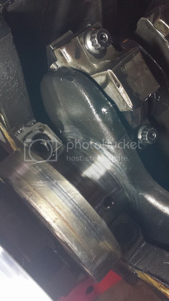

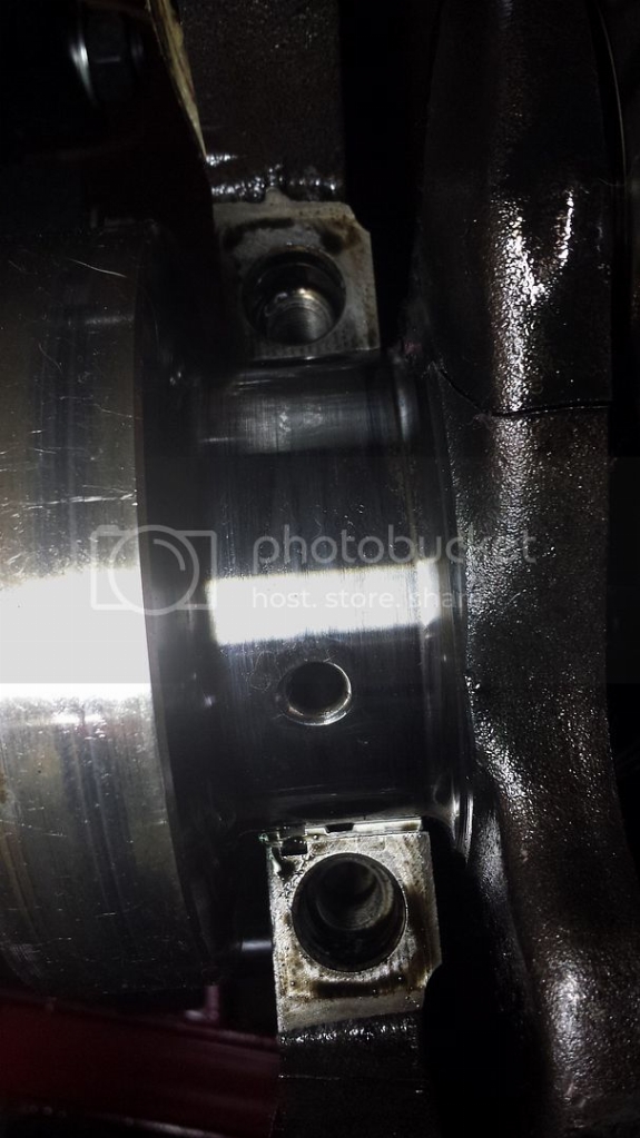

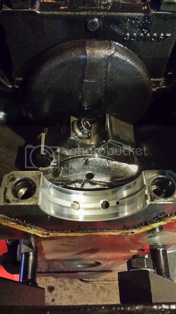

Well things went south in a hurry. All was just fine and then boom!!.....literally. The wife was driving it home the other day and didn't make it. Evident real quick something was really wrong. She was just cruising 55mph down the highway and it started making bad noises. She quickly pulled over and shut it down. I restarted it for about 5 seconds and shut it down. Almost cried. Finally found this.
only thing can think of is it fatigued. Bearings don't show lack of oil. Anyone have any ideas or is this just freak thing.?
needen$77
Aug 7, 2013
322
I had seen on another site this happened to a 6bt and he just replaced the crank and a few rods. He seemed very knowledgeable and he is still pounding on it
