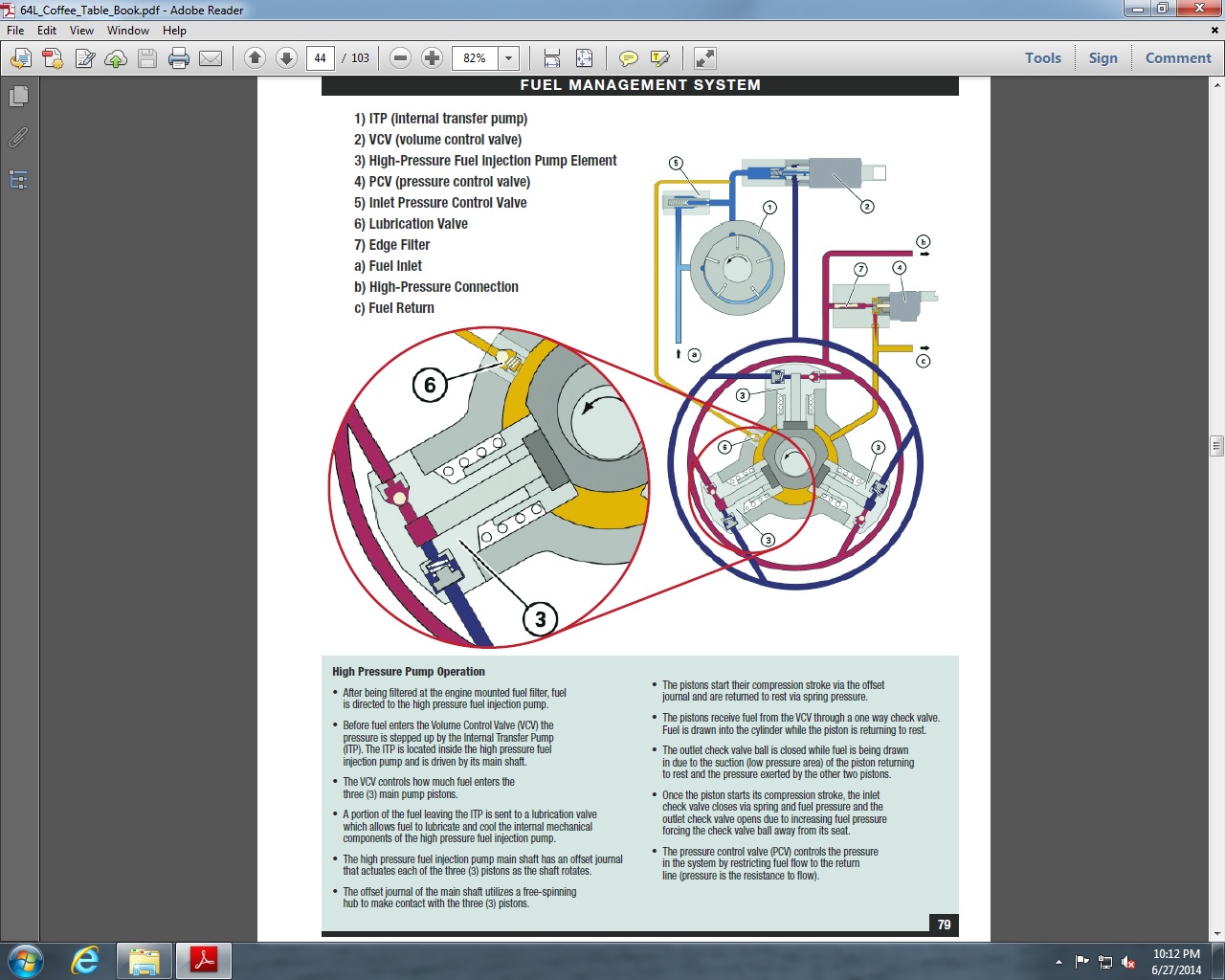

B585Ford;1023379Does anybody know how fuel can go through the lubrication line within the pump?[/QUOTE said:
Not sure if this is what your looking for, or if it helps, the drawing shows the lubrication fuel in yellow.
There has been some discussion in other threads on supplied fuel pressure to the HPFP. IF the factory set up supplies approx 3-3.5 psi via the regulator in the secondary fuel bowl, Under what conditions would I require a supply to the inlet of the HPFP as high as 20 psi?? .Just trying to get my head around this:hammer:
Thanks. That is a better drawing than I was using.
I have no idea why you would need 20....well, when my HPFP was bad, it took 20 PSI to get it to run. Most people have said that by 15 PSI you start getting a surge (on a healthy HPFP).
