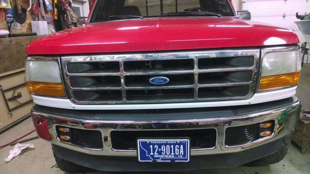

Here's my 97 7.3 with 6.4 bumper
Sent from my XT1080 using Tapatalk

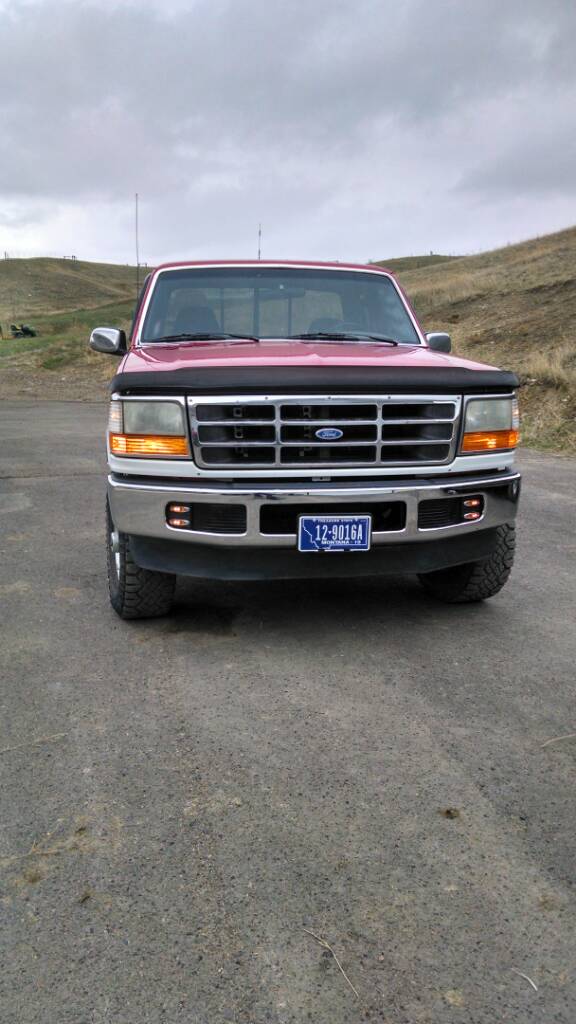

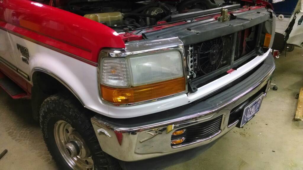

Seven.Three 81 did this
Used my brackets off old bumper an the brackets on the 6.4 one . had to take side brackets off the 6.4 for wheel space. Used 2 inch spacers an bolted it to stock frame mounts
so could save money and time on new brackets

Touchups

Any pics of the brackets you made?
