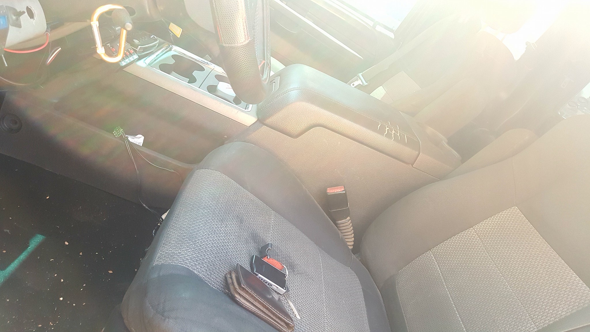

i have a 6.7 in my 02, getting ready to swap 08 dash too. i run dual captains chairs with the arm rest, all you do is just flip them up. ive tried both the 08 and the full flow through. There is a small gap but its not a eye sore. 08 console is hands down way better then 99-07 but they get pricey and are hard to get sold by themselves

ill take some pictures later on and post them for ya, there is a small gap but honestly i dont think it would but most people, the benefits of the console are WAY better. you can't have manual 4x4 also, has to be esof.

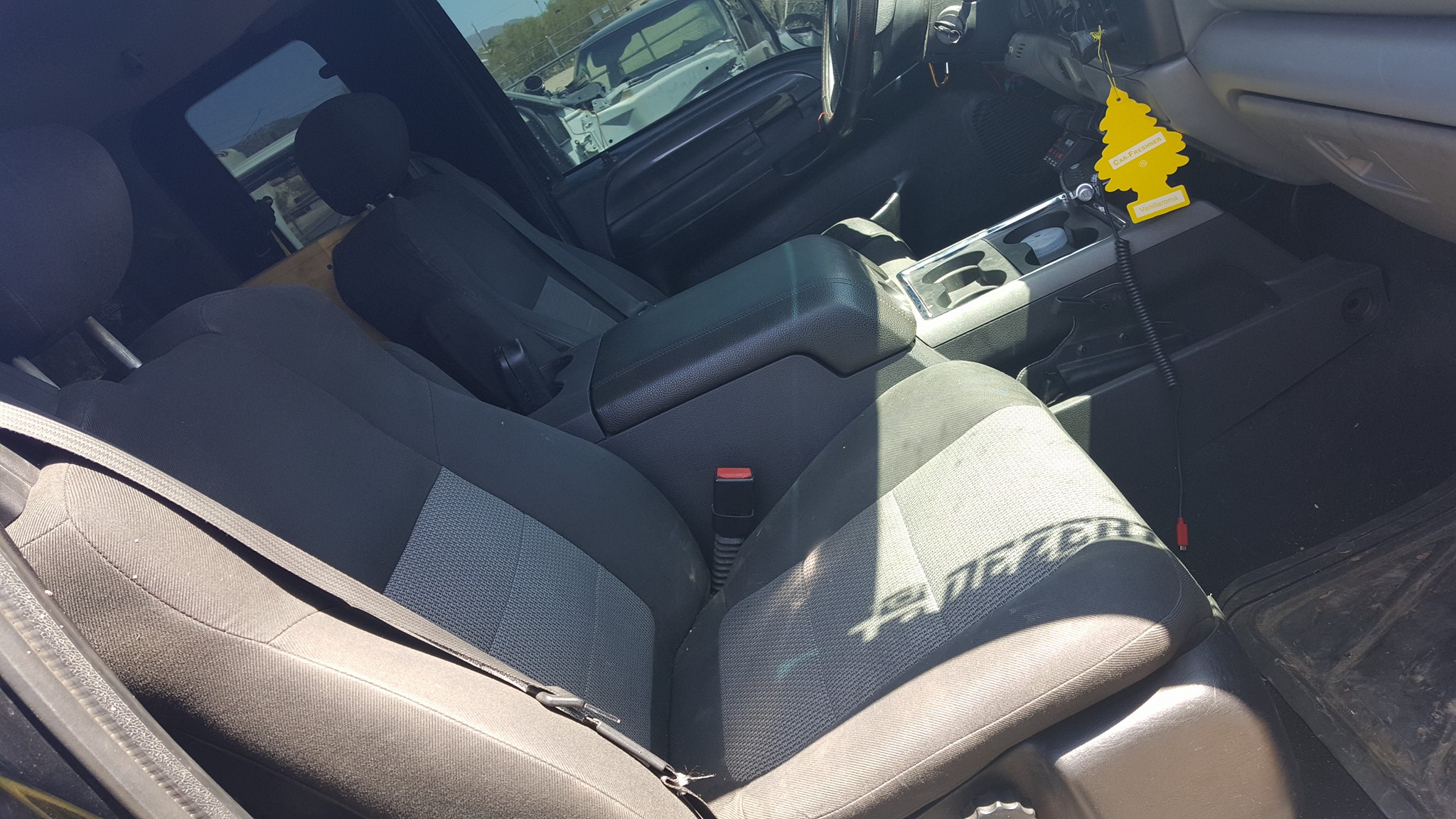

yeah im 99% sure it does and im pretty sure i knew someone that did put it in but his problem was that he had a manual tcase, hence why i said esof. It only goes like two inches further where the seats go back at the farthest position.

oh that's not bad, I think it looks better because it has a larger gap....I think if it was close but still had a gap it wouldn't look right, but that honestly doesn't look to bad.....how was the install? And does it sit high enough to work as an arm rest? also does it just sit there, or was there a way to bolt it in? I thought I wanted an 08 console, but that might be the way to go......

works way better then the armrest, its about 4 inches taller then where the seat arm rest lay. Its a lot more comfortable, not sure how to explain it.. install was simple, drop it between the two and put the seat bolts in. 30 mins tops
