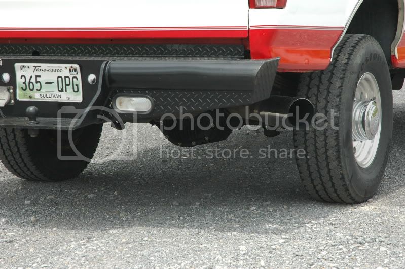

i would paint it before install. the bare alum doesnt stay pretty too long
i painted mine flat black
