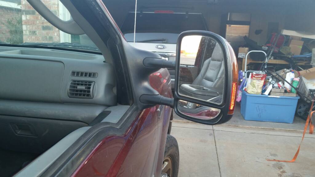

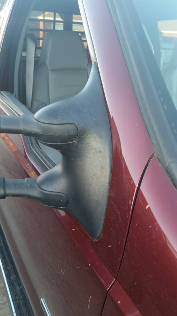

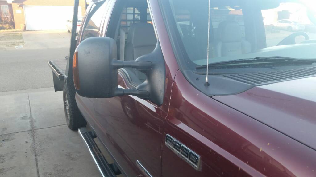

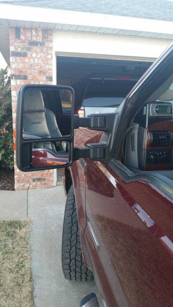

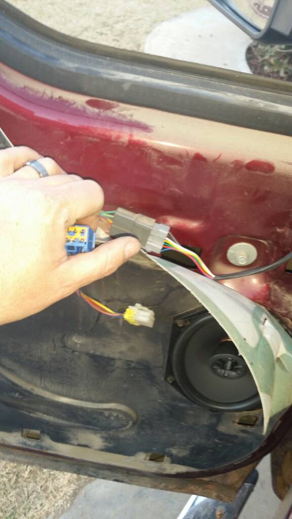

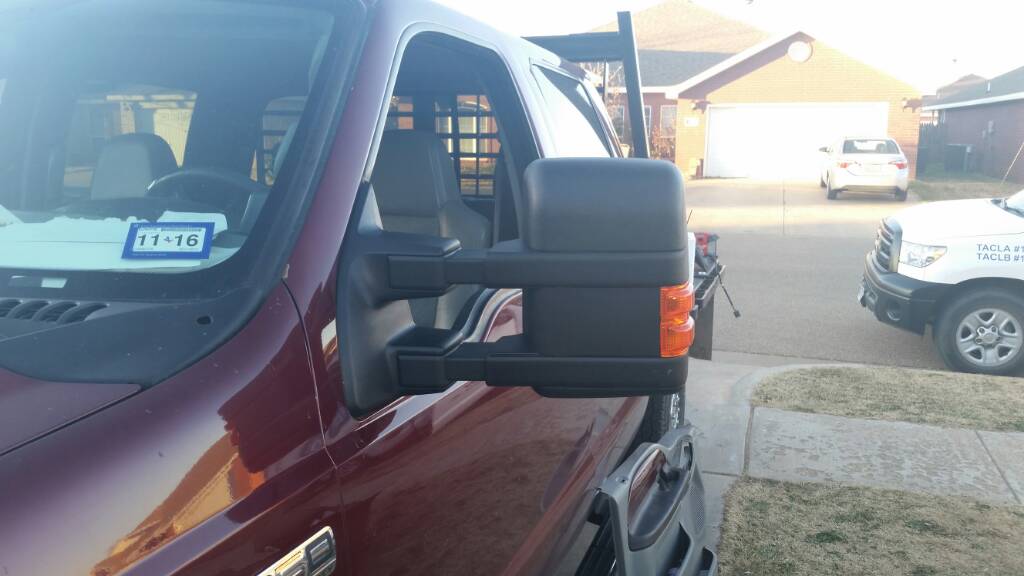

Install and removal of the mirrors is simple and well covered. Ill skip that part. I will say though if your by yourself do your self a favor and roll down both Windows before you start. Once you unplug either side on the power windows you cannot roll down the windows. Also fishing the wiring is fairly simple windows up or down but if they are down you can hold and position the mirror easier. I installed the mirrors and plugged them in and they function properly according to the power controls. So far everything works lights signals etc. I have no real way to check the heat but am under the assumption it works as well. Overall they look pretty good and fit pretty well. I looked them over in hand and didnt see anything out of the ordinary but after install i did notice the passenger large mirror does have a tiny bit of distortion not alot but i could see it. Not a deal breaker to me as based on the purchase price i could replace the glass and be ahead if i needed to. The best way i could describe the distortion is like if you didnt get a carlite glass windsheild and used the cheap windshields you can see some wavyness. Its there not a big deal though it dosent inhibit function or looks and is not glaringly obvious.
