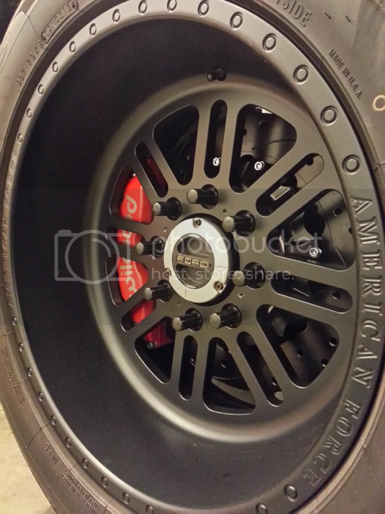

Charging issue was caused by a bad and undersized breaker, 500 amp isolator goes in on Tuesday. Highly recommend these brakes, they are amazing and should be on the build list for anyone adding big power.
