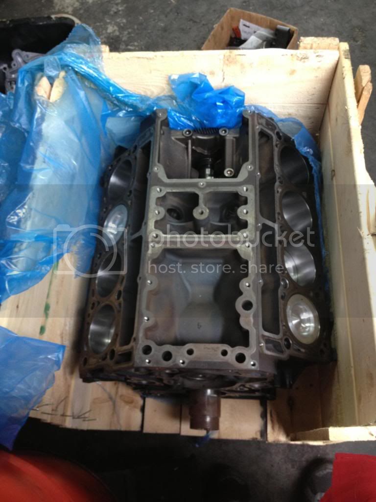

Well things are moving forward with the build bit by bit, motor is back from the machine shop and should be getting assembled this week hopefully. The roll bar should also be done this week as well with any luck, the only thing that is holding us back is the trans, been waiting for BTS to get these new aermet-100 shafts made. last Buddy heard Brian was testing a prototype in his truck so hopefully things go well and the tranny gets finished this month.

Those are some shiny pistons in there. Mind my asking why the block wasn't zero decked?
I've never seen a 6.4 that didn't have the pistons protruding past zero deck. My guess it that its not all the way at tdc. 0.030" is pretty common outta the hole measurement with HD pistons and a standard deck. Most of the time when we mill the blocks we mill the pistons to match.
Not to nit pick but it does look like the end of the crank is rusty. Or is that just some packing grease?

I just meant resurface the deck of the block. With being that far in, even if the block is within spec, (it usually is) it's a better seal. Obviously the pistons need an equal amount cut for clearance though. Just curious. Not worth any more derail from the build.
