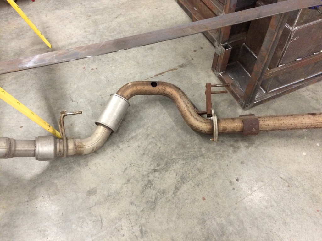

I have been changing everything over from my 11 to 15. Went to put the DPF back exhaust on and noticed there was an additional sensor just before the resonator.
Does anyone know the size of the sensor? I want to get a bung and weld it in my magnaflow exhaust.

The sensor I am referring to appears to be a nox sensor or something. Looking on ford parts the sensor is not shown on any of the exhaust assembly drawings I found. Sensor is directly above the rear axel in the U bend.

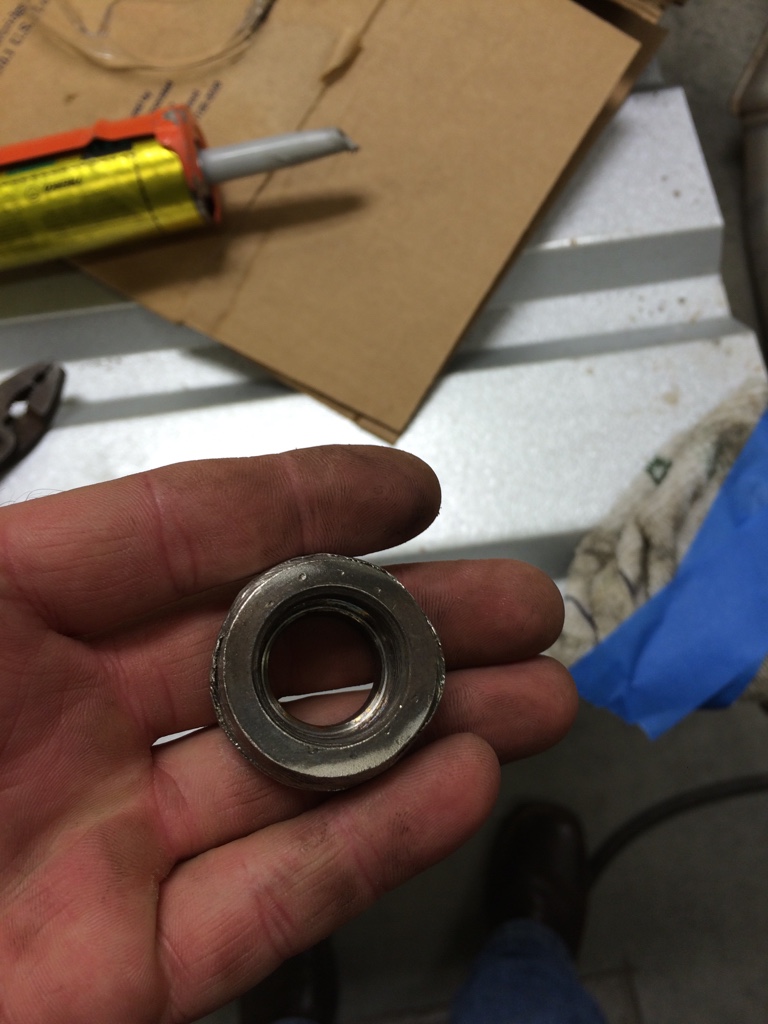

Here it is cut out of the factory exhaust.
After talking with magna flow they told me the bung size is M22x1.5. After searching and having someone weld in the incorrect bung I just cut it out of the factory exhaust and welded it into the aftermarket pipe.
M22x1.5
