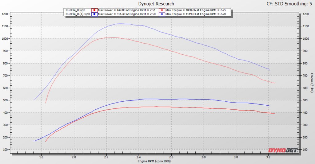

Here is a dyno graph comparing the BASB vs 364.5/73/.91 . Both with 205/30. You can see the s364.5 comes on sooner, makes more peak tq, makes a TON more hp, and has more power under the curve in every area. I can also tell you that towing/daily driving results were the same as the dyno. Towed cooler, cooler at WOT, more power, less smoke etc...
I think the BASB was good back in its day before the new SXE turbos came out... but it is now outdated.
