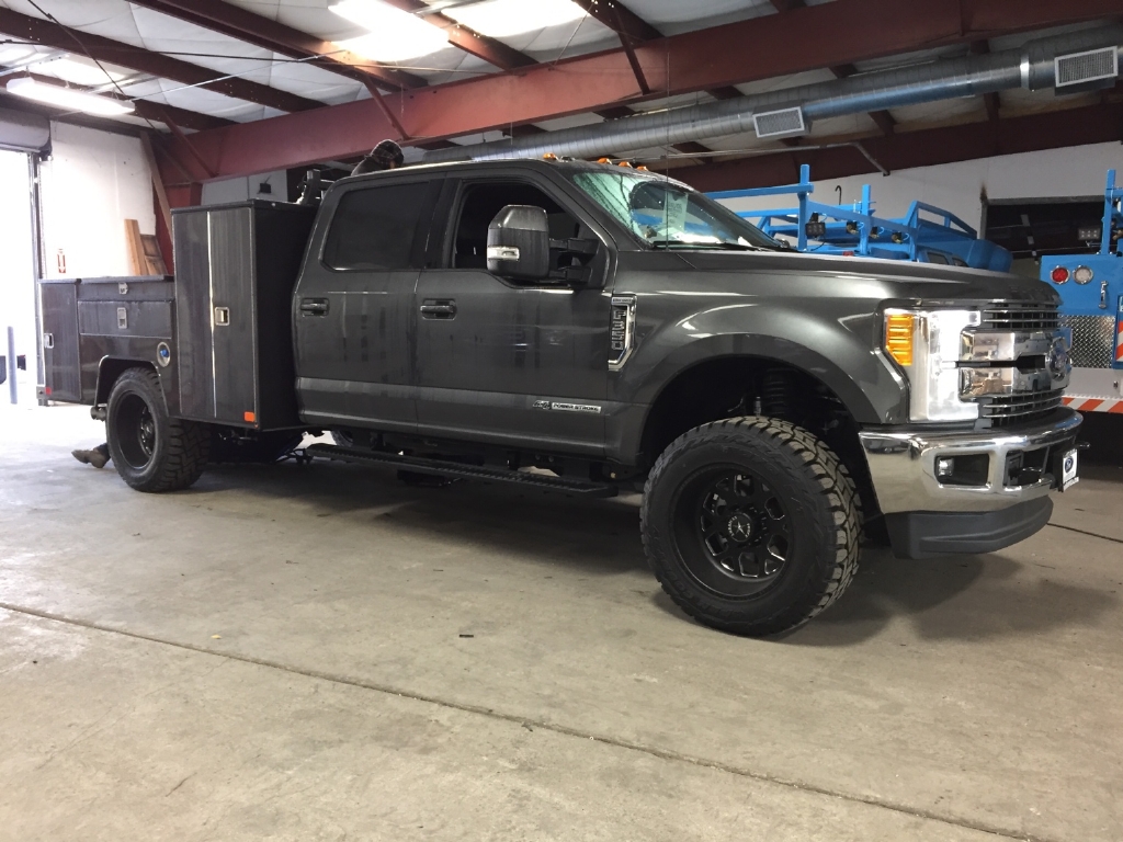

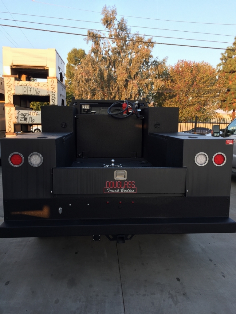

Another step closer! Finally got it back from having the bed done...now just needs some tint and need to figure out what to do with the chrome on the front

To answer the question on the frame being thicker on the C&C trucks, yes they are quite a bit thicker!!! And in some cases they have channel stacked in some sections, but that may just be on the F550 frames....
Oh, nice looking 2017 BTW!!! That right there is a working man's truck!!! A truck that's going to pay for it's self!!!!

That is a very nice work truck. I completely understand the decision to go cab and chassis. May I ask what a bed like that runs? I got a quote from a builder here in so cal and it was extremely expensive IMO.

That's a sweet setup and a lot of weight. The gooseneck in the bed and those wheels look a little concerning. Looks like you had the bed built to your specs.
The guys with the C&C question its pretty simple. Industry standard for upfitting the trucks. The frames don't have the hike behind the cab and are narrower than the pickup trucks (VIN starts with 1FD on C&C). The frames on pickup trucks (1FT) are wider and you loose compartment space in the boxes since they have to make clearance for the leaf spring hangers. You loose a lot of space with the newer pickup trucks that are outfitted.

I had it made by Douglas out of Bakersfield. Ran about $22k...i put pull out drawers of various depths in all 4 corner boxes which added quite a bit to the price

looks good! how is that legal without mudflaps?
LOL. Mudflaps....
That's funny. RARELY do single wheel trucks in the south have mudflaps. Where is this truck located at anyways?
Cool rig for sure. I do hate that it's so derated. By 110hp to be exact...

$22,000 bed holy sh!t!! Definitely a sweet looking work truck. May ask what work this truck is going to be used for?
