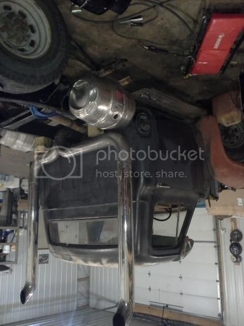

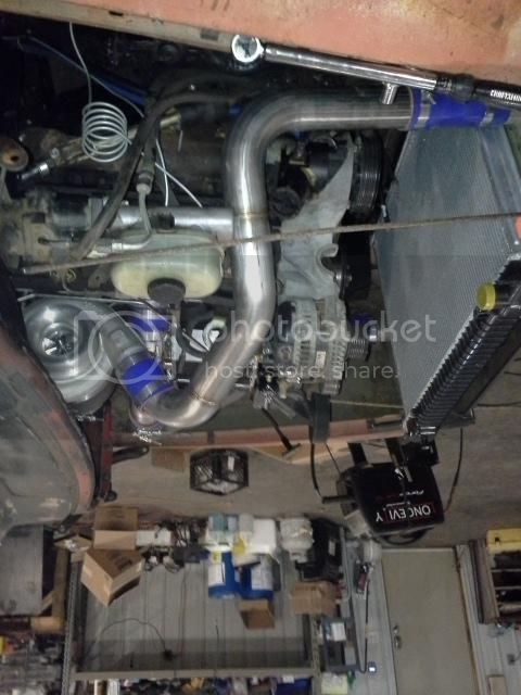

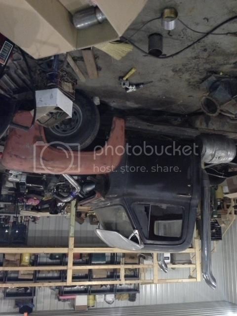

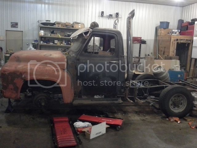

FINALLY got to work on it a bit tonight. Got the running boards on mocked up the tanks and got the exhaust all done except some clamps and hangers. Also mounted the intercooler and piping, and set the new radiator in

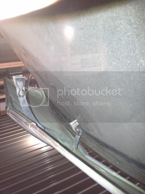

Also I'm kind of stumped on my visor, its made for a truck with a split windshield and the center braces just clamp onto the divider. obviously i dont have one of those so im thinking i might be able to turn them 90* and maybe get them to clamp on the drip rail on top of the windshield. Anyone have other ideas? heres a pic

Are those kegs for the fuel tanks? And that is coming together NICE!!! And that s468 looks awesome!!

Yeah they're old stainless kegs, the kind that had wooden plugs in the side. 15gals each
Very nice touch. Makes me want to build one. The custom work is awesome but running a 7.3 with the turbo and injector combination. That things going to be even more of a :jawdrop:

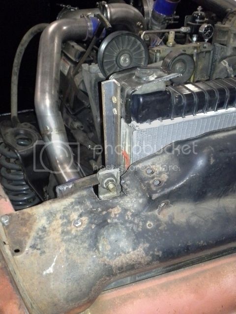

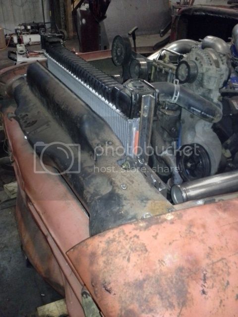

Finally got some time to work on it tonight. Mostly just got the core support mocked up. It isnt pretty but itll be plenty solid once its fully welded.
We made one bracket for each side to support the front clip, intercooler, and hold the top of the radiator. Not my prettiest work, but its functional. needs to wait until everythings in place and then ill take the clip off and weld it nicer and brace it a little more
It's set up to be able to slide the radiator out easily if needed. if more serious work is called for its only 2 bolts there and 6 more towards the rear and the whole front clip comes off and shes pretty much naked.:thumbsup:
Currently sits like this:
