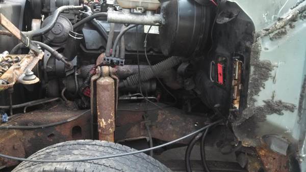

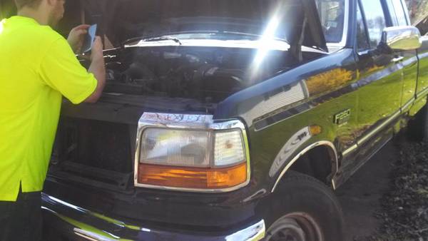

Lots of crustiness, but I ain't complaining. $800 makes me smile.

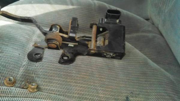

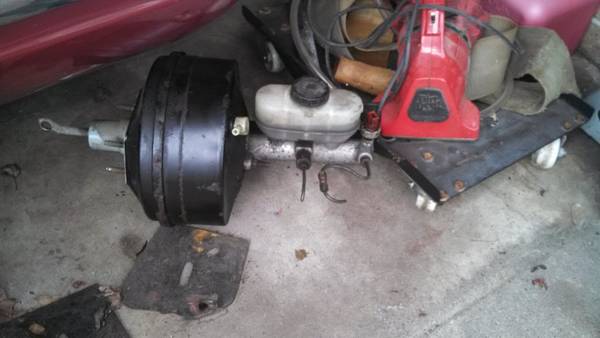

Going to need that....
Maybe that too...
IDK, I have been told a '99 and up SD would be the better brake upgrade. I will hang onto this just in case...

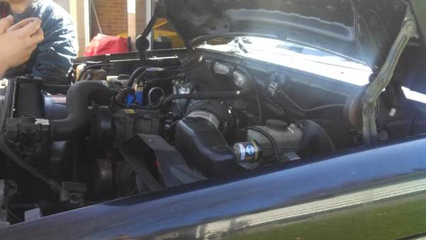

Reference pictures

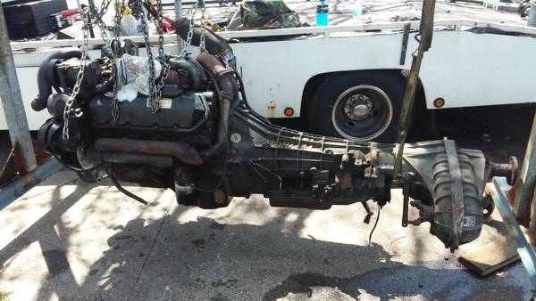

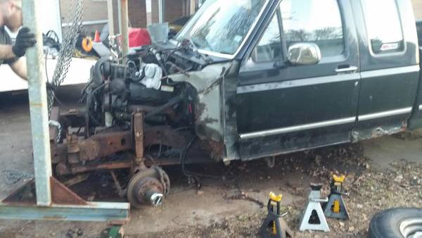

My home made gantry isn't tall enough to clear the frame!
Had to remove the tires and drop the donor down to clear the frame perch

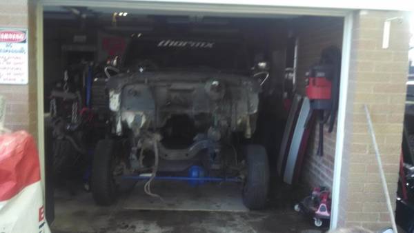

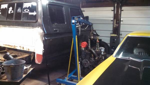

Winter is fast approaching. The township I live is displeased with my hillbilly ways. So I needed to hurry and get the driveline tucked away and unfortunately needed to hurry up and be rid of what was left of the donor.
This was easier than I thought, until I met the 1/2 lip of concrete from my driveway to my garage.
Had to let the air out of Eleanor's rollers to barely squeeze in the garage. That was not a fun job of pushing...
This was a close fit to make it all happen. But at least the township will be happy.
Not much clearance on the backside, but its only for the winter....

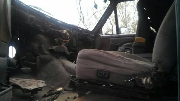

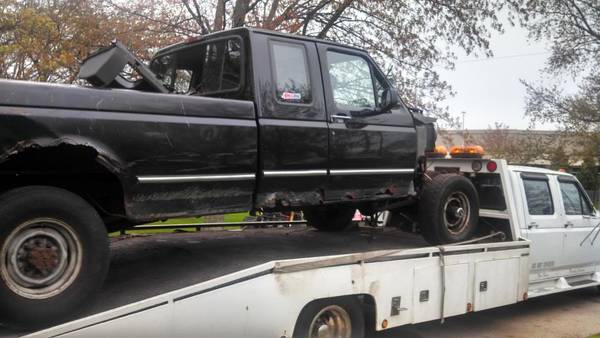

In my haste to not get fined by the township, I rushed to scavenge what I could to at least make the PS run in my truck.
So I grabbed the Sawzall, some screw drivers, and procured the wiring harness, steering wheel, connectors...
Loaded the truck and away to the junkyard we went...
What sucked was a multitude of expensive things I had but didn't know to grab at the time. Let alone the multitude of reference points I now do not have... such as:
Gas tanks with lines, including the oh so ridiculously priced sending units, axles (could have sold for money to offset cost of build), the dash itself so I would then also know where every connection went and what it was for, dual tank switch, etc.
But anyway, it is what it is.
:fustrate:

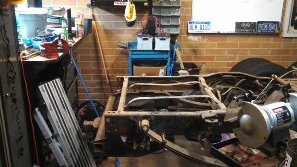

so here we are. Just me and my Eleanor.
My "crew chief" Willard and I have had the winter to think, plan, drink, and think some more.
After much deliberation, and beer, we determined we do not have the fabrication skills to customize/fabricate strong enough motor mounts to hold the PS's girth, and more importantly, to fit properly.
Called around. Talked to some fellow trail riders/mud eaters. They all concluded one guy would love the job and and will do it beyond my expectations.
Call me a sell out...but I concurred to use my check book as a tool on this part (motor mocked in place, motor mounts built).
In the end, I am beyond excited at his craftsmanship. (But that is a story for a later part of this build).

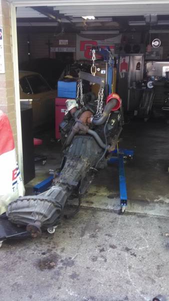

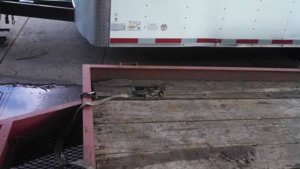

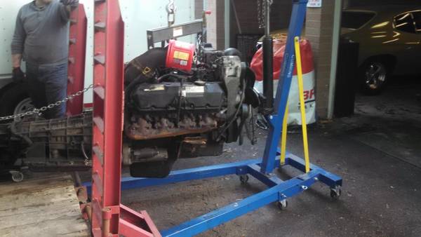

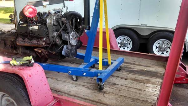

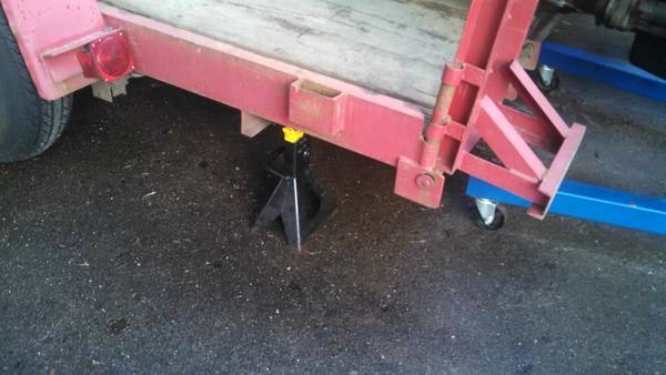

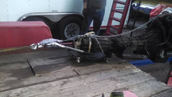

Getting Eleanor and all her lady bits to the fabricator...
1. Get the drive train on a trailer.... by using a ratchet strap, and engine hoist, and jack stands...
2. Use struggling at capacity engine hoist to try and get high enough to clear trailer...
3. Once cleared, use jack stands to raise clearance of engine hoist's legs under the trailer...
4. Secure load, remove engine hoist...and head out.
