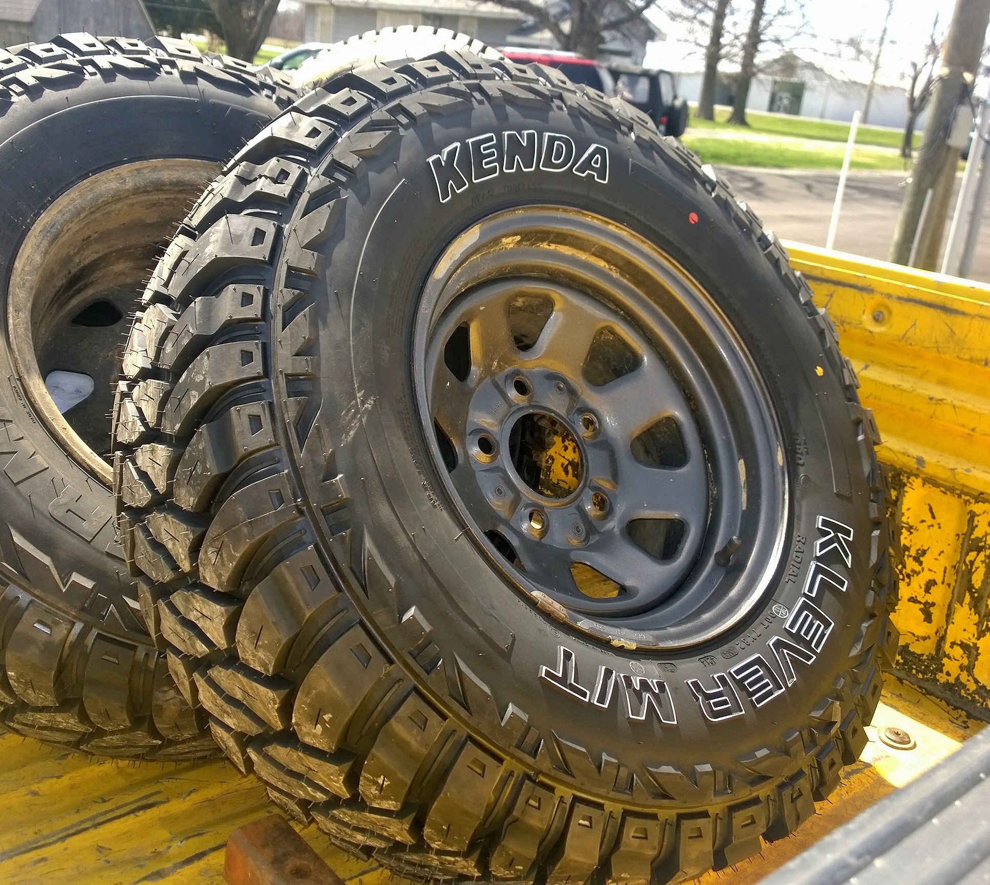

Also, anyone with first hand experience if a 32x11.5 will rub anything at full lock or while flexing? There is only a $40 difference between the 31x10.5 and the 32x11.5, but I was wanting the 32s because they are rated at 25xxlb and the 31 are 22xxlb

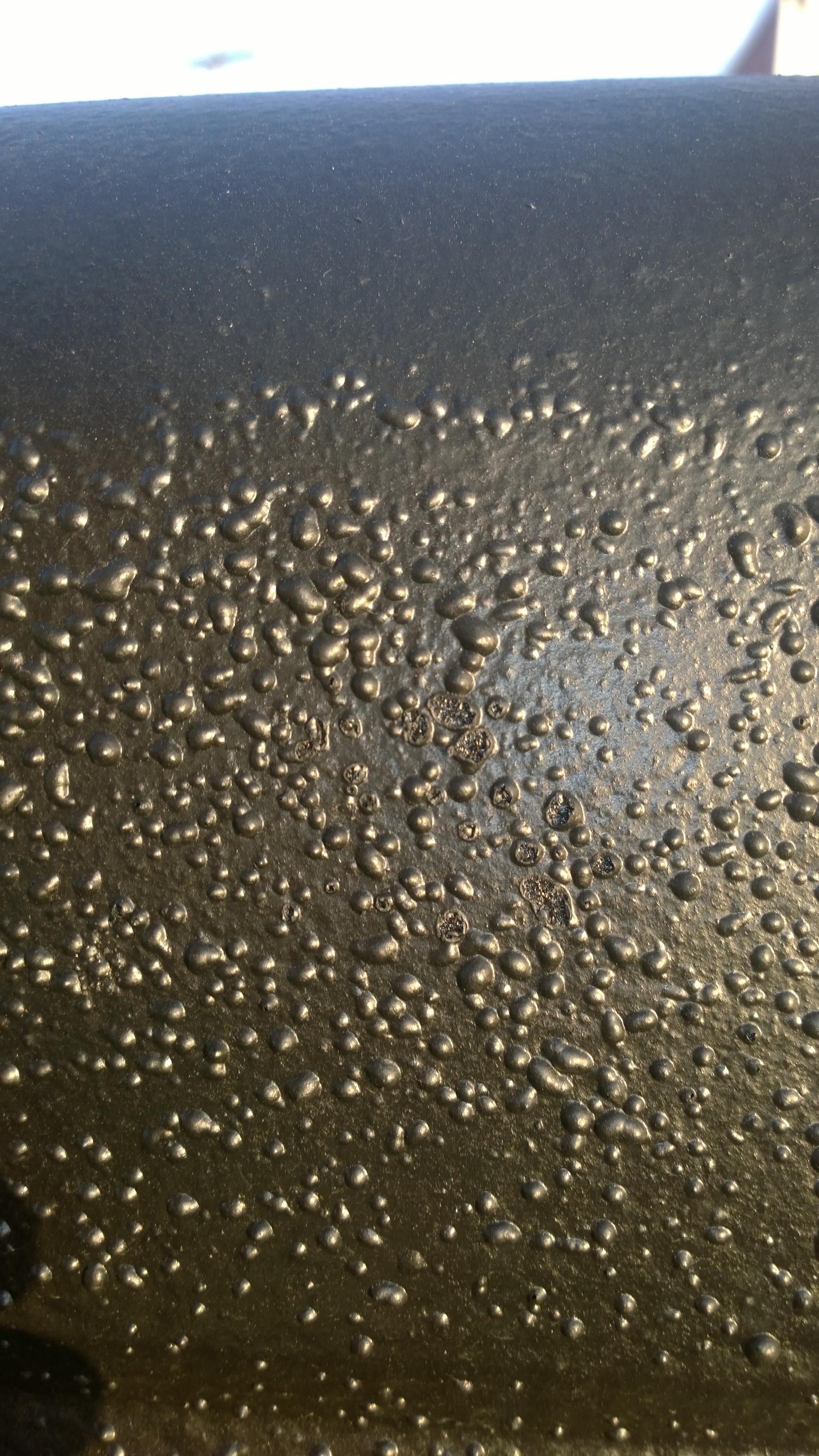

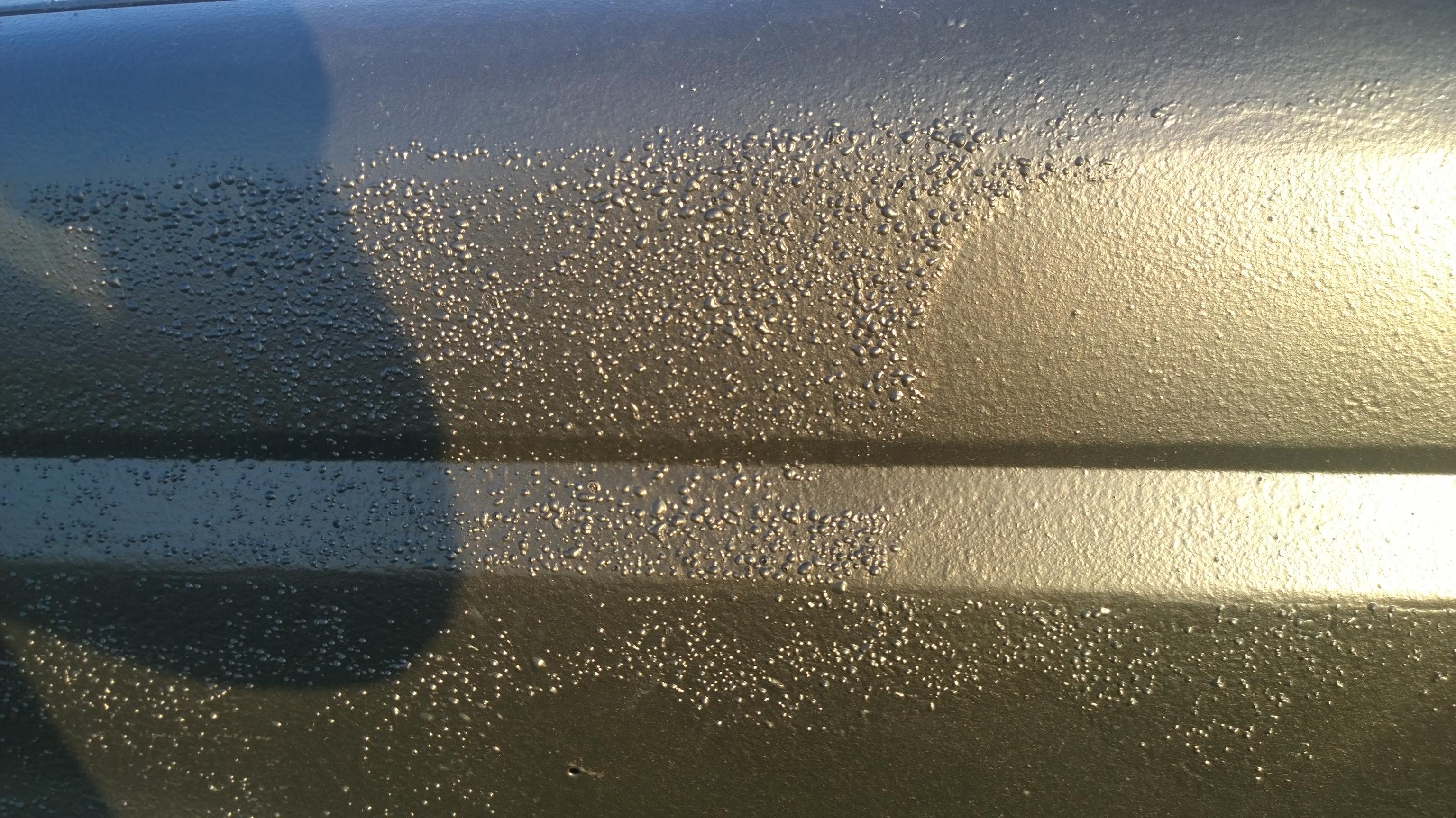

For anybody that thinks painting bed liner with a roller is a good idea, its not. Its easy to trap air and you get tiny bubbles. When the heat hits, they turn into big bubbles. When it warms up ill hit the hole truck with a belt sander again, just to smooth out the liner and ill spray a few new coats.

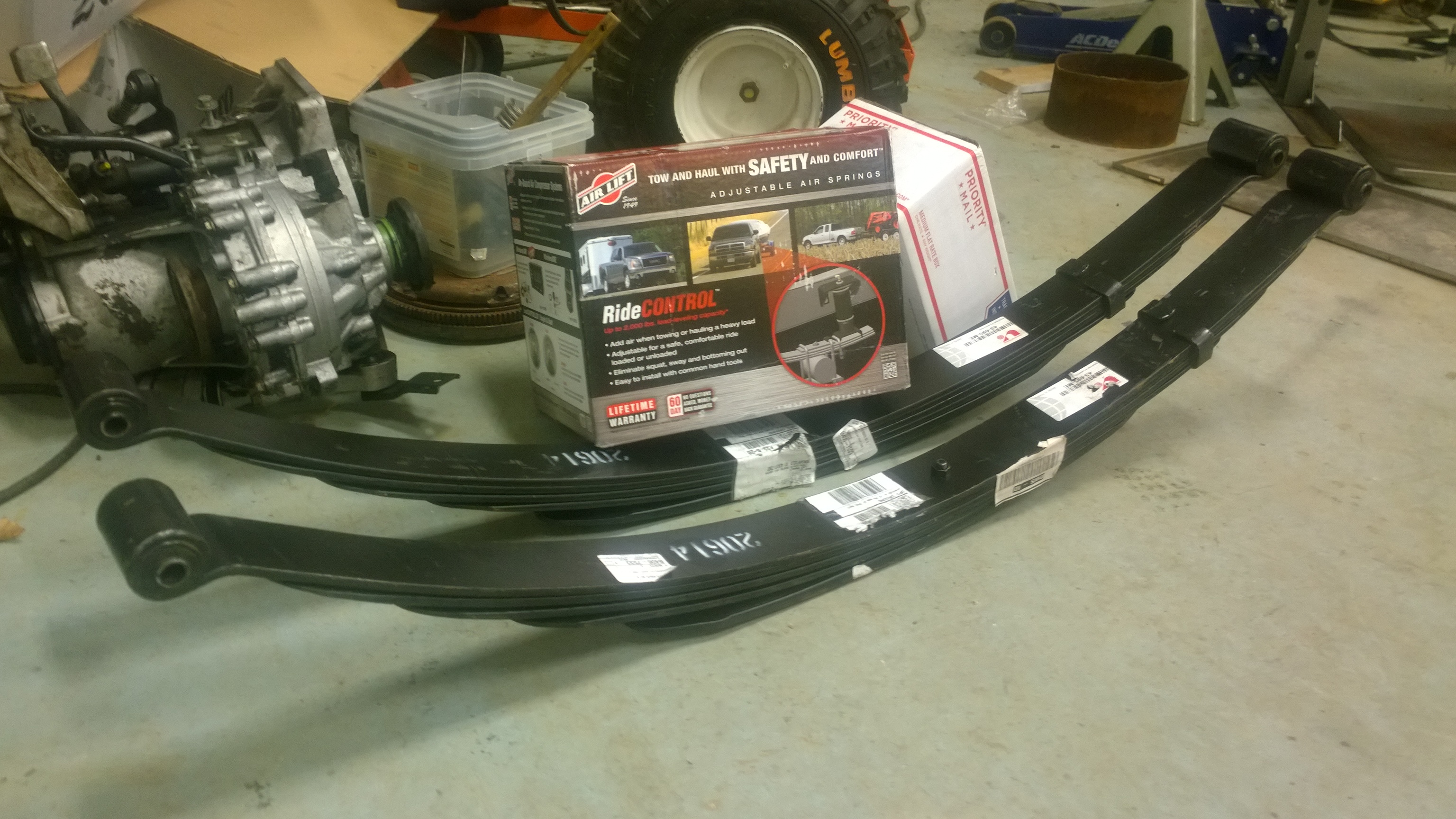

This stuff showed up last night. Im kind of glad because the place I was renting an excavator for on Sunday called and said they wouldn't have one available. Hate not getting anything accomplished on my day off.

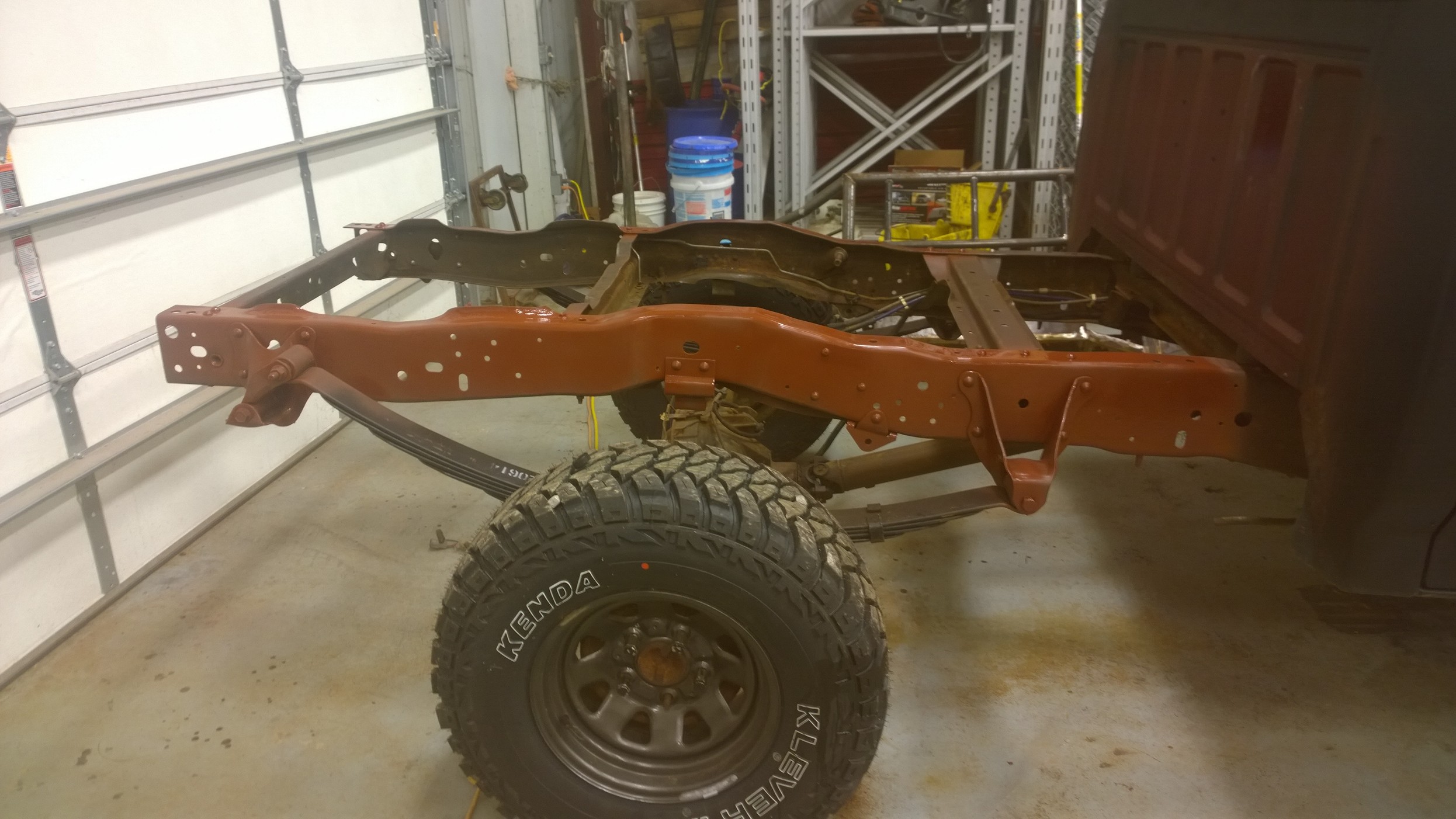

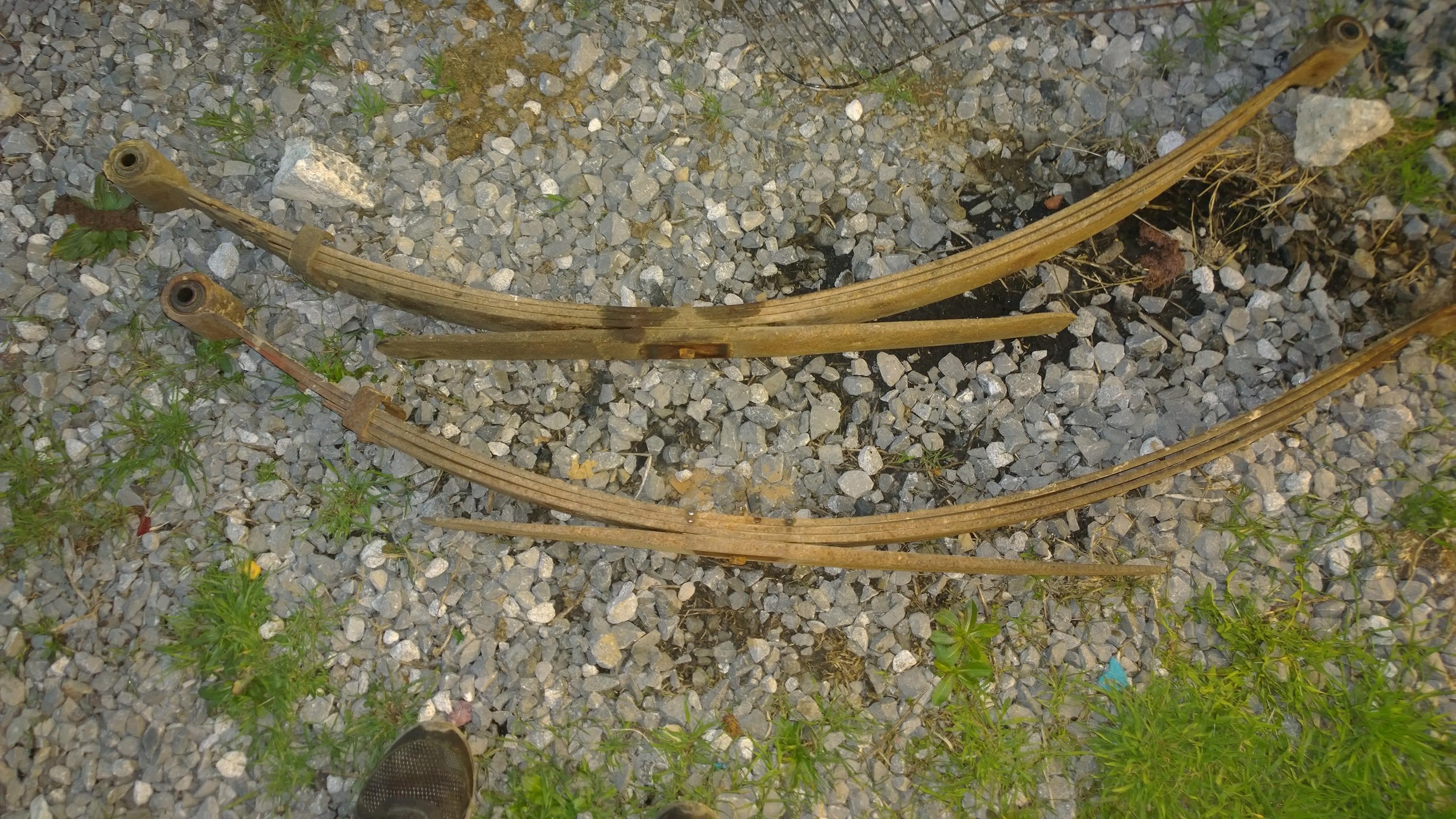

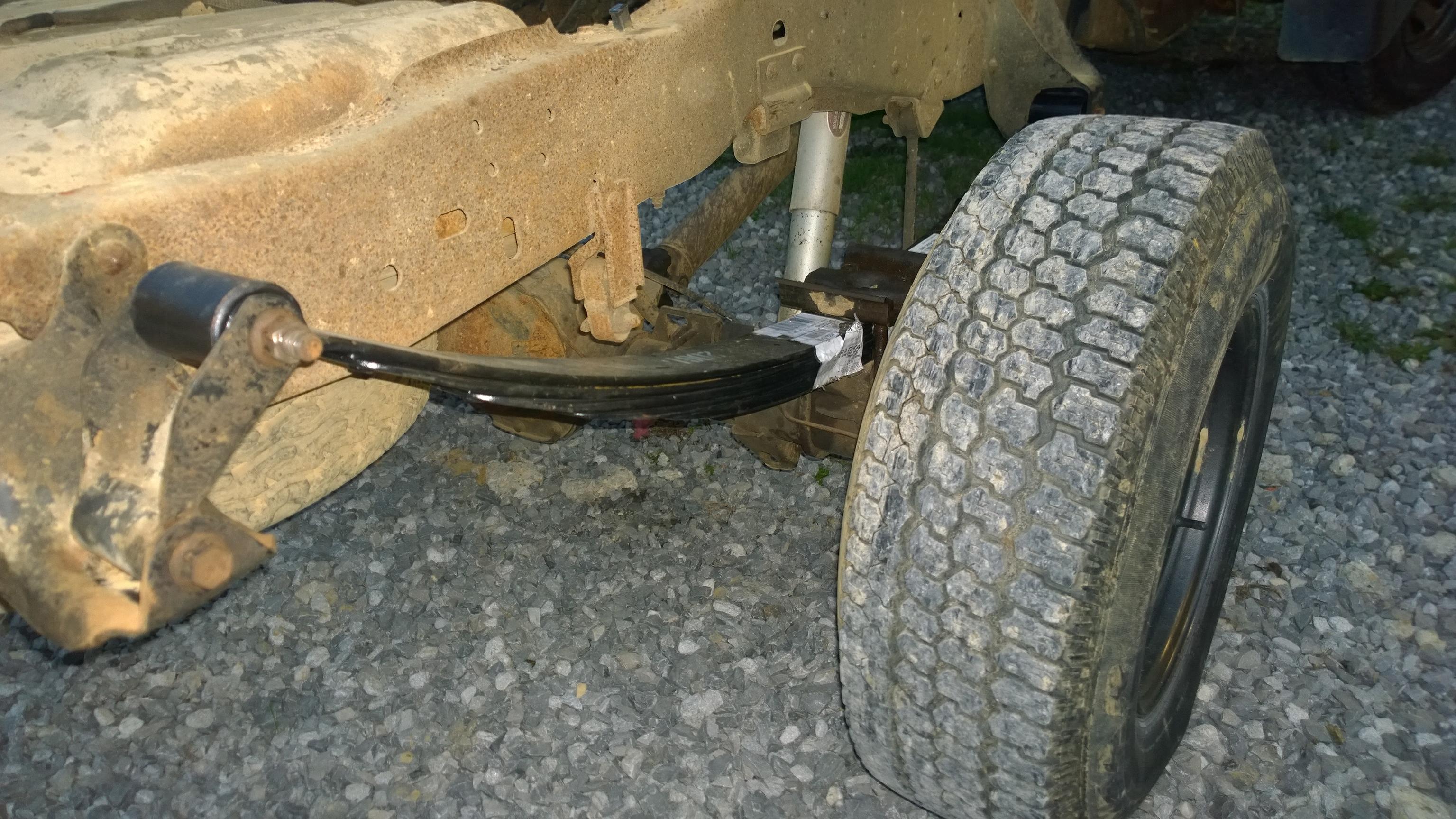

Little progress today. Last night i was trying to find what the bed weighed to figure out if i needed to go find my tractor. I ended up cutting the heads off of the bolts, undid the electrical and fuel neck. Turns out its pretty light, I picked up the ass end and drug the head of the bed to the bumper, then stood it up and carried it my back out of the shop. Two people would be all it takes.
Anywho, the old wore out 3+1 1600lb springs are out, the new 4+1 2450lb springs are in. Measuring off the bumper, the ass end now sets 4" higher then it did with no bed. Before I could stand on the tail end and bounce the truck close to the stops, now it gives about like my super duty. The ride is more to my liking too.

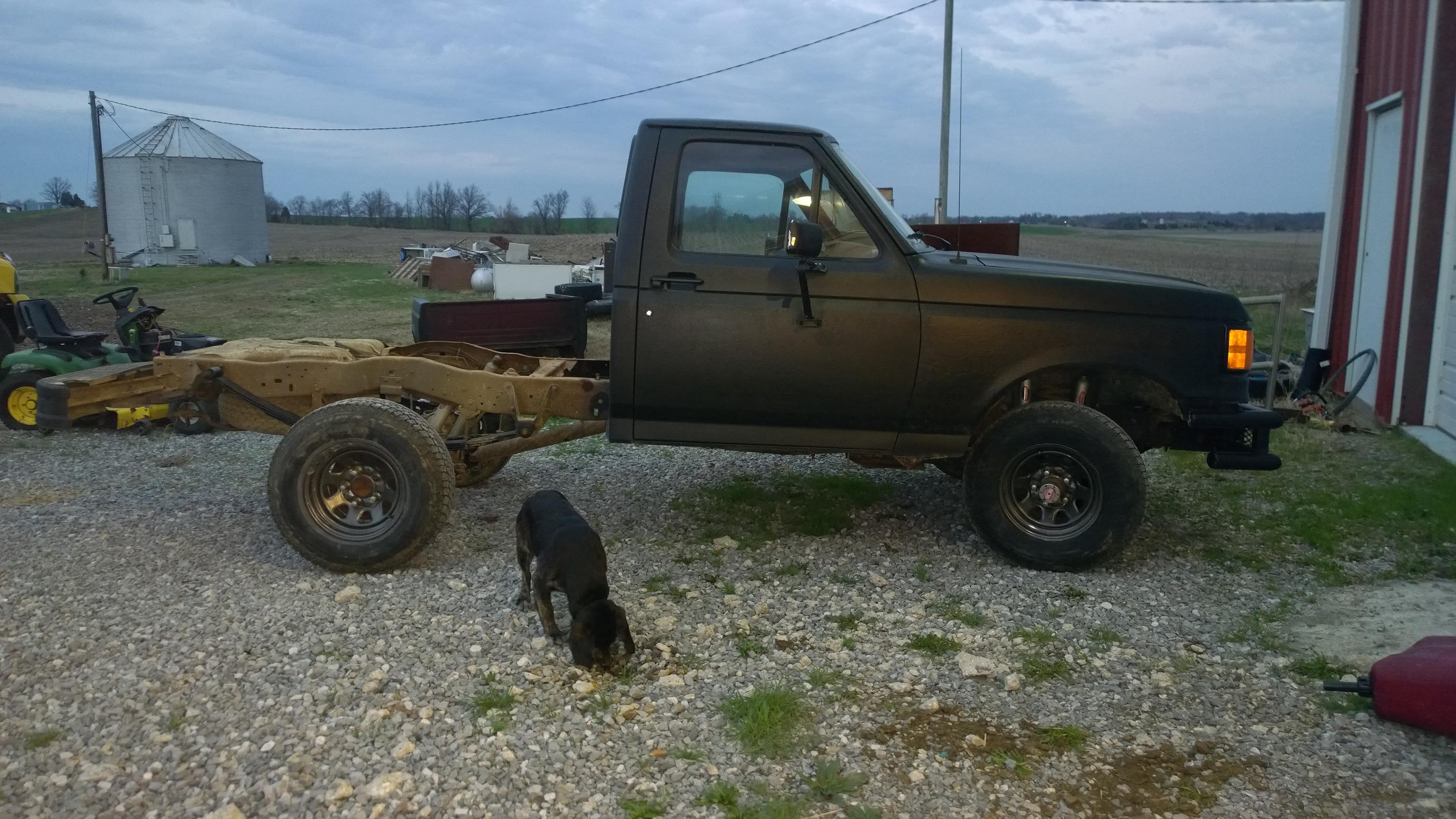

Stripped down the ass end and have been using a grinder to remove the rust. The outside is easy, but the inside is going to be tough. I don't have a large air compressor, but I have an industrial 220v pressure sprayer with a diesel heater. Ive been looking at these sandblasting attachments for pressure sprayers. I will proboly try to have something fixed up by next weekend.

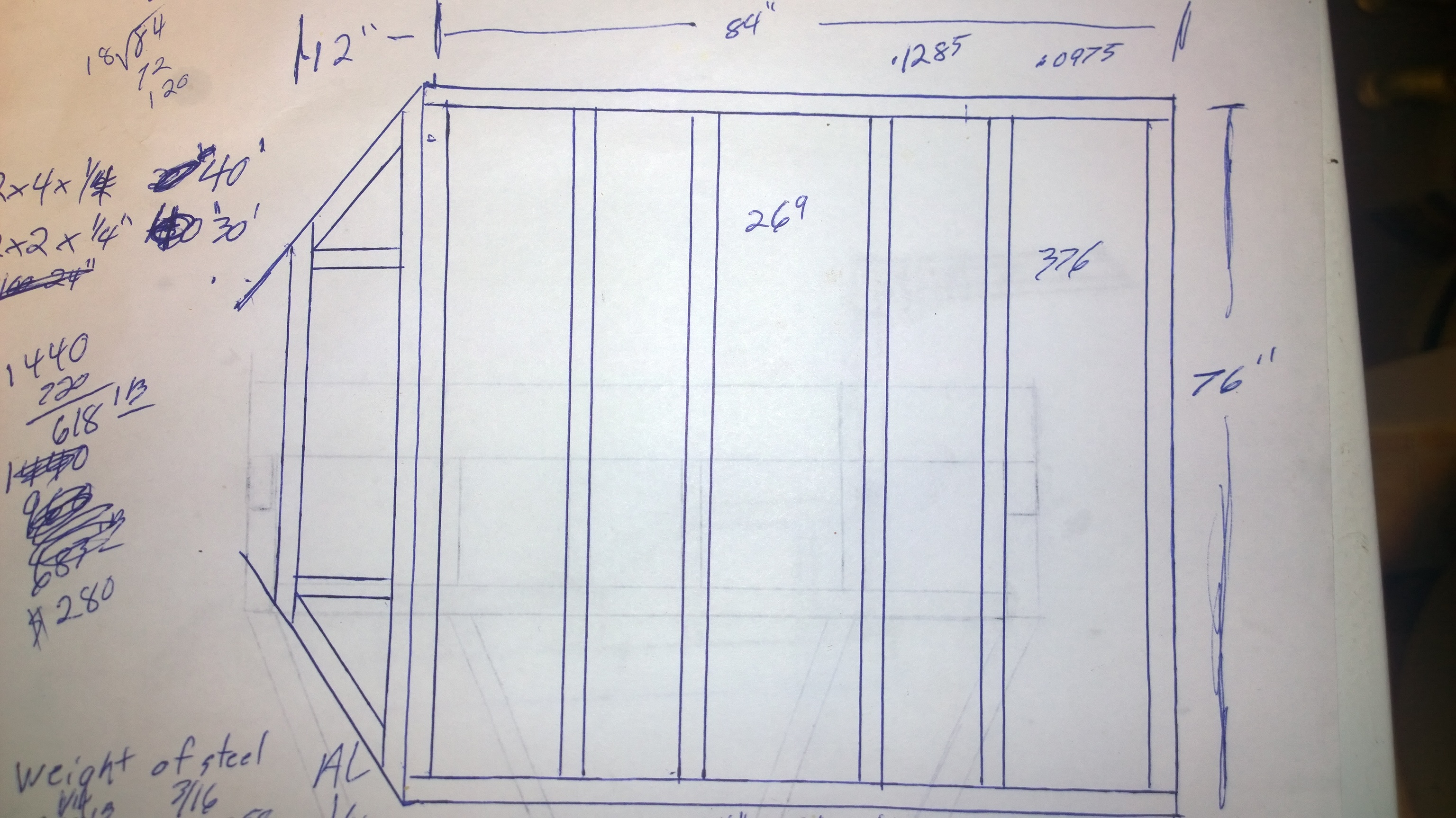

How much weight can a 8.8 axle hold? Im trying to decided about what to do about the bed. What I have drawn up, just the frame and wood deck without the headache rack, its heavier then I like. At 1/4" wall 2x2 and 2x4 tubing, I come up with roughly 775lb. If I drop down to 3/16 I can cut the weight down to around 625lb, and if I go 1/4 aluminum 380 lb
You could also cut some weight down if you use c channel. If you use tubing it will rust from the inside out. Also most factory steel flat beds are made with c channel
Thanks, I guess ive never really taken a look under a flat bed, even though proboly more then 30 come through my lot every day. I redid the math and I believe that using c channel will put the frame and deck around 450lb and make it quite abit cheaper as well
If you use square tubing, 1/8" wall is plenty, properly designed. Channel is better.

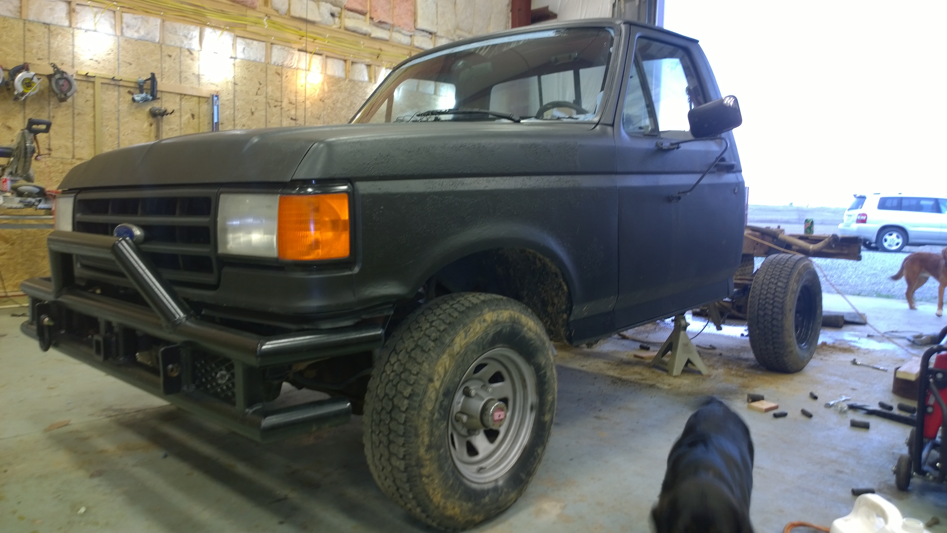

I picked up the channel today, other than that haven't had much time to mess with this thing. Coworkers have been dropping like flys so its been longer work days again. I got bored and started shooting the outside of the frame. Im wanting to build and auxiliary fuel tank. This truck only came with a single tank and seems to only be 14-16 gallons, which annoys the piss out of me. How thick of metal should I use to build a tank.
