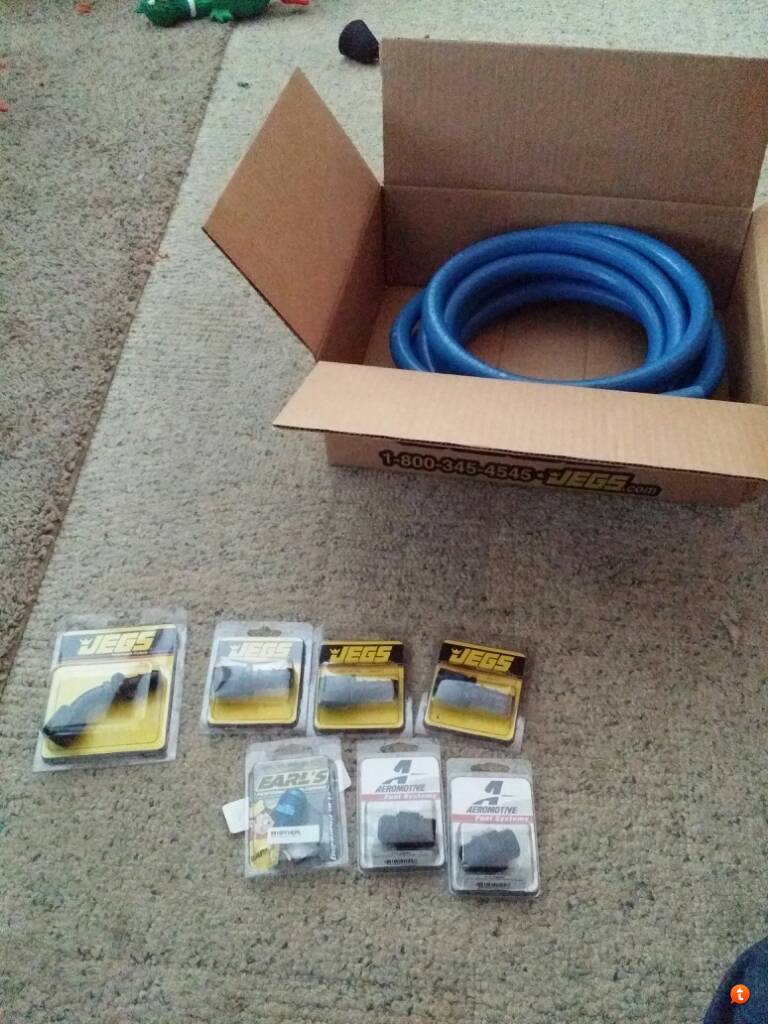

Got a bunch of stuff in. -10 push loc, aeromotive a1000, all the fittings and tork tek to do my fuel system. Also stainless 2.25" 14g t409 to build my header. Waiting on a few more things then I can start putting it together to do first startup!
