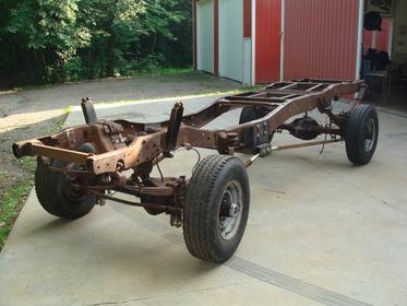

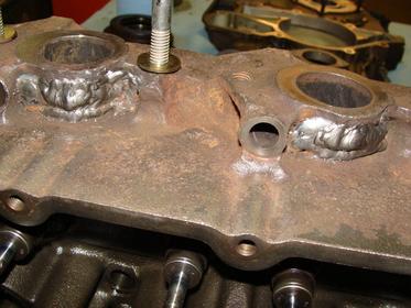

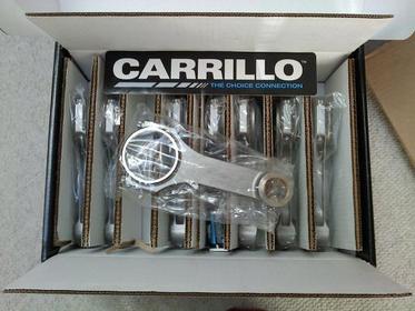

Started on this project a while back, starting to make some progress finally motor is getting machined right now.

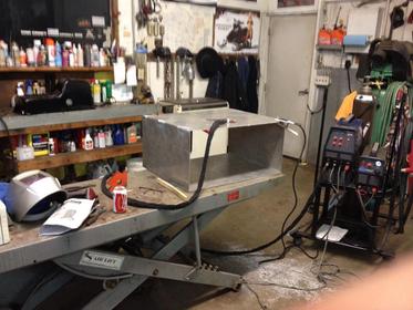

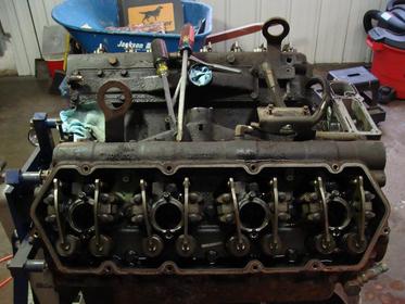

Few more pics of what is happening on the project. Currently setting up the engine with carrilo rods, mahle pistons coated -1.5 pts Compression ratio. Getting Balanced linehoned with girdle and ARPs,- heads ported fire ringed with ARPs, bowled shimed comp 910's. ,SRP 1.1, 300/200 injectors, Turbo setup S467 /S483 with dual 60mm turbosmart wastegates, and a small refrigirator / air to water intercooler. Phoniex Single Ceramic Clutch.
Hoping to make a few ponies, and still be decent to pull the bobcat around.
Any tips im open.

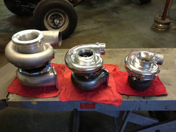

So things have changes a bit and they always do. I was originally gong to run a twin but now it's going to be a thriple setup 66/82/106. Any hi I would like to run beehives from comp need some set pressure for the boost. Anyone running them. Wondering about insta procedure.
Thanks

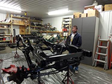

Some changes in build plan besides an additional turbo include. Injectors 400/200 from farmers via vision diesel. Regular air to air intercooler, got the whole turbo kit from Vision for to good of a deal and inter cooler from ponticross. Hpop setup will be my stock 15 and a gen 3 from another member on here. Waste gates changed to 46/39/39 all percision units. Anyhow hoping on getting my engine back by Friday.
