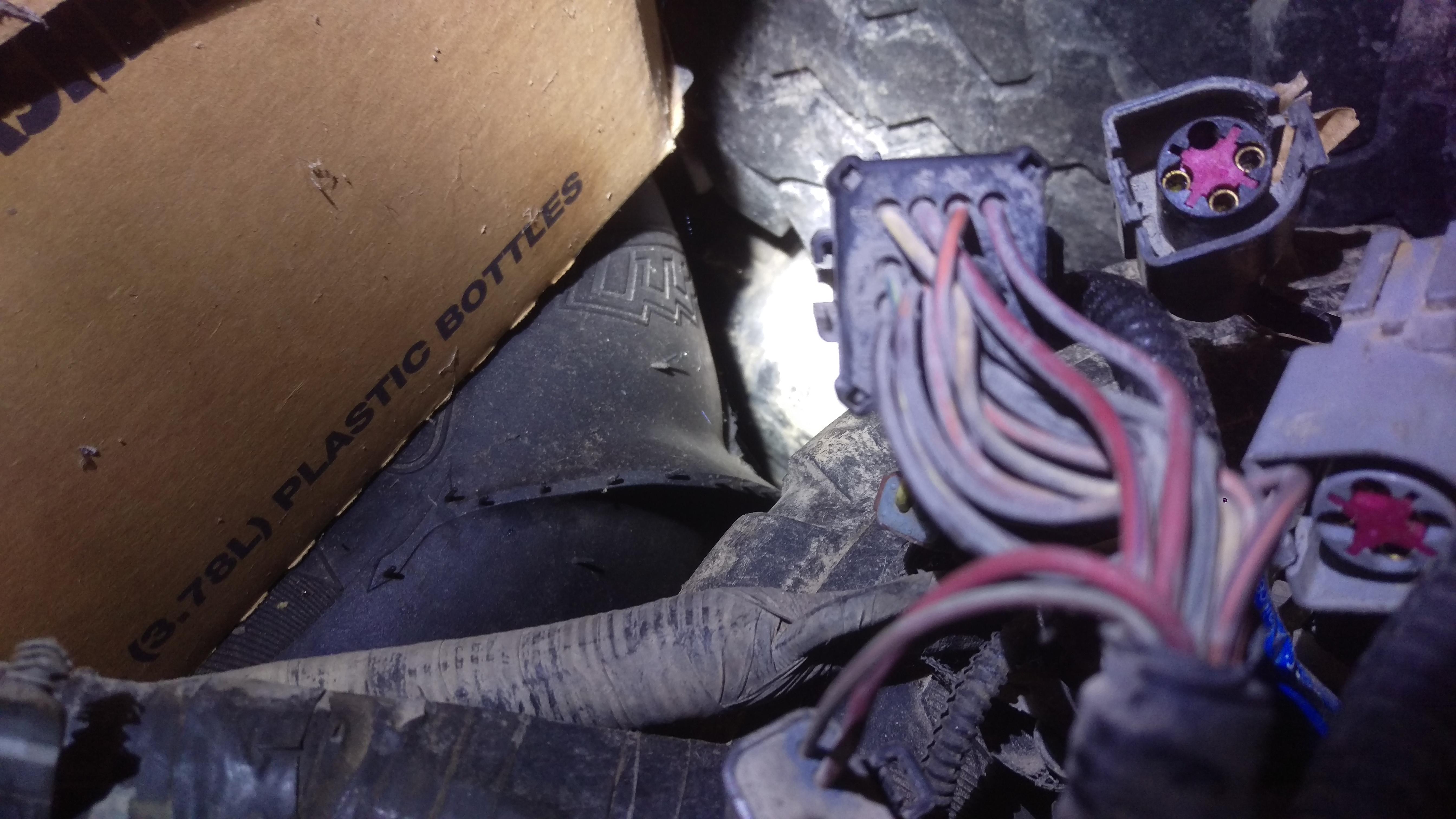

Iam using a stick shift DCM from a 95 and the 5 speed harness for my swap. The truck is a 97 the two plug right togather. Thats all I need right in the engine bay. I know under the dash I need to wire the clutch pedal were do I wire it to? Thanks guys
zombie-obs-raising
Sep 21, 2015
51
Waterloo Illinois
Hey guess I went out to the shop here are some pics. I found this pig tail. It is the one that plugs into the clutch pedal right the other pics are the 5 speed Barnes plugged into the auto one. Thanks for your help guys
