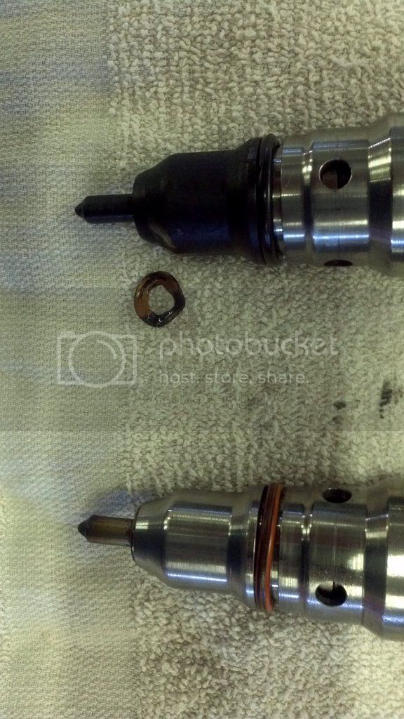

Yea you got a blown out copper. Look for the loose injector
Hopefully you find this and it didnt bend a rod

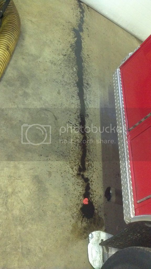

I love the pic of the trailing oil spill LOL That is classic.
I am amazed your bottom o-ring looks so good. You much have caught it quickly but then oil pouring out of your tail pipe is sort of hard to ignore.

That ambulance was driven to us like that... The stains are STILL in our concrete.. That was 4 months ago... It was one of our pump guys fault though, very inexperienced and didnt install the injector correctly.. When dealing with ****ty Dipaco injectors, you HAVE to put dielectric grease on the copper since there clearances SUCK and the copper falls off when pushing injector in... Hence why its all fubar....
He was so embarrassed..
Oh, and dont mind the crushed coolant bottle, someone threw it under while I was driving in... scared the **** outta me...

Did you ever find the coolant bottle lid. I know those will fly a long way and still leave a welt on someones calf when run over like that.

the red thing to the left of the tail pipe is the cap. must've bounced off mudflap
