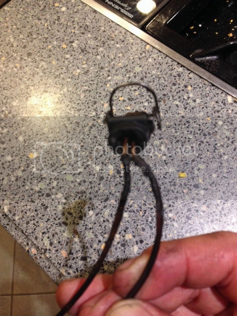

Pull the split loom for the IPR harness and inspect it. Mine was shorting due to the insulation missing.
