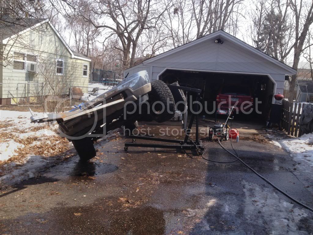

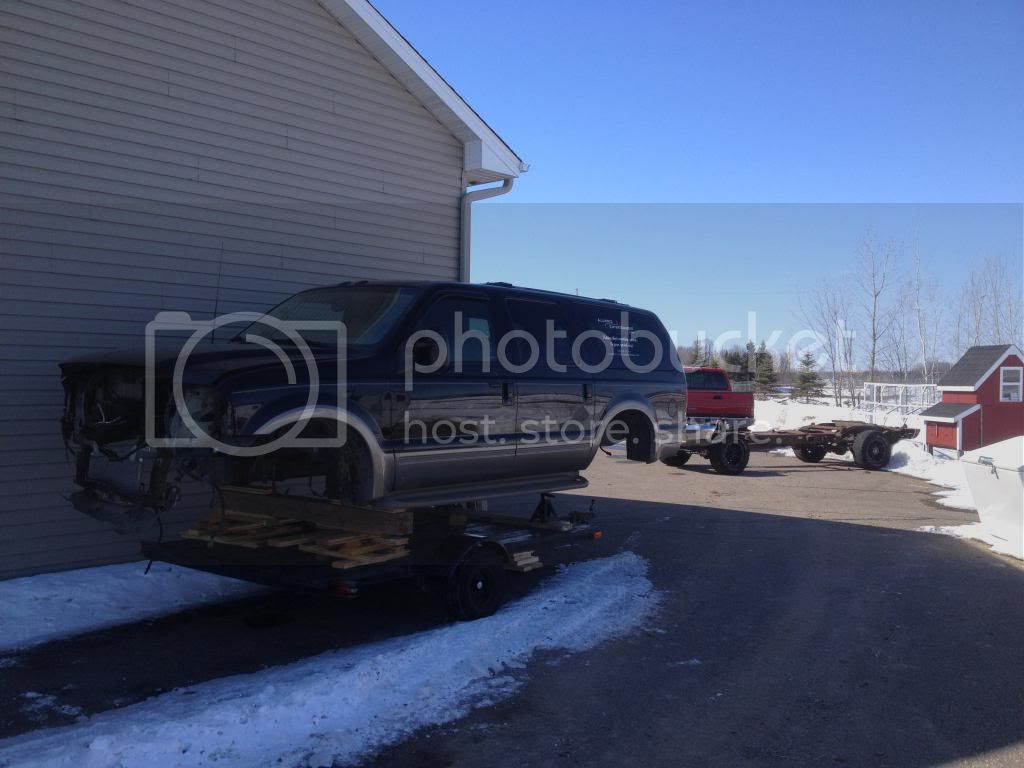

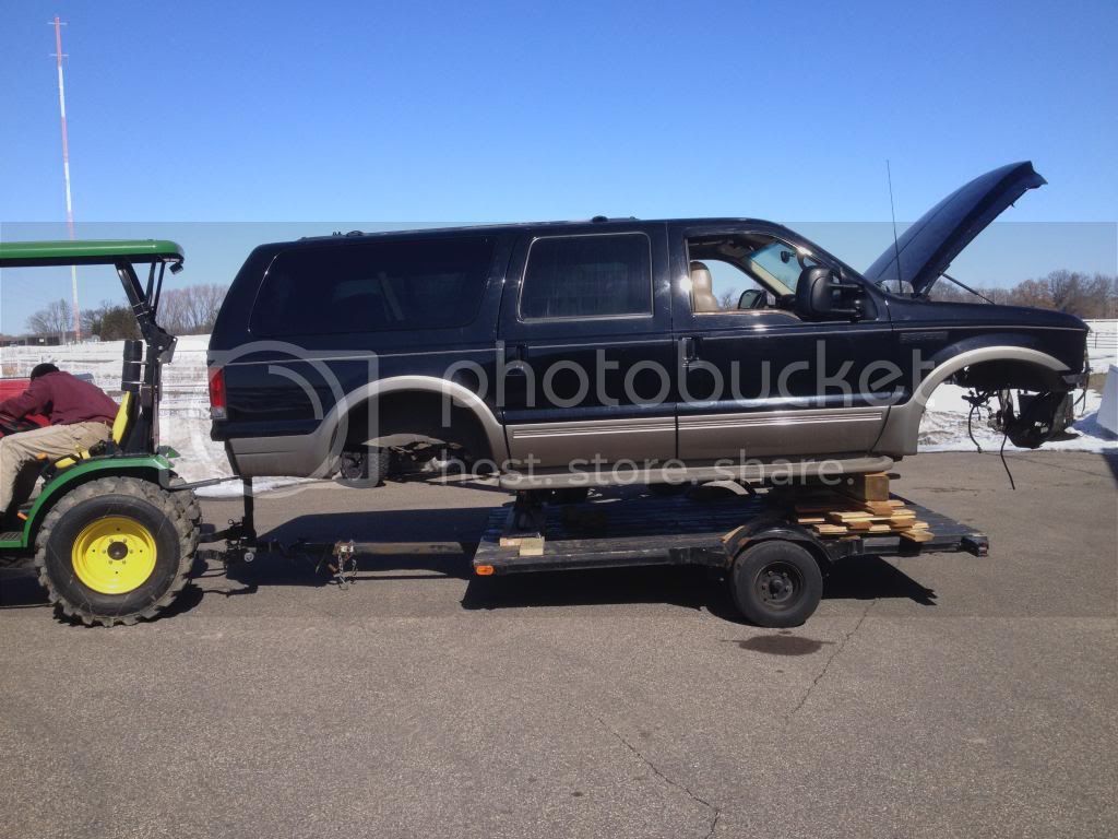

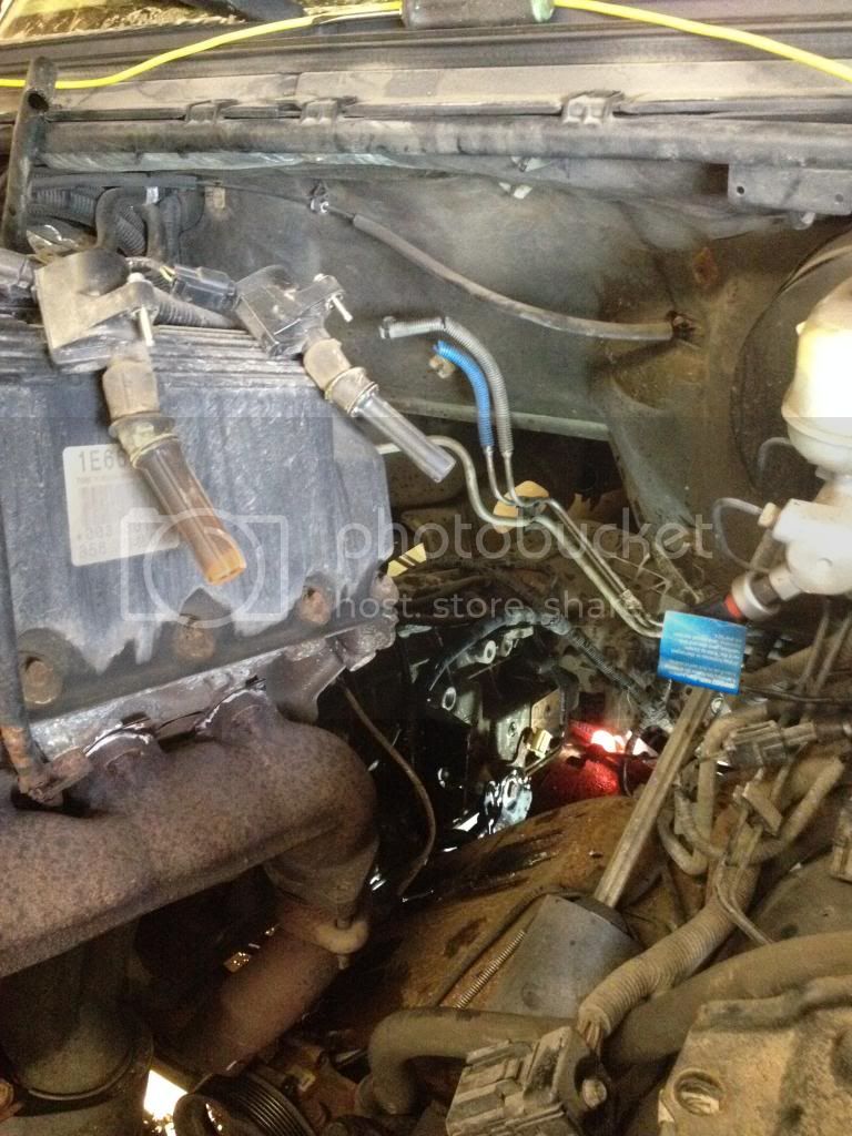

Made some progress this weekend.

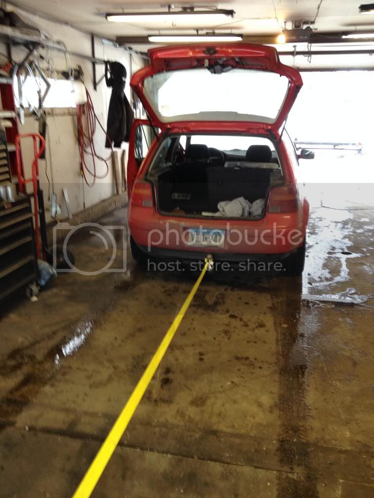

First I need to get the X into the garage so I could start working on it. Didn’t want to wait for my friends to get off work to use one of their trucks so I thought I would try with my car. Moved it about 20ft then gave up. Didn’t want to break anything on the car since the trucks at the cabin and the car is my daily driver. My dad stopped by and helped me with his truck.
Thru a fresh battery in her and started right up. (not sure why I didn’t try that first)

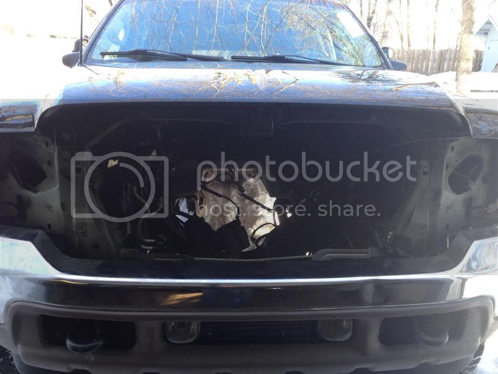

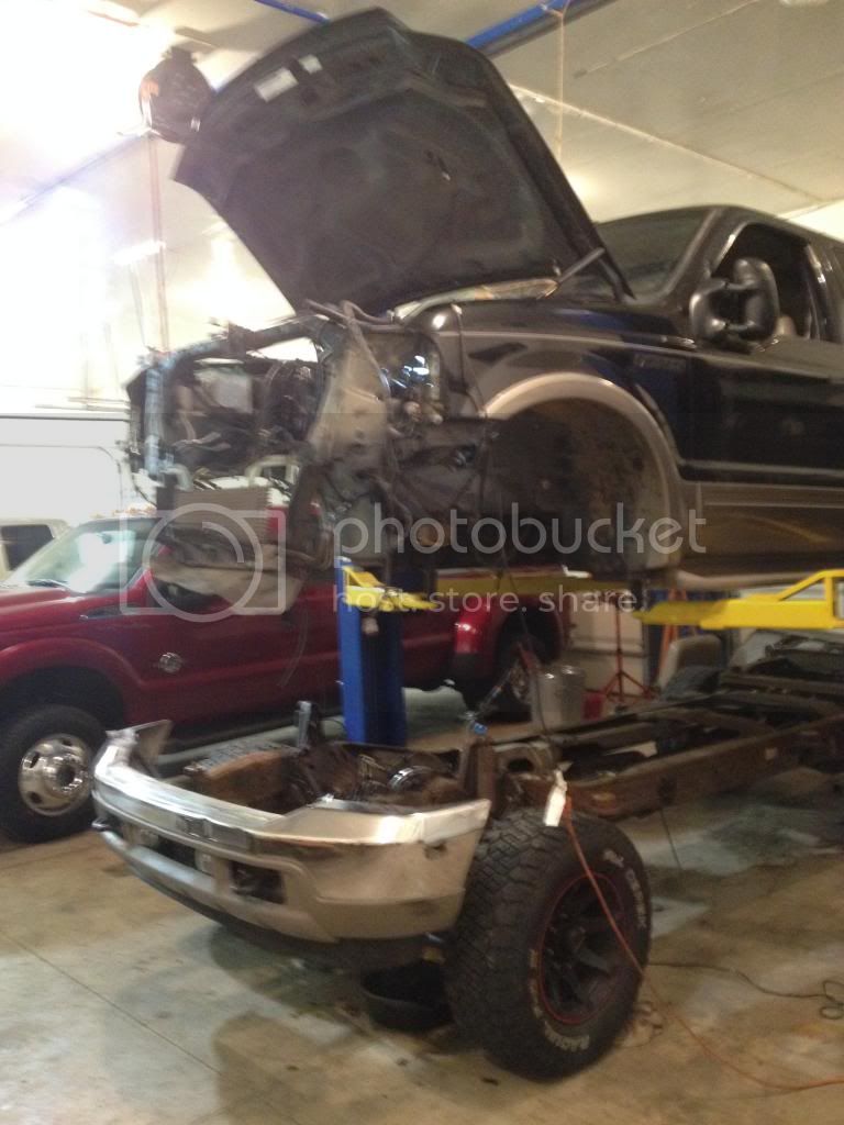

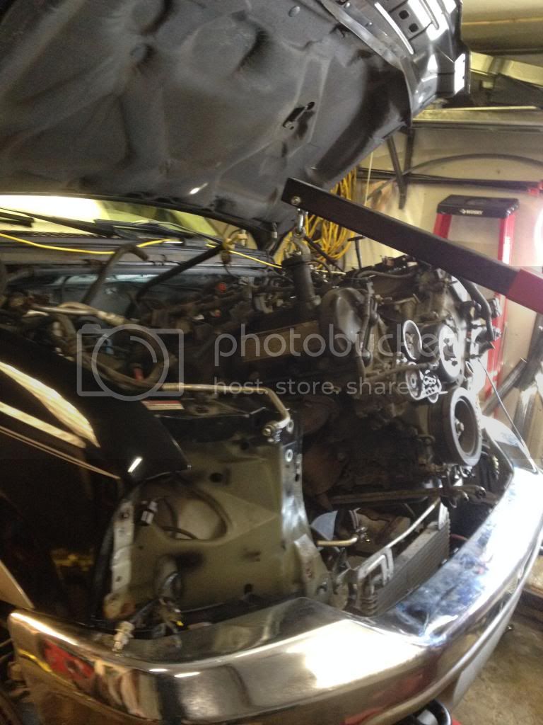

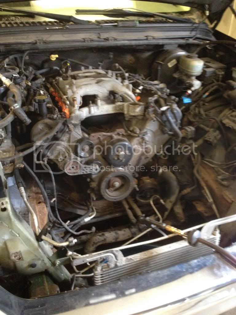

Saturday morning I started yanking the front clip off and getting the V10 out. Right after lunch she was out. Pulled the transmission and t-cast out with the motor.

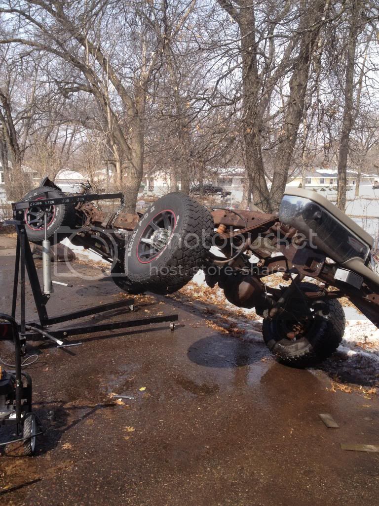

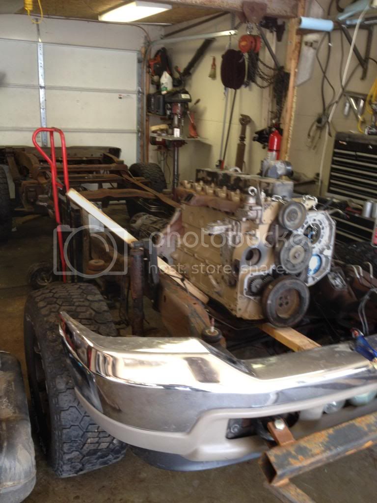

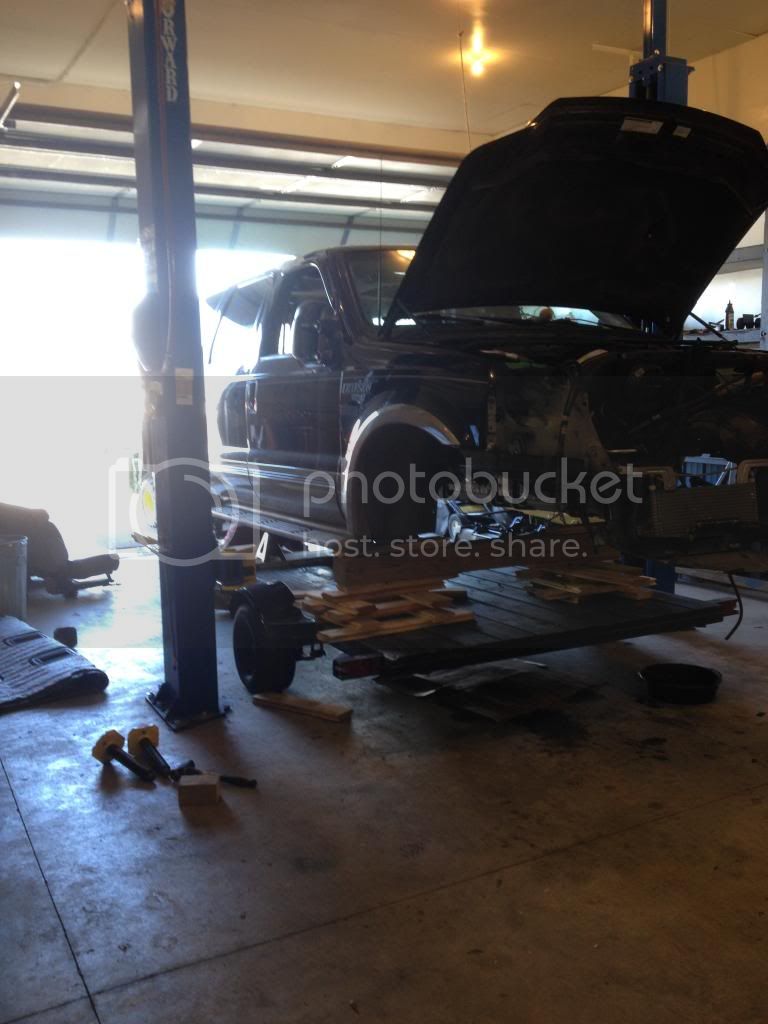

Cummins is being deilverd to work tomorrow and I’m towing the truck to my brother to lift the body off the frame next week. From there I can fit the Cummins on the chassis and underline the body to try and keep noise down.
Few pics

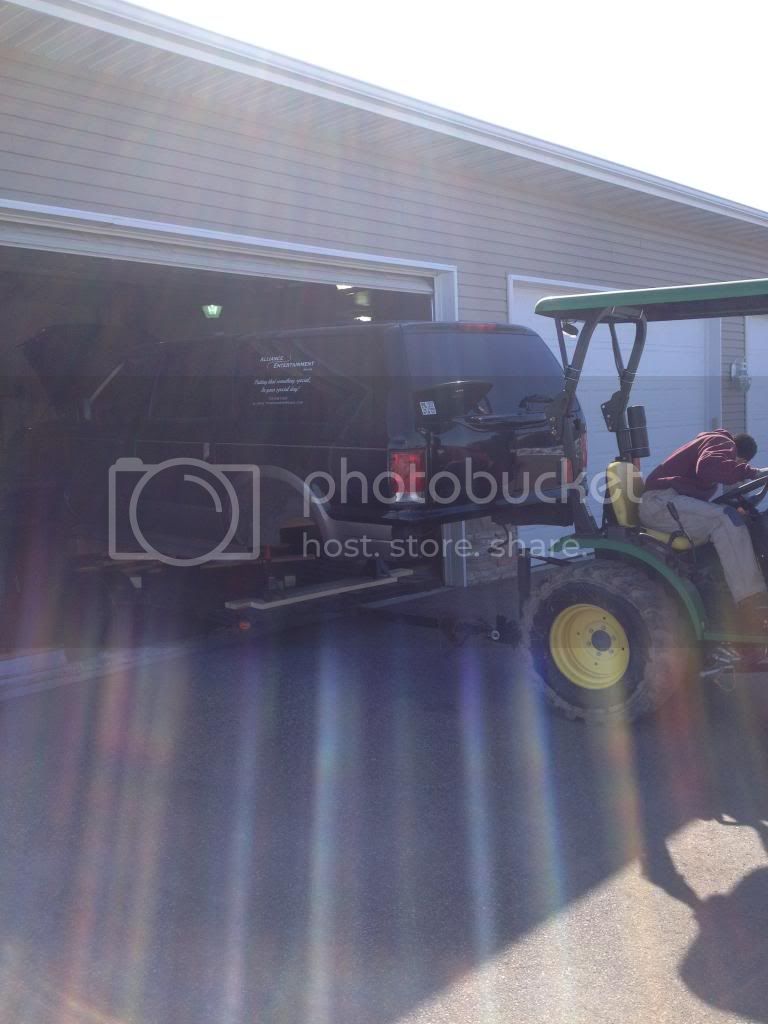

Safety chain is what you see. Log chain wrapped around the tow hooks then back up to my truck.
No lights :( had some all rigged up and they ended up not working. Wanted to make it home before dark so I just threw the hazards on and went with it. ONLY had 90 miles togo on the highway :) If I did it again I would have lights.

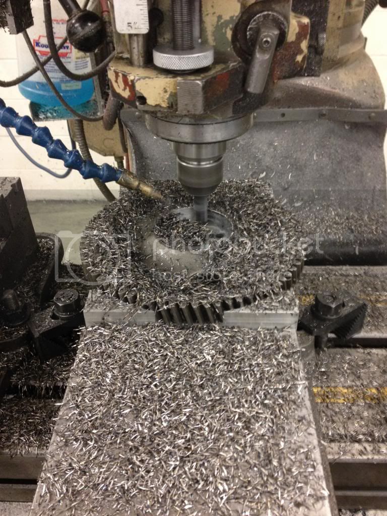

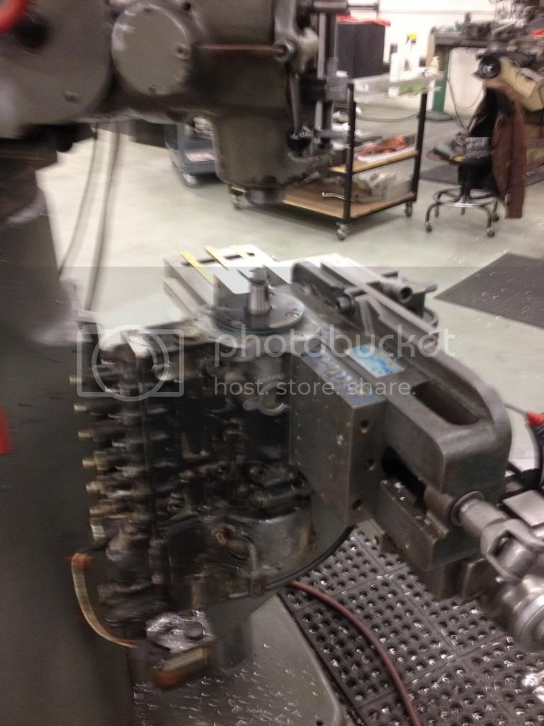

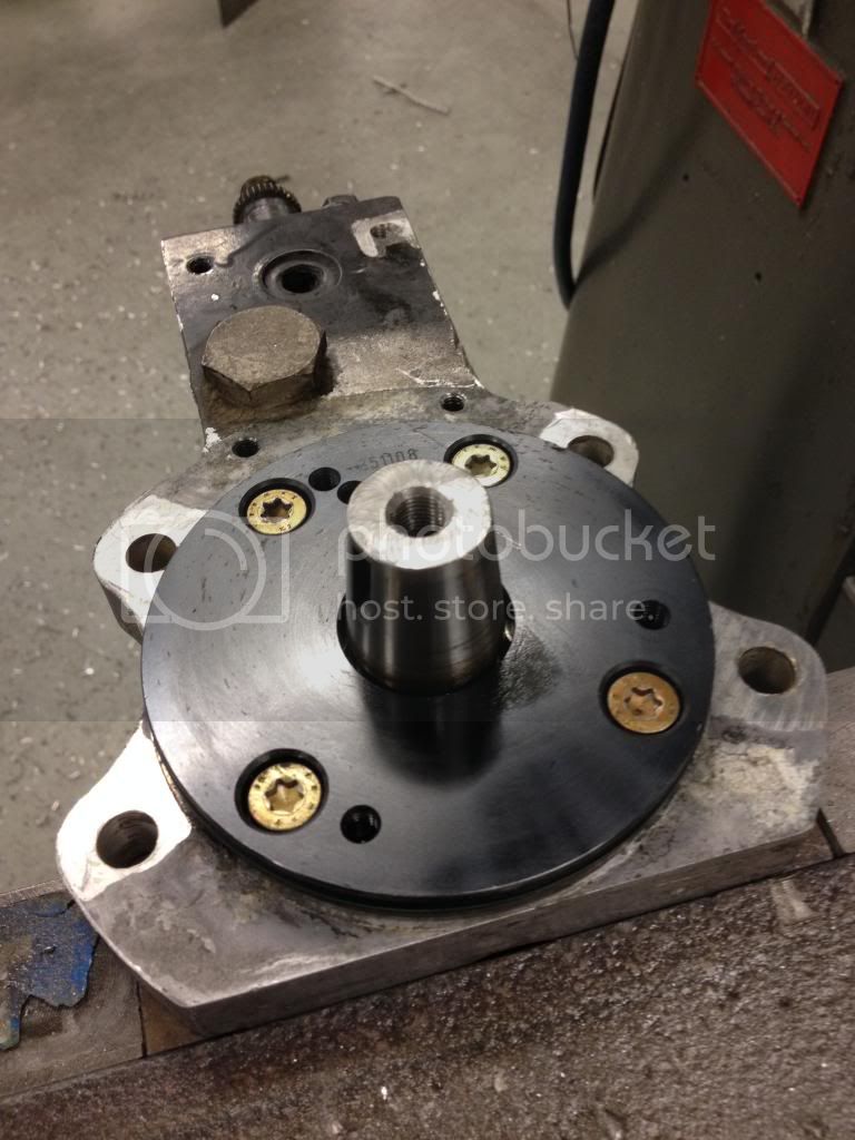

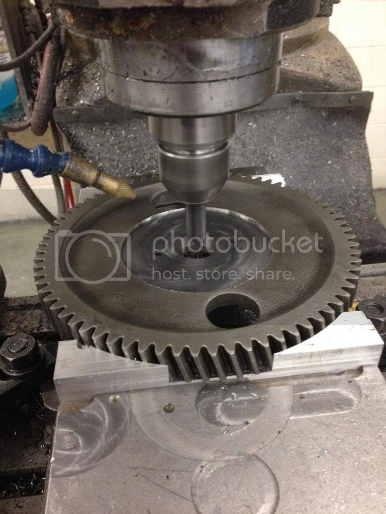

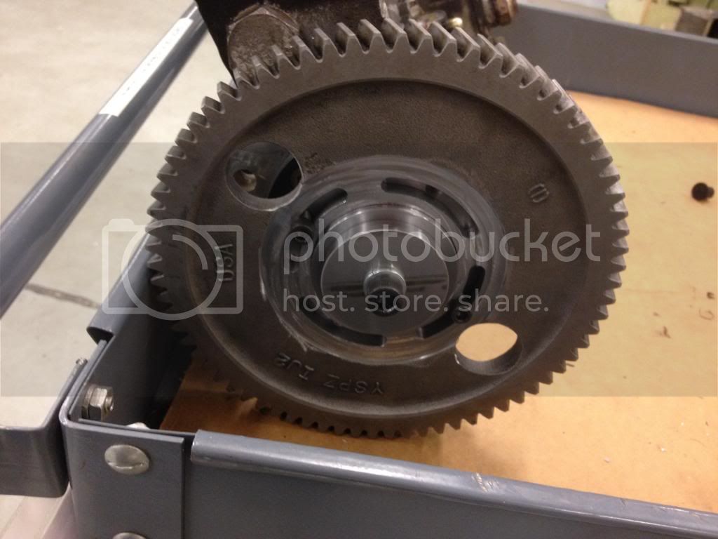

Motor showed up to work on Thursday and have been working on it since. Spent some time at work this morning making a adjustable pump gear and fixing the threads on the pump. The threads were to far gone to save so I milled them off and tapped the center for a 3/8-24. Does anyone know how hard these pump should turn over on the bench. This one seems hard but then again I have never dealt with one of these pumps.
Fixing the threads
Machining the pump gear down to except the hub.
Finished adjustable pump gear minus some grade 8 hardware.

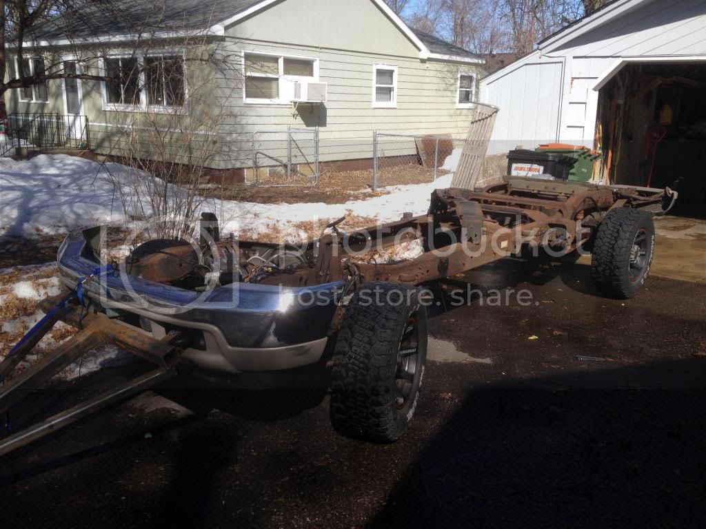

Made some big prgoress this weekend. Got the body off the frame, frame pressure washed and motor set in. Going to start building motor mounts tonight and if all goes as planned with be painting the frame this weekend. Order 400 dollars in paint. Went with POR-15, self etching primer, then a black topcoat. Going todo the frame and underside of the body.
Here is some pics.
