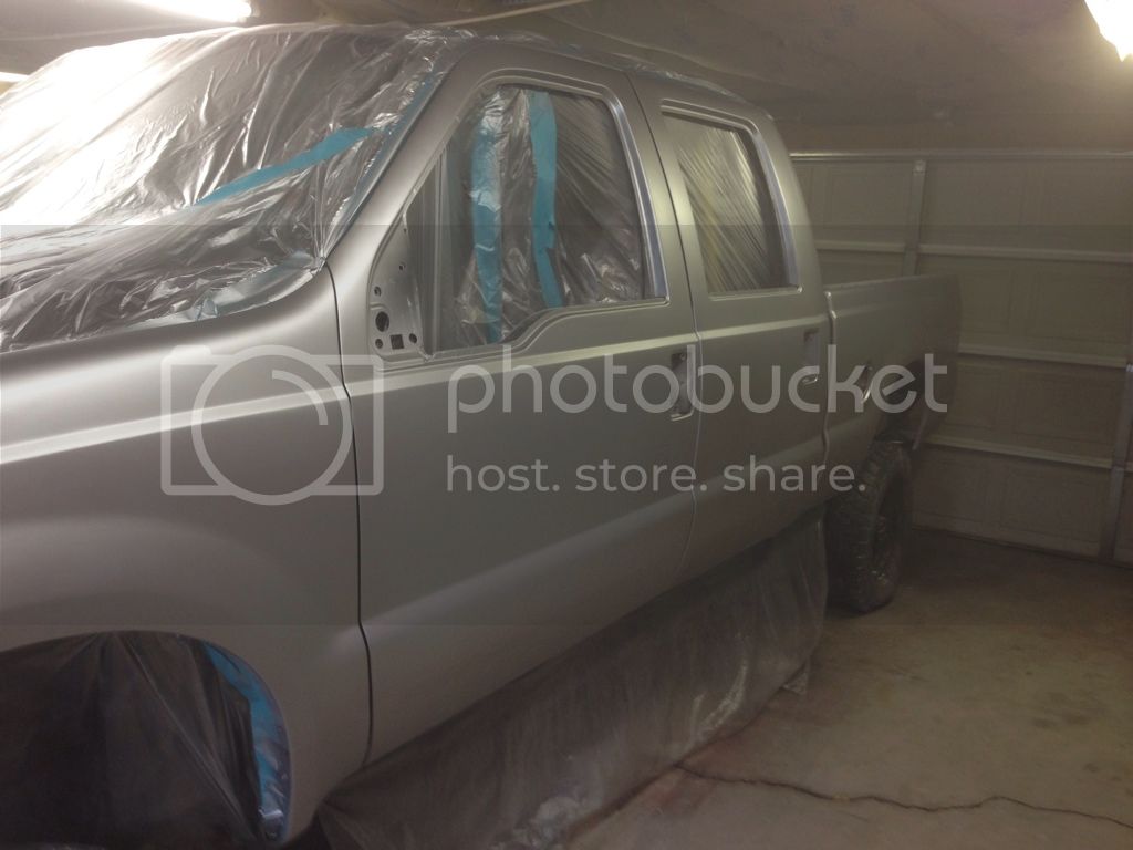

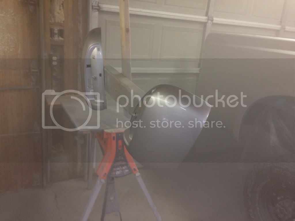

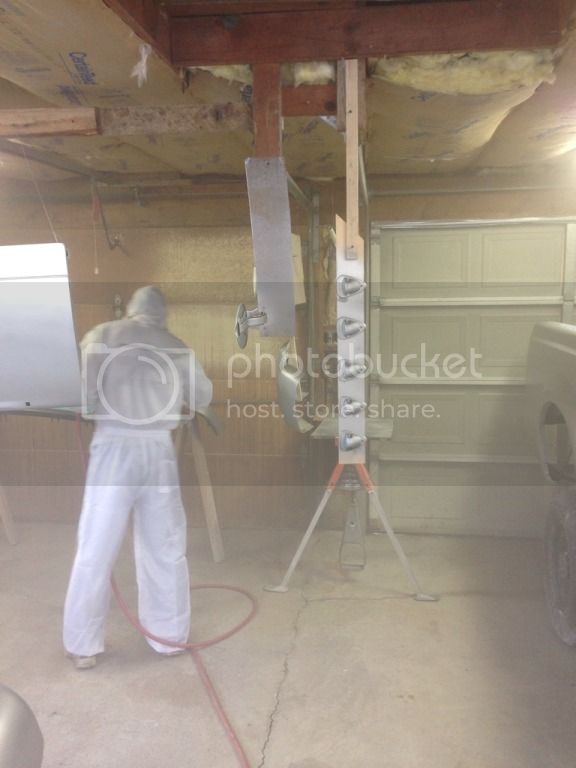

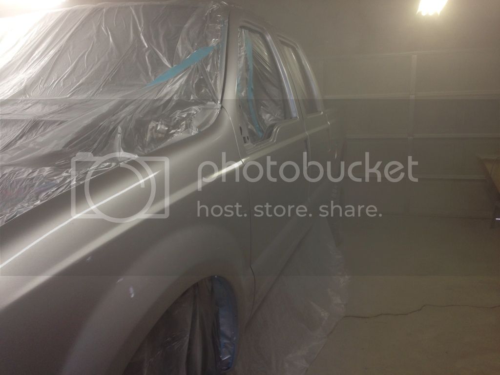

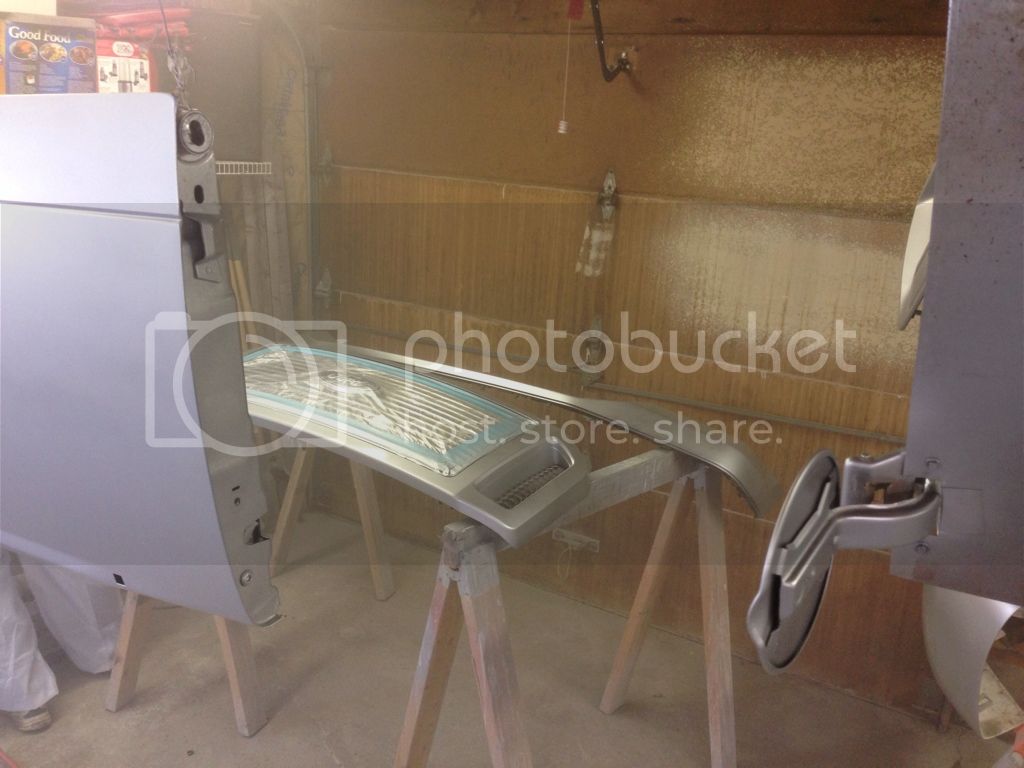

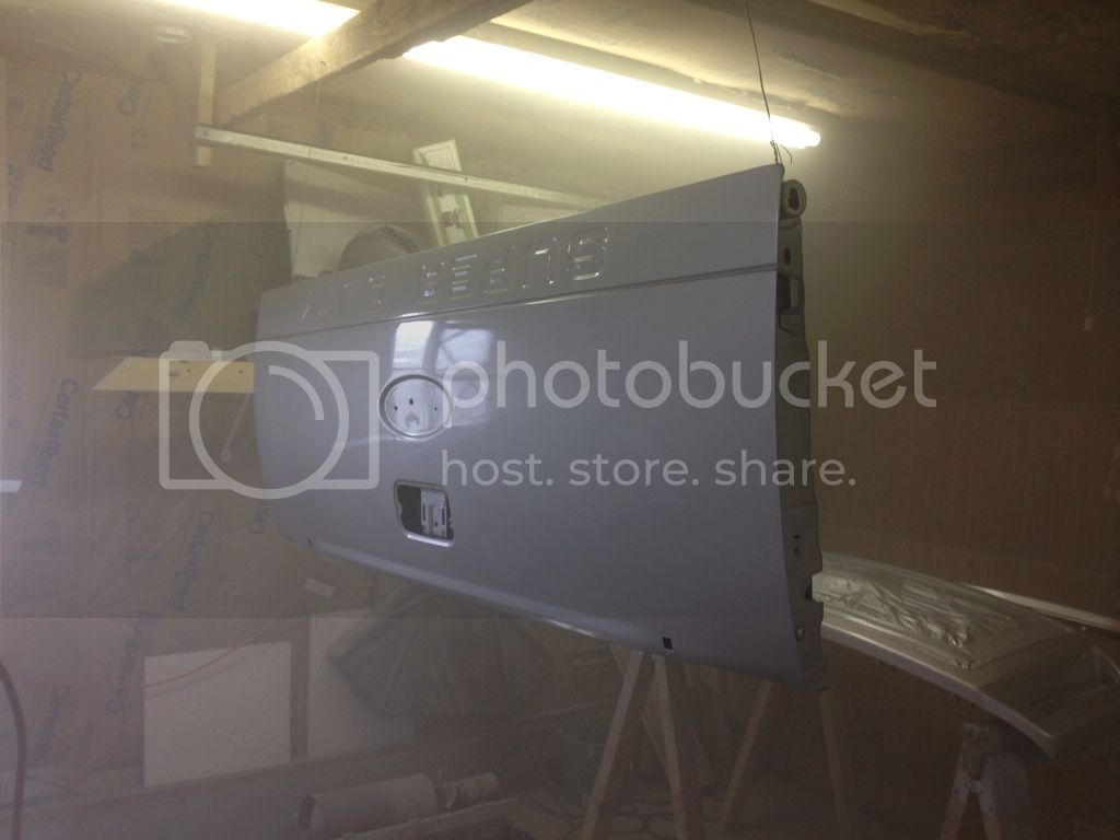

Gravel Guard put on

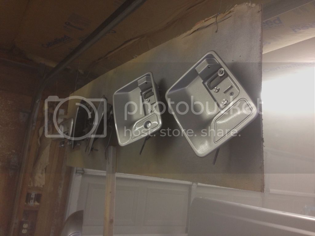

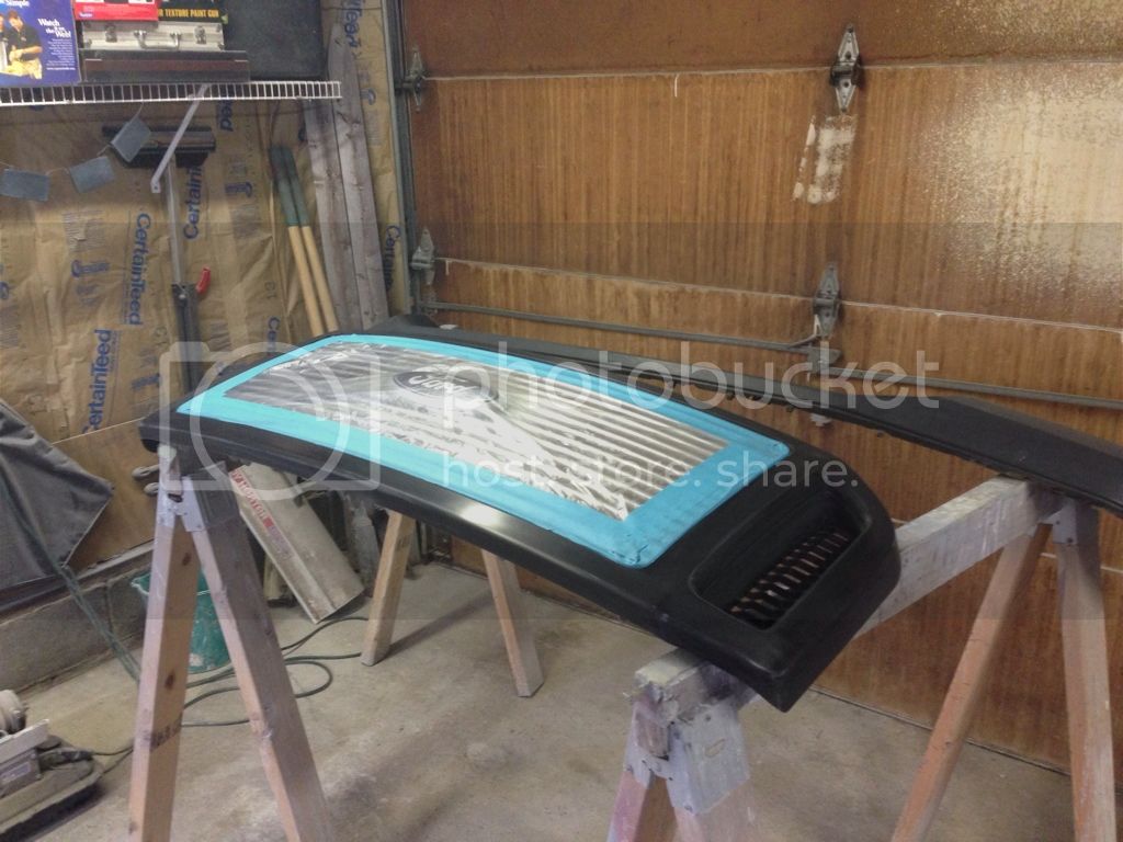

Handles hung and sprayed with primer
Grill prepped

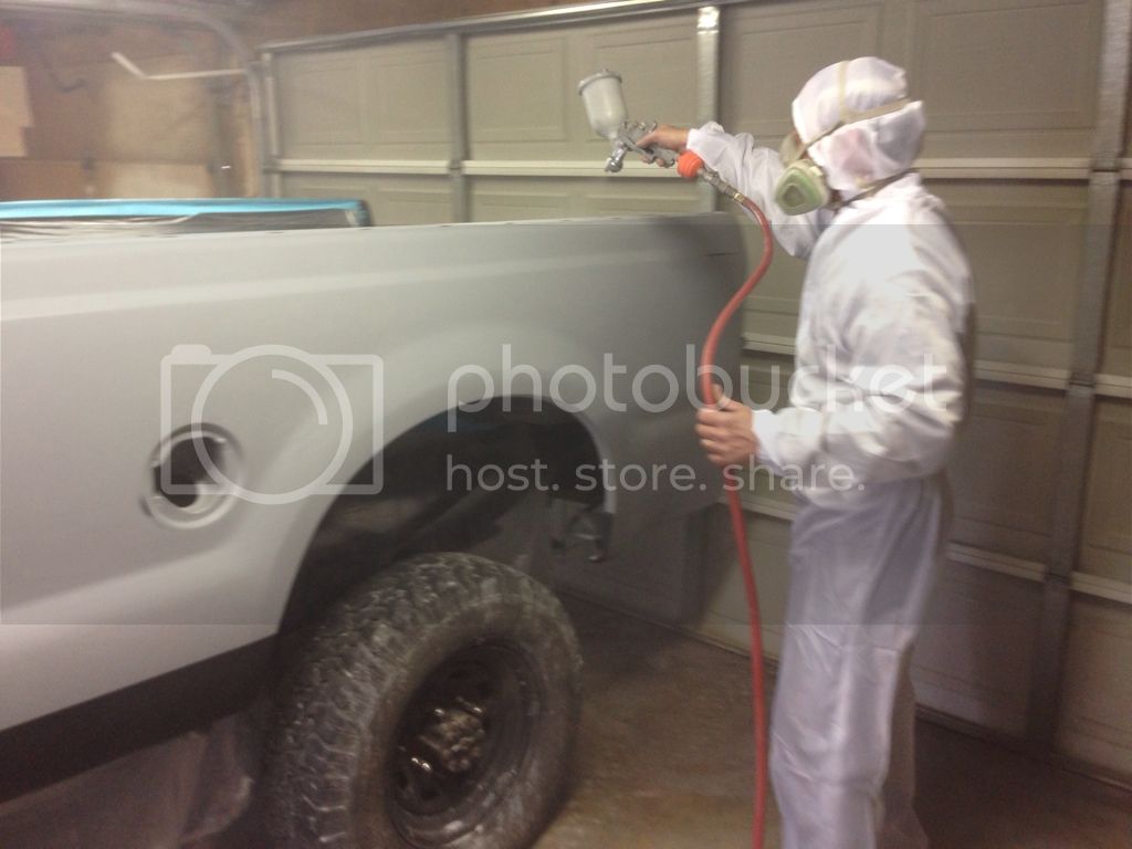

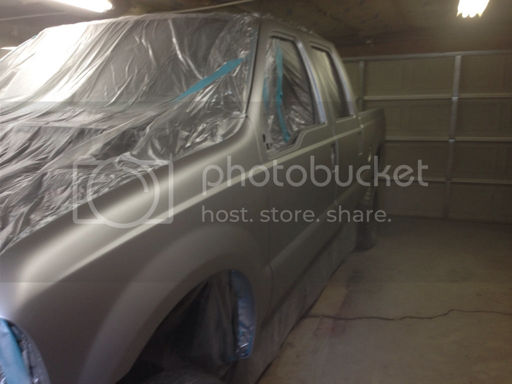

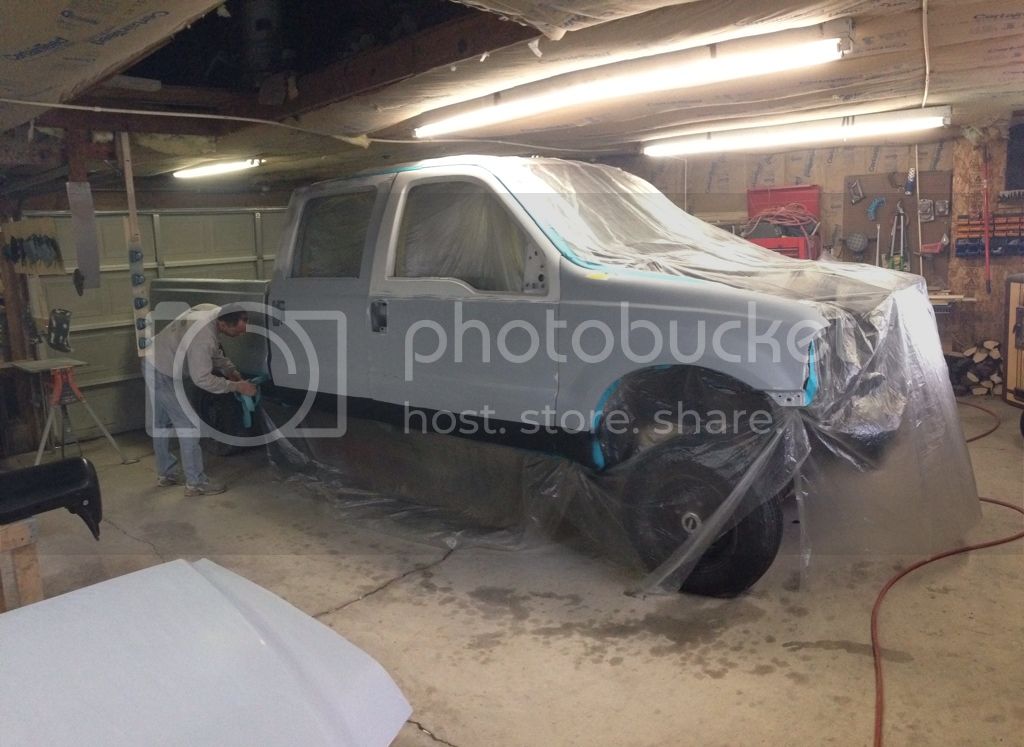

First base coat
Second Base Coat
Third base coat
Final Base Coat

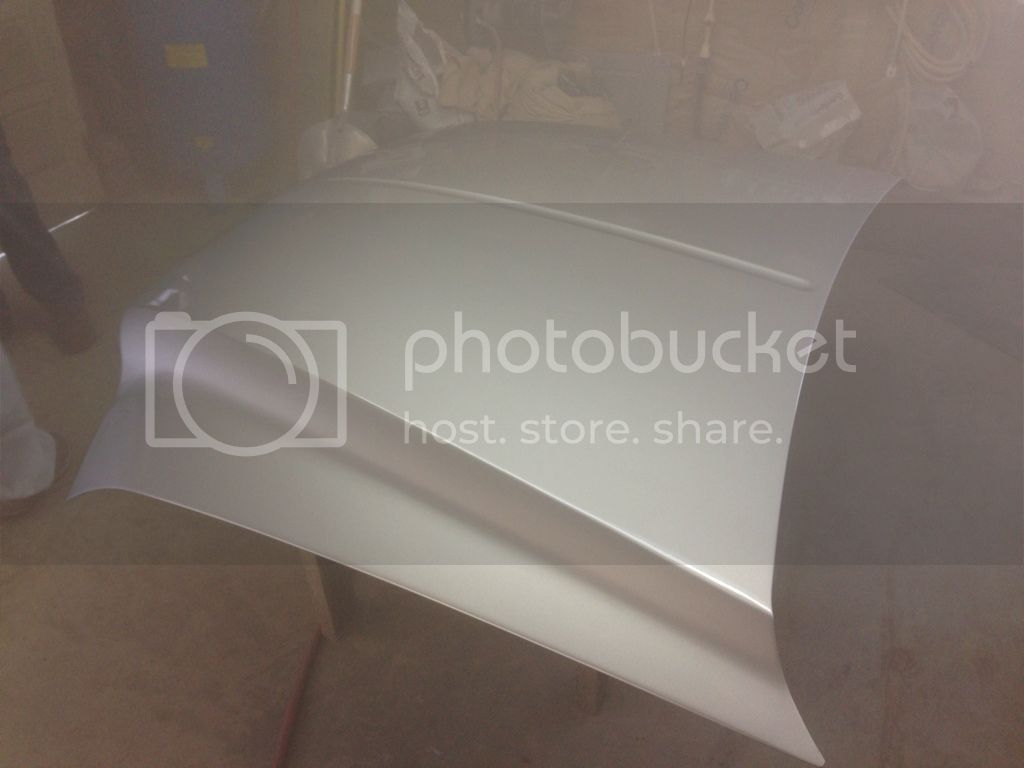

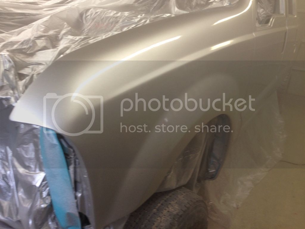

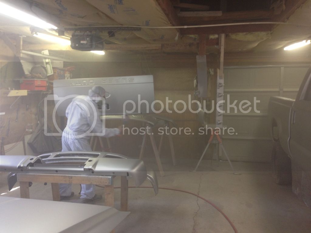

First coat of clear
Didn't get all of the texture out of them

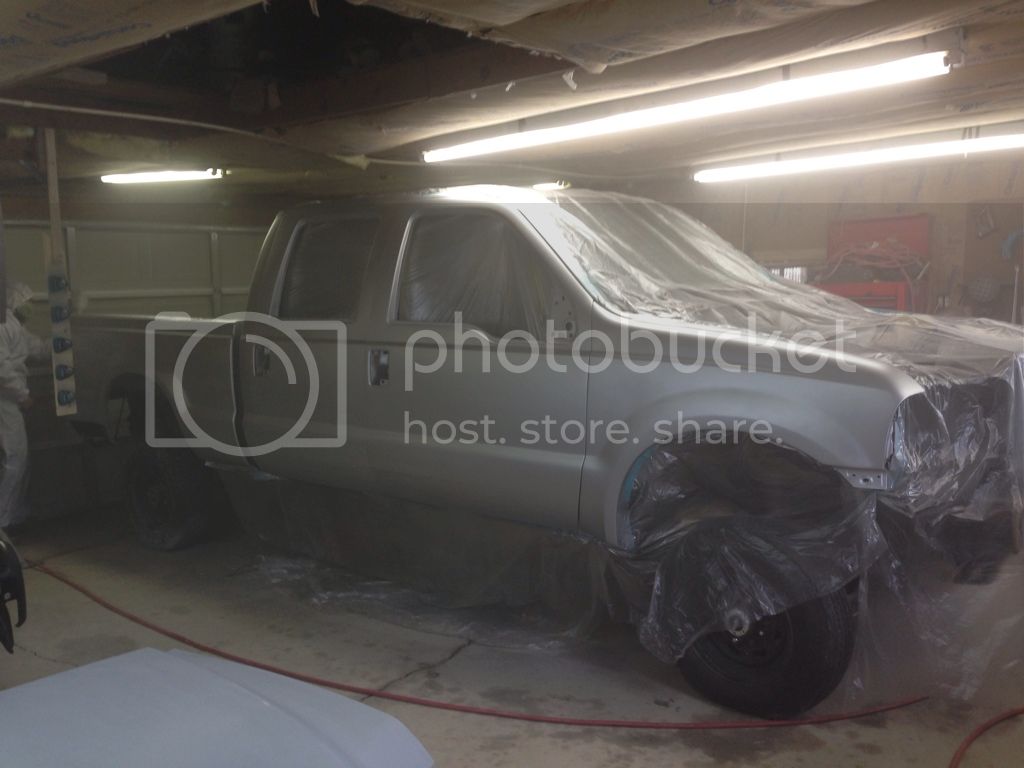

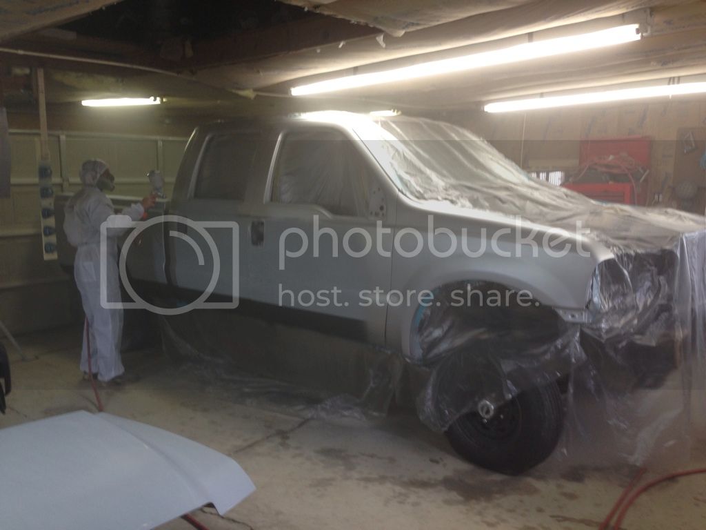

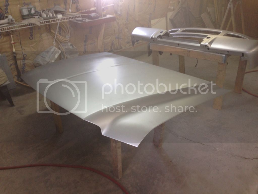

There are some things we need to fix. The roof needs repainted due to shot being on it from blasting along the window seal, the pass side front needs re sprayed because of paint lifting from poor paint underneath, and the hood needs buffed due to water falling on it from the air fitting on his gun.
