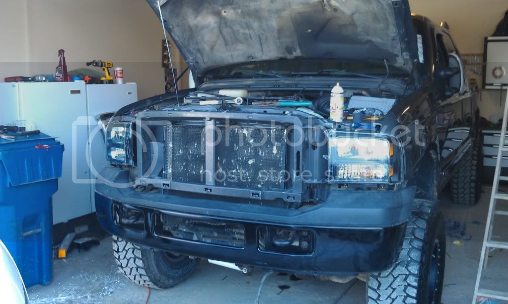

The plan is to have the whole front end black with Harley headlights and if I get hid fogs I'll probably take a stab at tinting them. I've always loved the black Harley front

I have a question though, I got my headlights and they have this silver clip thing under the lense
Anybody know what this is

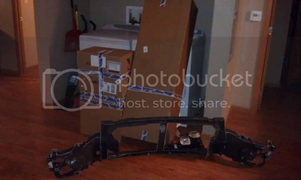

well i still need to order the harness for the headlights. i forgot all about it. would it be cheaper to just get PDP's conversion harness.
If your thinking about doing HID's in the future do them now, and BAM there's your conversion harness. Since HIDs come with a new harness for the headlights anyways. You order your HID's with a harness for a vehicle with 9007 plugs (which is what you have) that changes over to an H13 bulb (which is the type of bulb the 05' headlights take).

Well thanks to pure diesel power I can get my front end on the truck today. Got the conversion harnesses for my headlights in a very quick manner. The only thing I have left to get is the ford emblem
