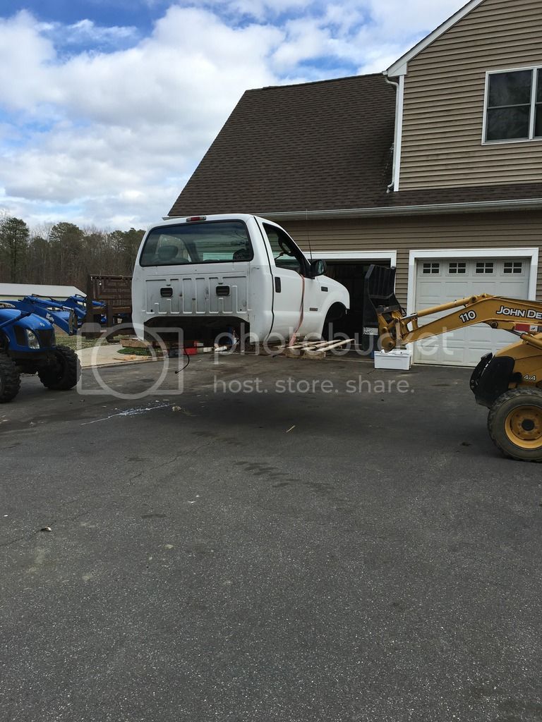

The only extra work is swapping in a shorter fuel tank, a short bed fuel tank will hit the transfer case, I used an f150 gas tank in mine.
We used a short bed 6.7 tank.
Did you have to cut any of the frame behide the wheels? Or just from behide the cab?
