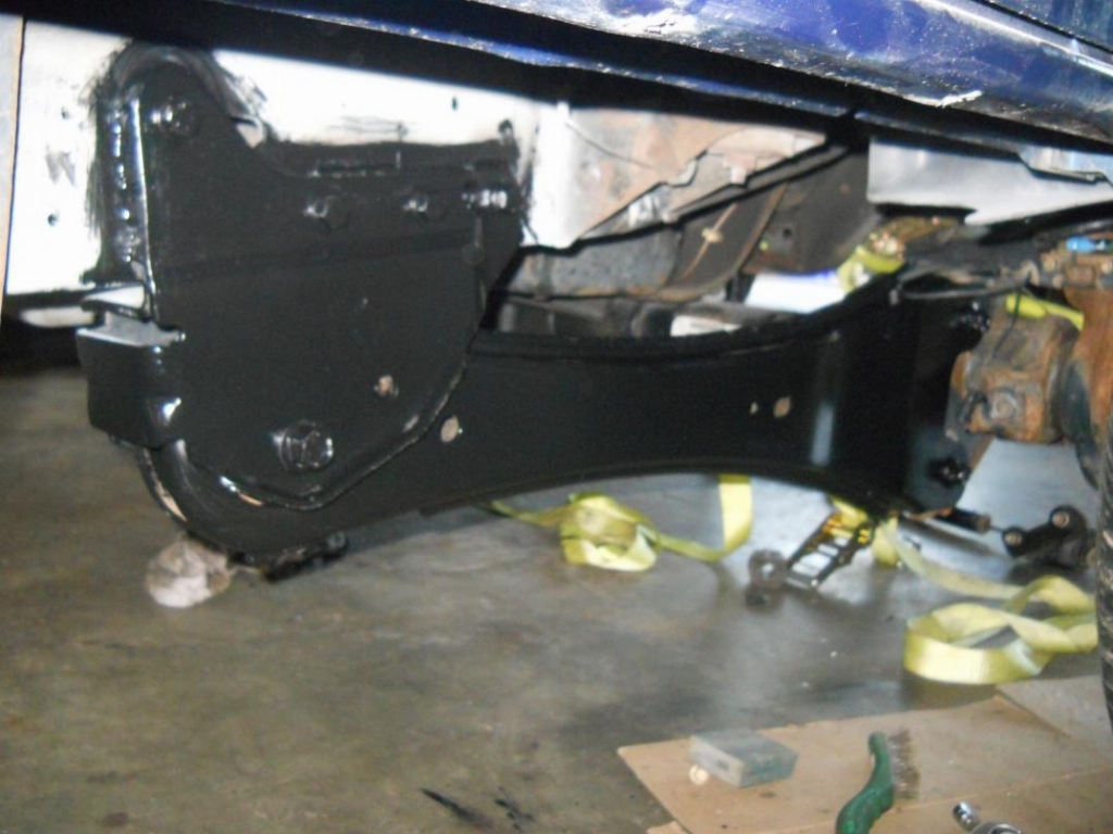

GOT MY COIL BUCKETS INSTLLED AND TOURQUED DOWN. ON THE HOLES THAT I COULDNT GET A BOLT THROUGH I TAPPED THREADS INTO THE FRAME. AND AS ALWAYS I STICH WELDED THE BUCKETS INPLACE. ALSO THREW IN 5 SPOT WELDS. DILLED A 3/8 HOLE IN THE BUCKET, WELDED IT TO THE FRAME AND THEN WELDED THE HOLES UP. THAT THING ISNT GOING ANYWHERE. ALSO MOVED THE BRAKE LINE BRACKETS DOWN 2" TO GIVE THEM A LITTLE MORE PLAY WITH THE SMALL LIFT, DIDNT HAVE TO, JUST FIGURED I WOULD

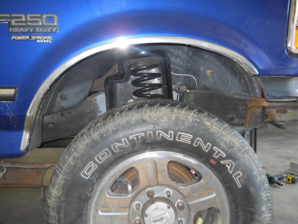

GOT THE COILS IN, AND I HAVE IT SITTING AT THE HIGHT THE 2.5" LIFT WILL GIVE IT. SHOULD B PLENTY OF CLEARANCE FOR THE 35"S
ALSO THREW SOME WELDS IN THE RADIUS ARMS, IM STARTIN TO LEARN PRETTY GOOD HOW TO WELD THIS THICKER METAL WITH THE MIG, I HAVE ONLY EVER USED IT FOR SPOT WELDS AFTER SPOT WELDS AND SMALLER METAL

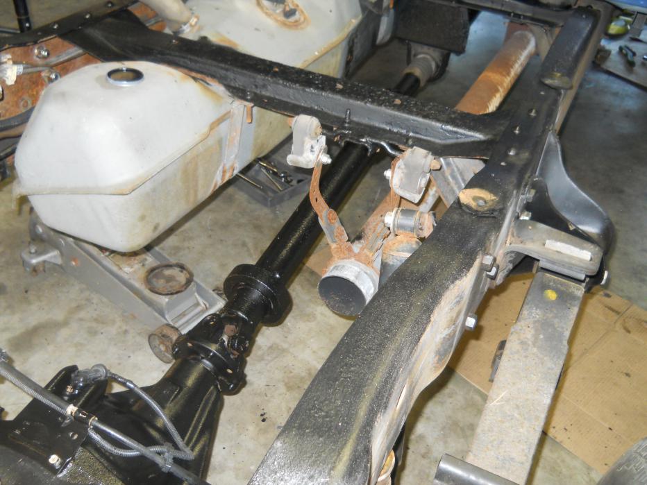

GOT THE TOP OF THE FRAME RAILS PAINTED AND THEN I HAD TO USE UP SOME (I WAY OVER ESTIMATED WHAT I NEEDED) SO I PAINTED THE RADIUS ARMS AND THE DRIVE SHAFT AND PART OF THE REAR. IM GONNA PUT THE BED BACK ON AND SPRAY THE REST ON A LIFT.

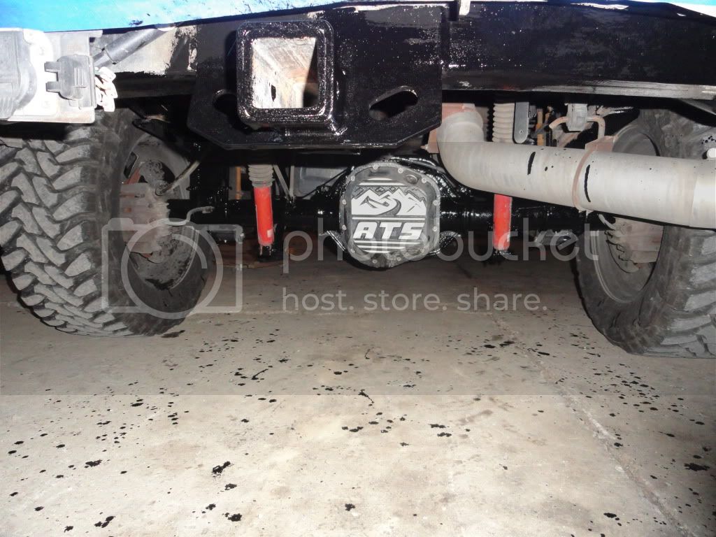

Here are some pics of my build back in January of 08. I did a complete 05 steering/suspension swap, a 98% bolt on job

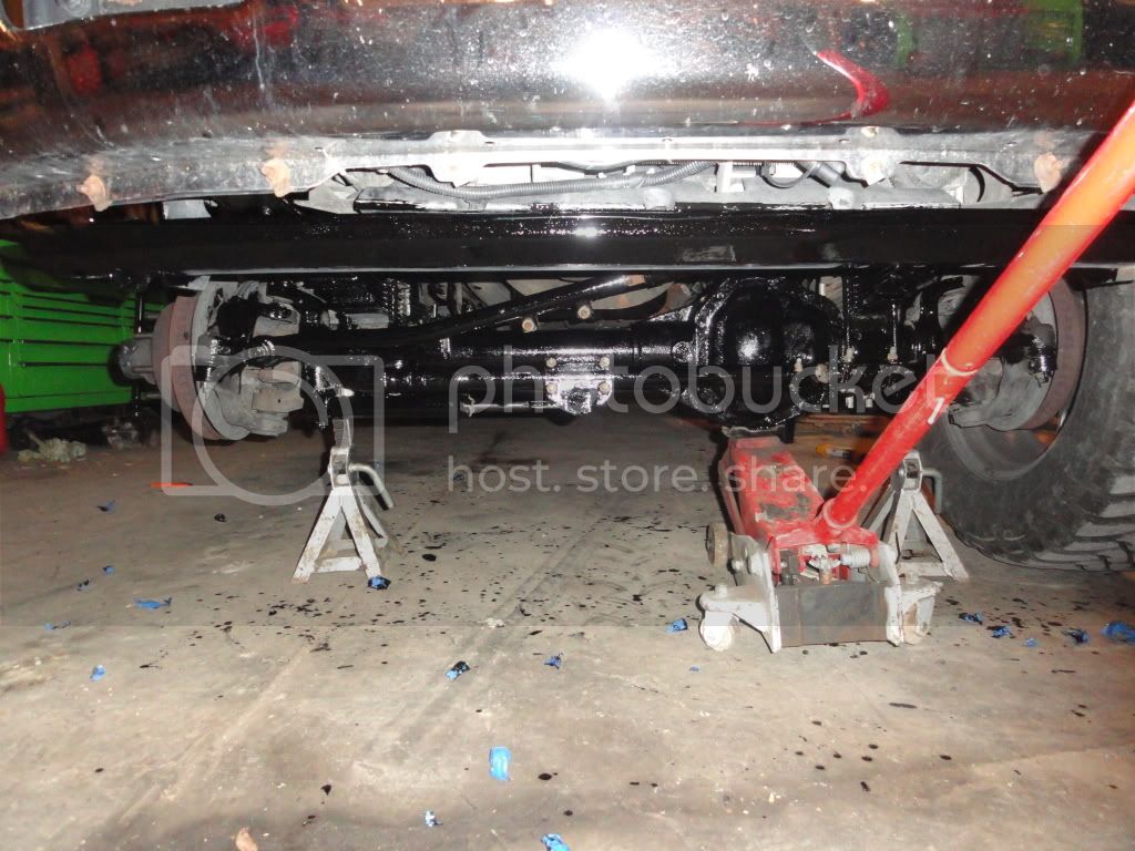

Ive used it on two of my trucks and it holds up great, just gotta top coat it
On my 6.4:
and my 6.0
