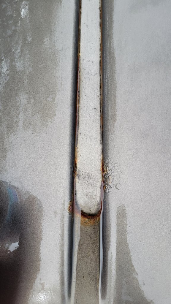

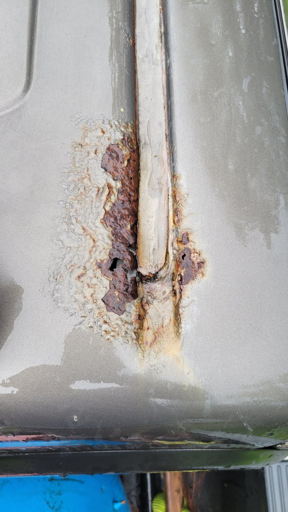

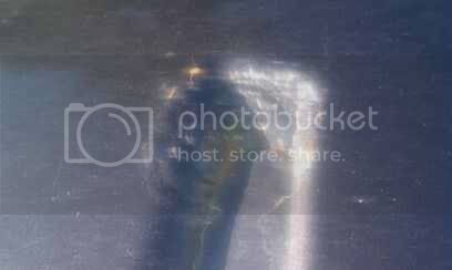

jonnysteals
125
Heres pics of my rust. ANy ideal on how to fix this is appreciated
