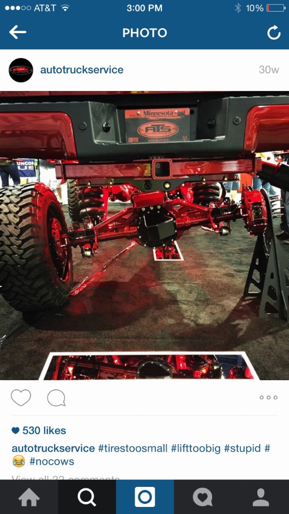

Yeah but if you saw it in person I bet you could see why
Oh, I have no doubt the value is there. Looks like a work of art! I wonder how it would look from the rear with a roll pan? The filler behind the license plate would be trick too.
Sent from my Note 4 using Tapatalk
Six_Sloww
Dec 5, 2013
2,574
Southeast MI
There's an example of it peeking under a hitch
Mudstomper99
Mar 20, 2015
219
Bad ass design but that's not in the budget! My wife would kill me! Thinking about welding up my own just not with all the fancy skid plates

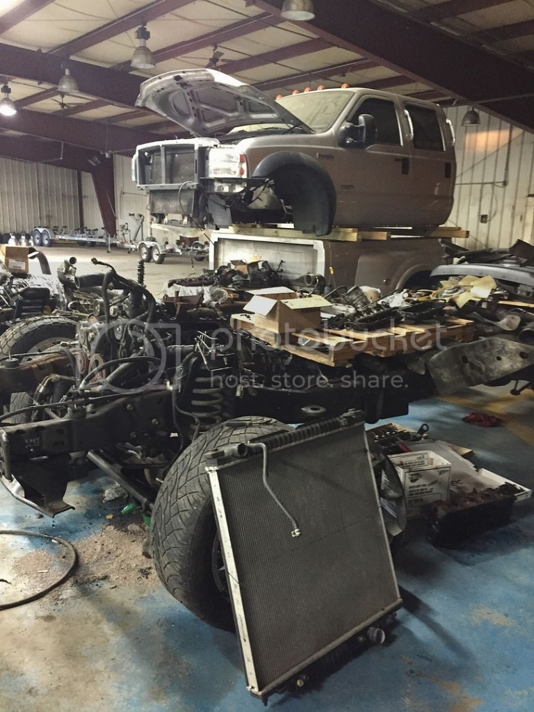

Tore top half down looks like I have a well maintained motor still has great cross hatching in the walls very clean inside.
Mudstomper99
Mar 20, 2015
219
Picked up my heads today from the machine shop and good to go back on! Just need to find time to slap it together!
