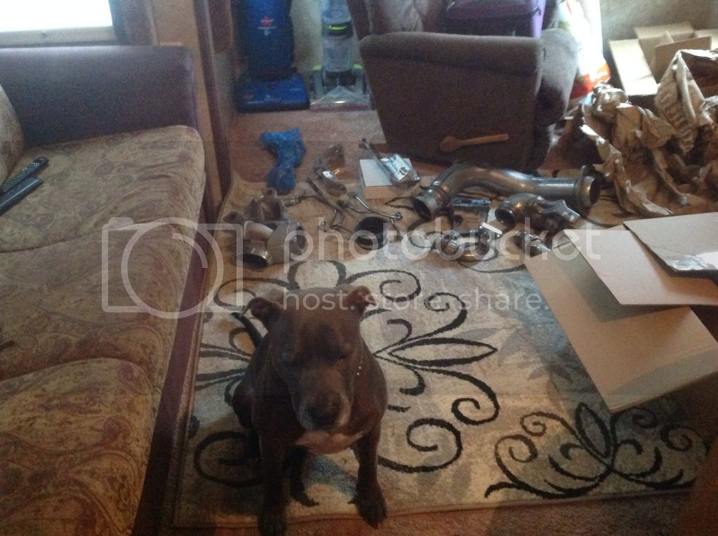

Up pipes are replaced, down pipe is replaced as well. Here is a pic of mine. I believe one manifold and both up pipes are replaced, feed lines, pedestal, and yea idk the names of others.
Disregard all the background crap and the dog LOL
