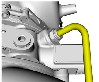

ahh ok, I was assuming it was build date related.
It mentions using the large 3 digit code number on the breather to determine what turbo it has, it's either a "412" or "416". what seems odd is that the 412 is the new fittings
for those that aren't familiar, you can see the difference on the coolant line in these pics.
coolant lines or oil lines?
