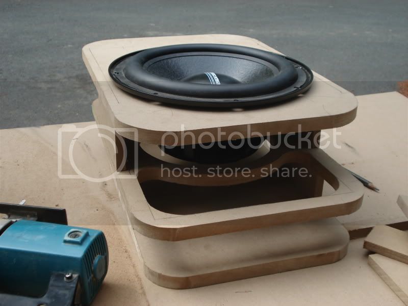

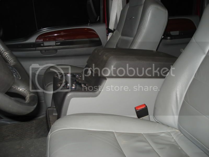

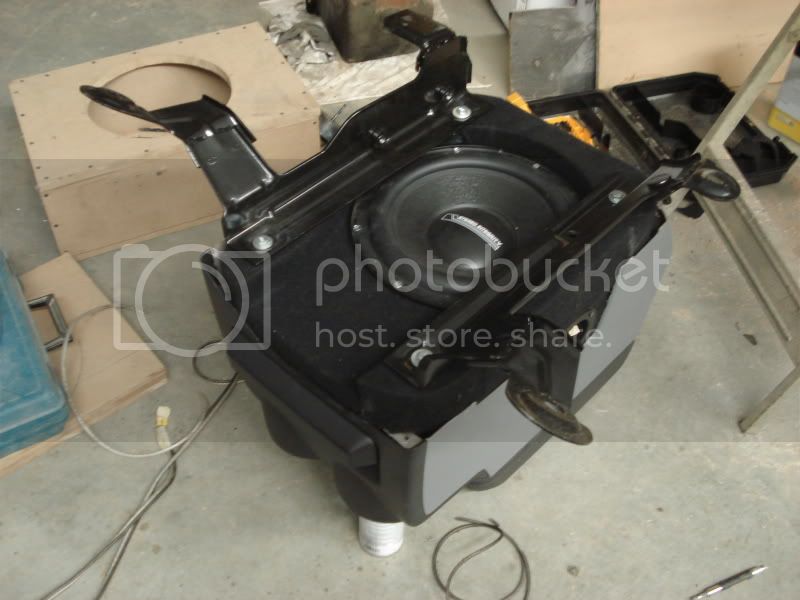

Here ya go...
Sits a touch high (same height as the 40/20/40 console it replaced) but I like it and I could drop it 1.5" easy if I wanted.
The side no one sees...
and the guts for proof its all in there. Pardon the fugly fiberglass work :fustrate:
Skeleton all out of 3/4"
I still have 4.25" of storage space up top, box comes out to be about 0.93ft^3 (accounting for wood displacement, but before sub) and 7" of mounting depth (key right there) The sub is a Stereo Integrity Magnum version 4, its a 12" XBL^2 sub rated for 1000w RMS and a 1ft^3 box, 5.5" of mounting depth, 20mm 1-way xmax and is SUPER crystal clear. I'm powering it from a Sundown Audio Saz-1500D

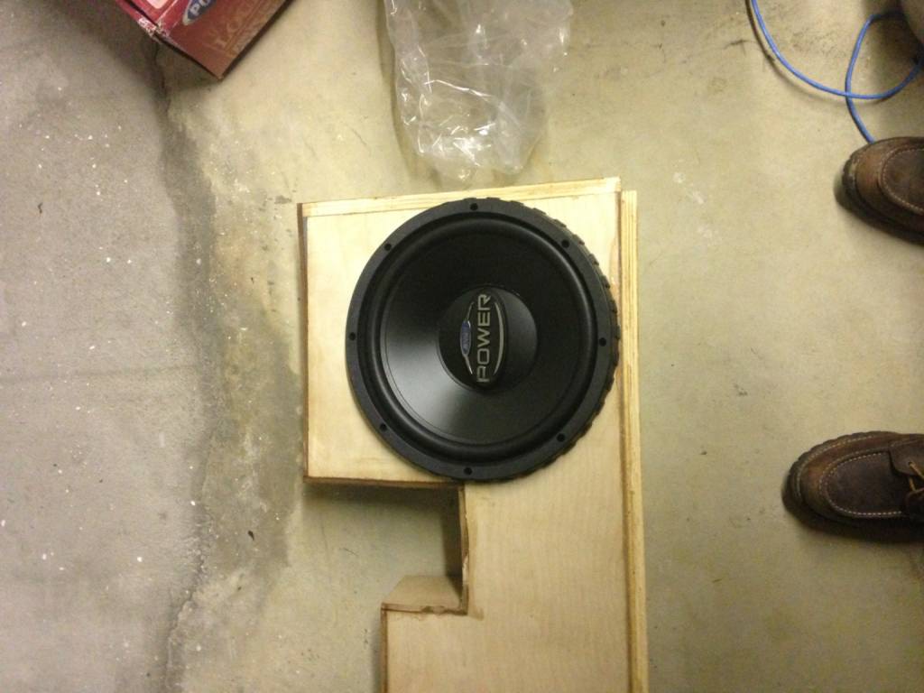

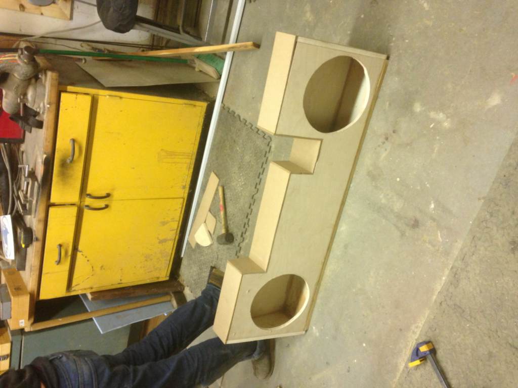

Started this tonight. Will most likely have it all installed tomorrow. I'm gonna be running factory nav and speakers until I decide to upgrade. ImageUploadedByTapatalk 21360301586.218648.jpg

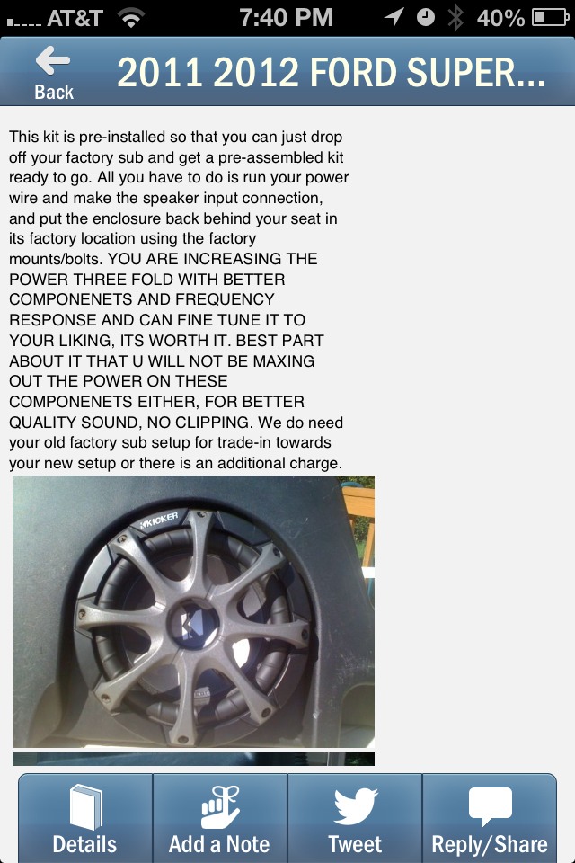

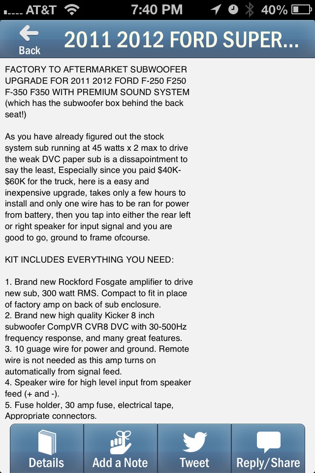

I had made up my mind on that dual 12 box or the single 13 jl and then I came across this on Craigslist. It's only $495 and then you stock sub for a core. Might be good enough to tide me over till I'm ready to throw more money at it. What do u think?
ImageUploadedByTapatalk1362012154.200219.jpgImageUploadedByTapatalk1362012161.557802.jpgImageUploadedByTapatalk1362012170.180703.jpg
Bigdiezel
Jan 1, 2013
68
Tapping into rear right or left speaker probably won't pick up a bass signal , and if it does it will most likely be weak signal . You would have to pick it up from the wires feeding the OEM sub.

I f that is the route you wanna go, why not just build the setup yourself? Sub is like 70 bucks and amp is like 140 off eBay..
