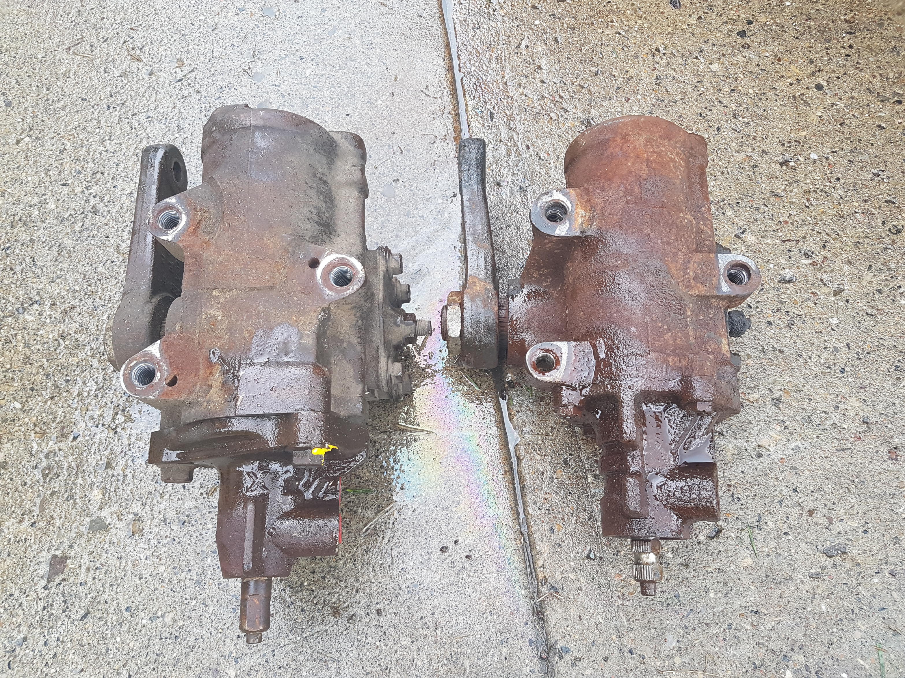

1) There was an upgrade to the Superduty 250 and 350 steering boxes in 2011. The 2011 box is much larger. Ford replacement Superduty boxes are very expensive. I got a good used box from a wrecker.
F450 and 550s use a completely different steering box. It is much larger than any F350 box.

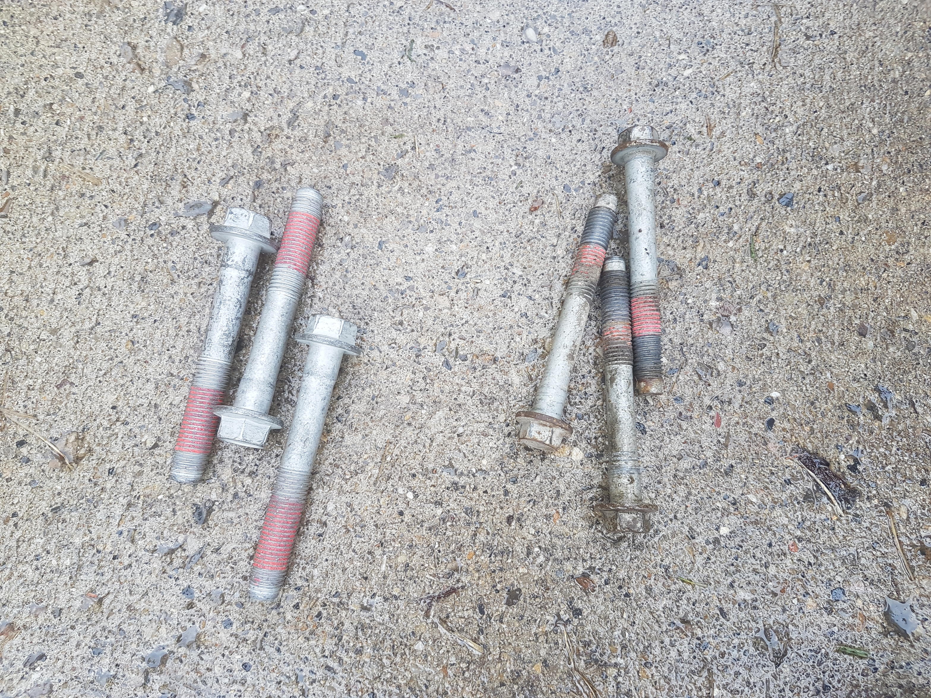

2) The 2011 steering box bolt pattern is identical to the 2008. However, the bolts are different. The 2008 box uses M14 x 120mm. The 2011 box uses M16 x 120mm. The bolts are supposed to be replaced when the box is replaced. Ford sells them for about $5 each. They have blue thread locker on them.
The part number for the bolts for my box was W713909S439.
One dealer told me that the 2011 boxes use 18mm bolts. The dealer part listing has the size listed. I suspect he was looking at a F450/550 box, but who knows. Double check before using my part number.
I did not have to enlarge the holes in the 2008 frame to use the M16 bolts. But it is pretty tight getting them to line up.

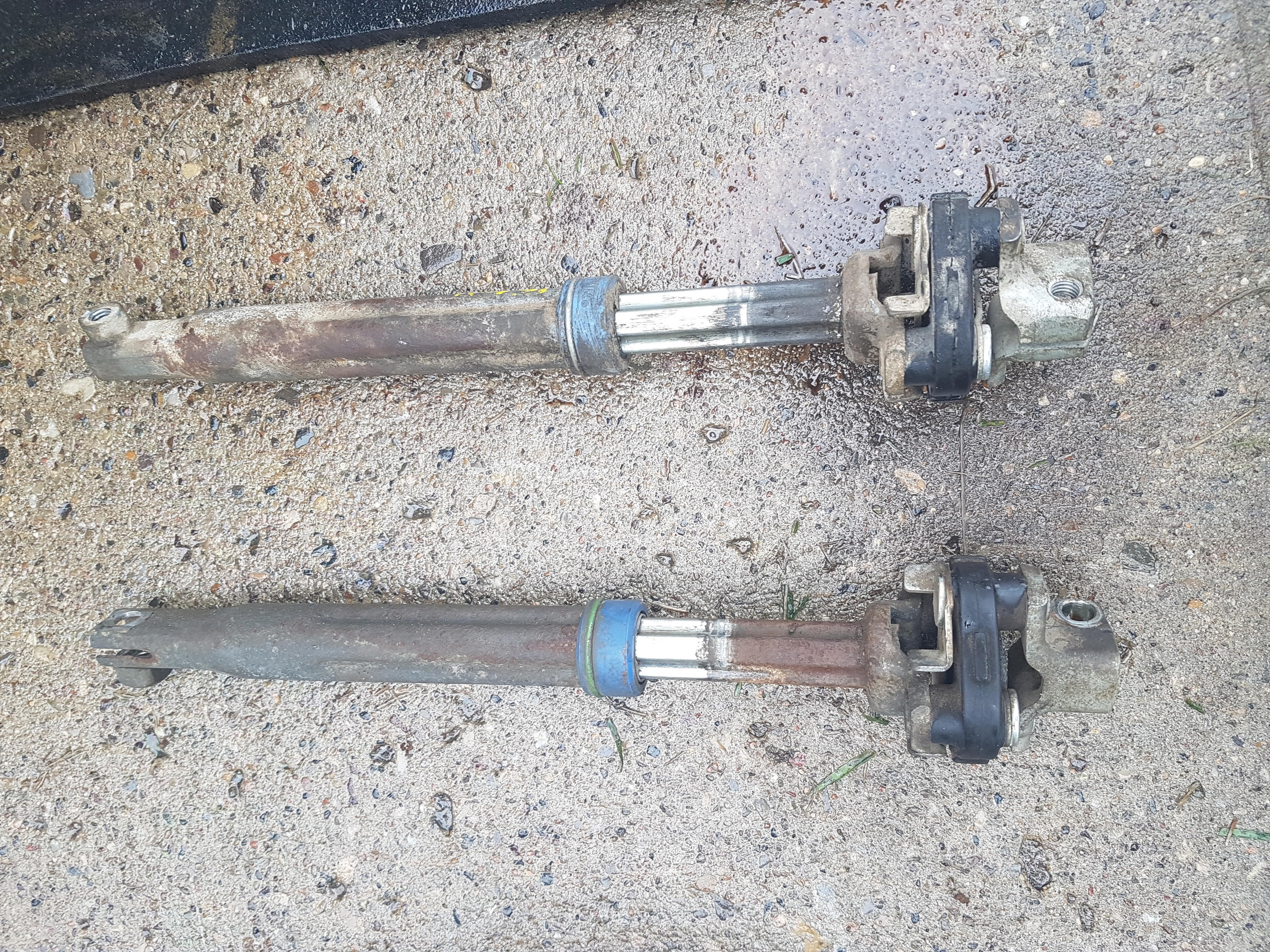

3) The steering input shaft is different on the 2011 box. The 2008 box has a splined input shaft. The 2011 input shaft has 3 lobes. The lower half of the steering shaft is interchangeable between the 2008 and the 2011. If you get a 2011 box from a wrecker, get the lower steering shaft that mates to it and swap it with the 2008 shaft in the truck.
4) The oil ports are the same on the 2011 box, but the are in a slightly different location.

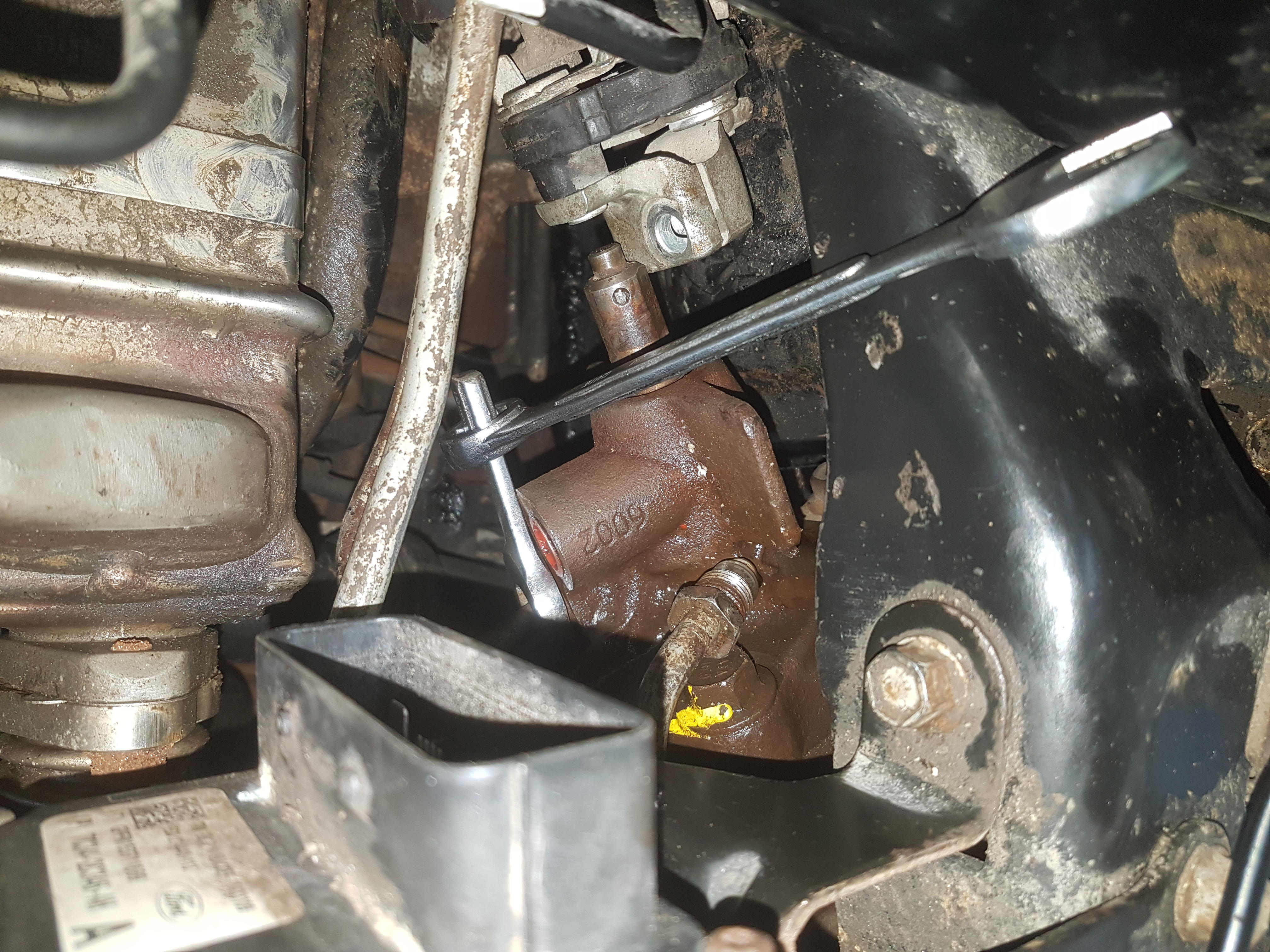

The pressure port is closer to the engine. I had to bend the line just a little bit to clear the EGR cooler and make it fit. Bend gently and a little bit everywhere so not to kink it.
The return line is a little closer to the firewall. I had to loosen the clips that hold the return line to the facia by the oil cooler and under the bumper so that I could get another inch of travel. It also needed to be bent just slightly.

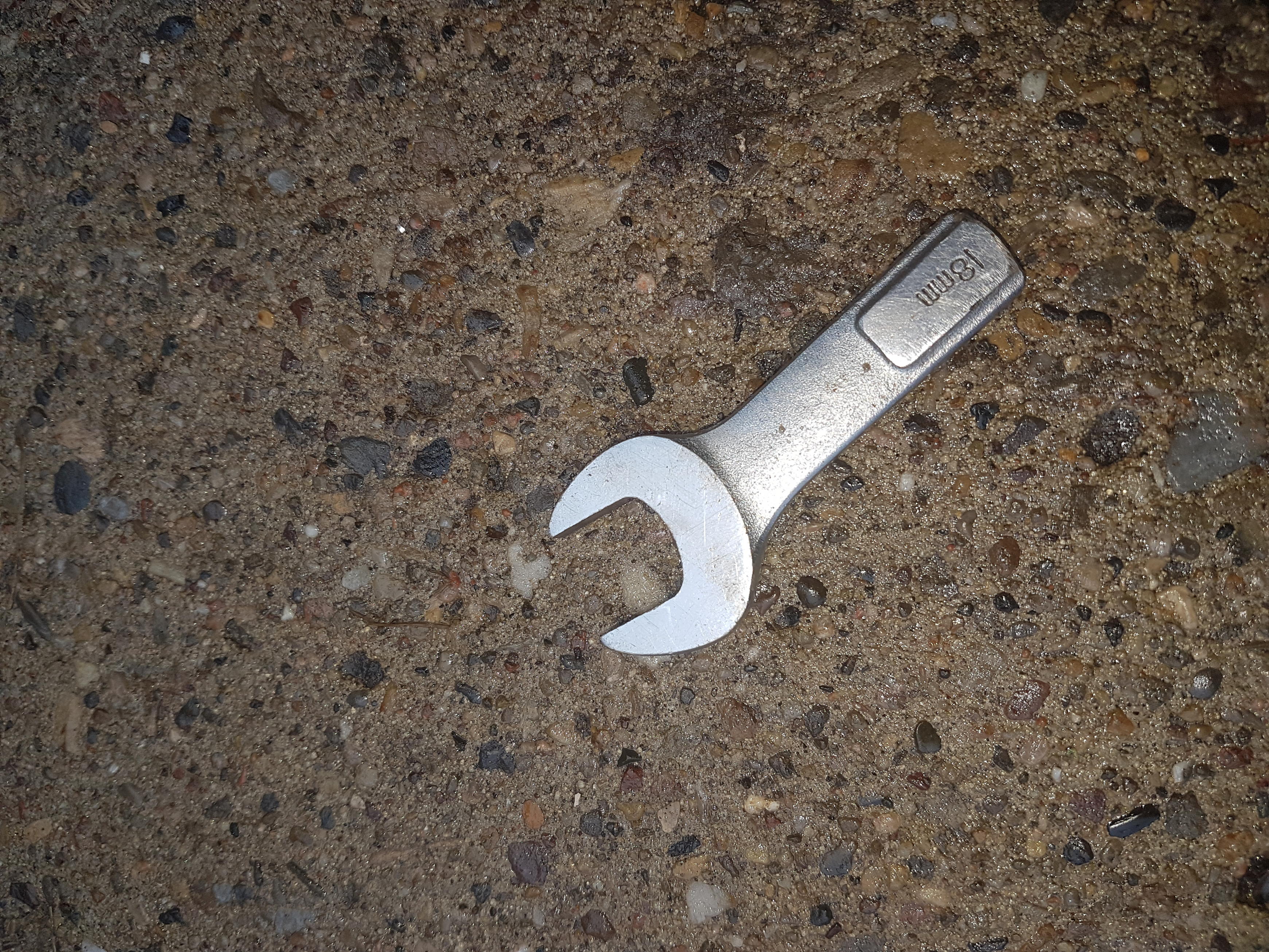

5) The 2008 oil fittings work with the 2011 box. The fittings are fairly easily accessible with an 18mm open end on the 2008. The fittings are really difficult to tighten on the 2011 box due to clearance issues with lines. I had to cut an 18mm wrench down in order to fit without interfering with the lines.
I used a cheater wrench on the cut off wrench to get the fittings tight. I inspected the O Rings on my fittings and found them to be good and reused them. Nothing leaks.

On second look at my pictures, I find that the pitman arms are not identical, that the 2008 arm is longer. I might try to swap the pitman arms.

I measured the pitmans. The 2008 pitman is about 5 7/8" center to center. The 2011 pitman is about 6 1/2" center to center. This should increase the steering cut for sharper steering.
