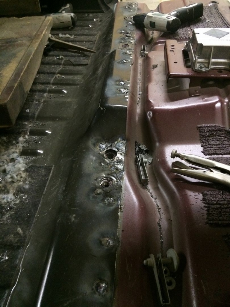

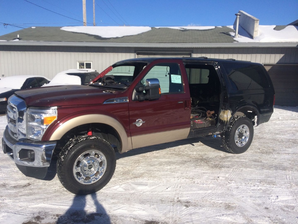

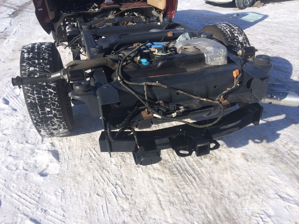

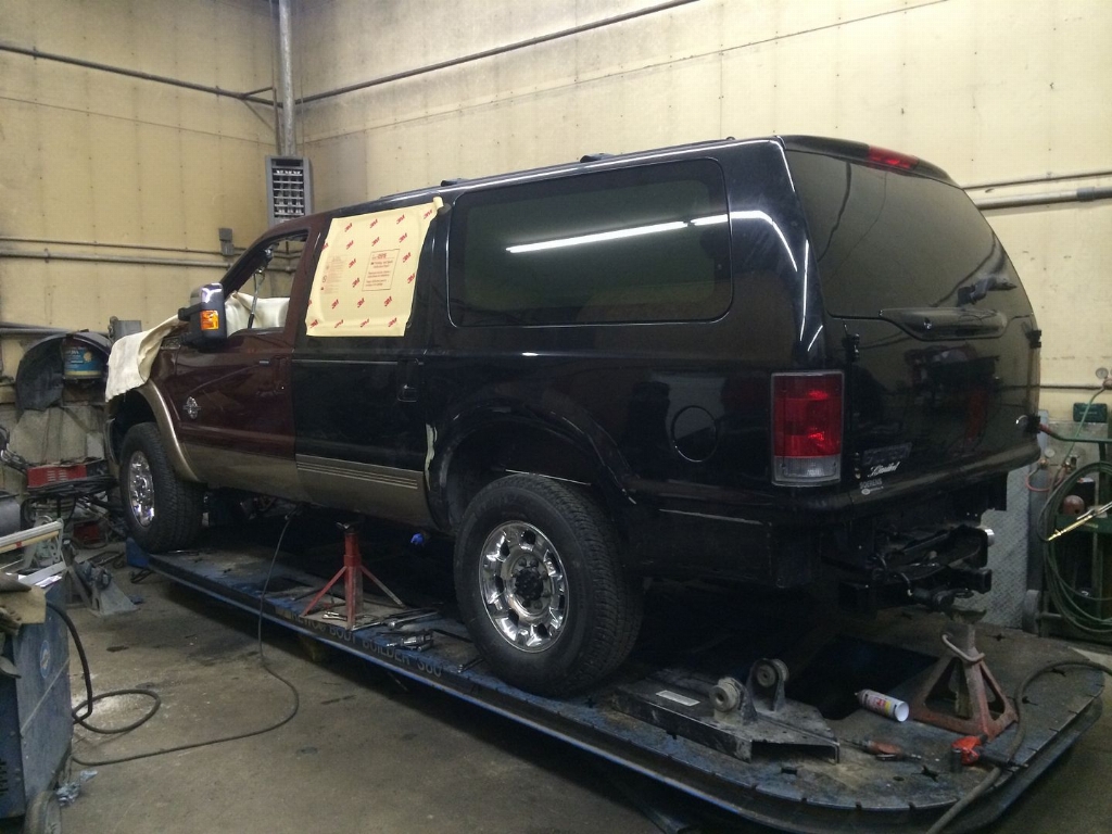

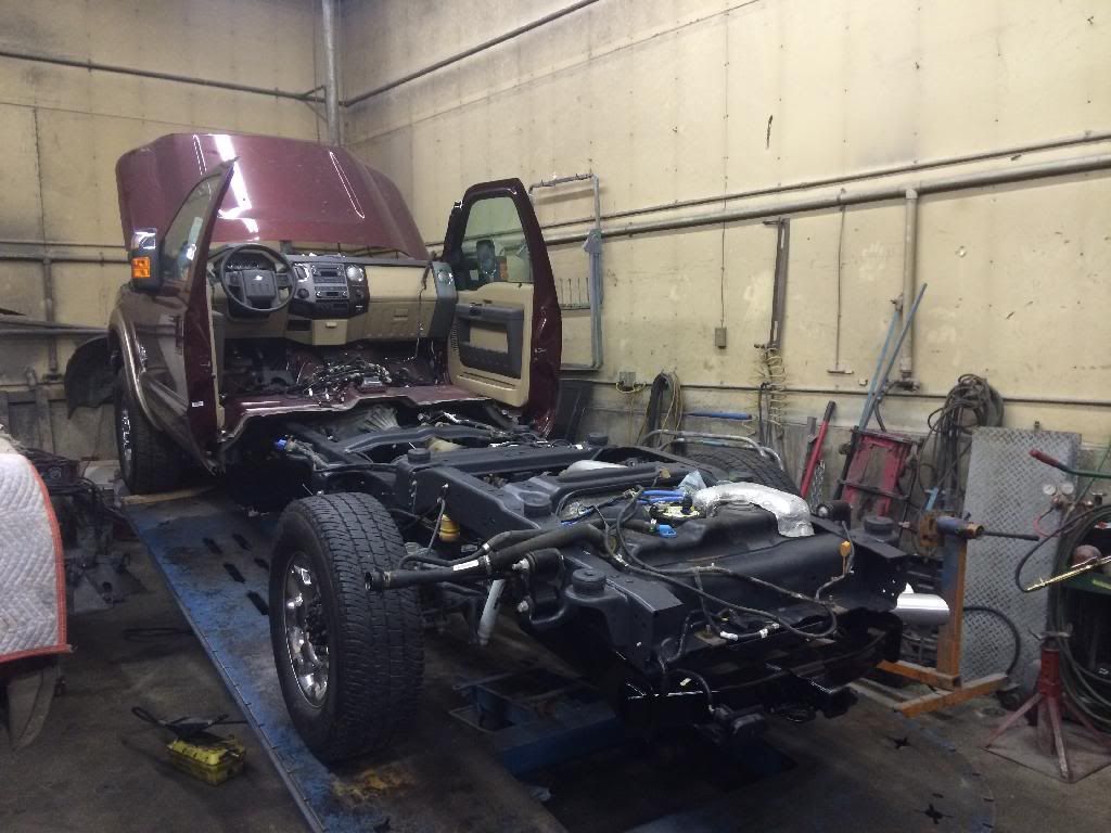

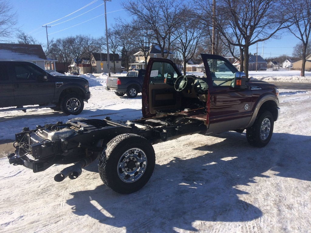

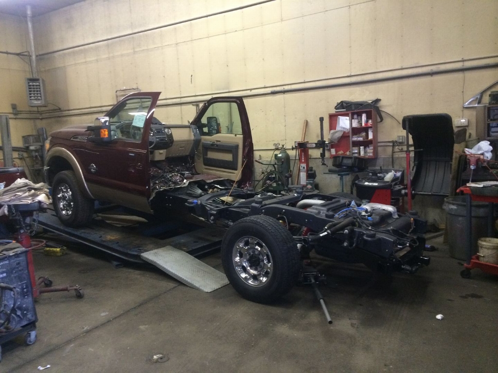

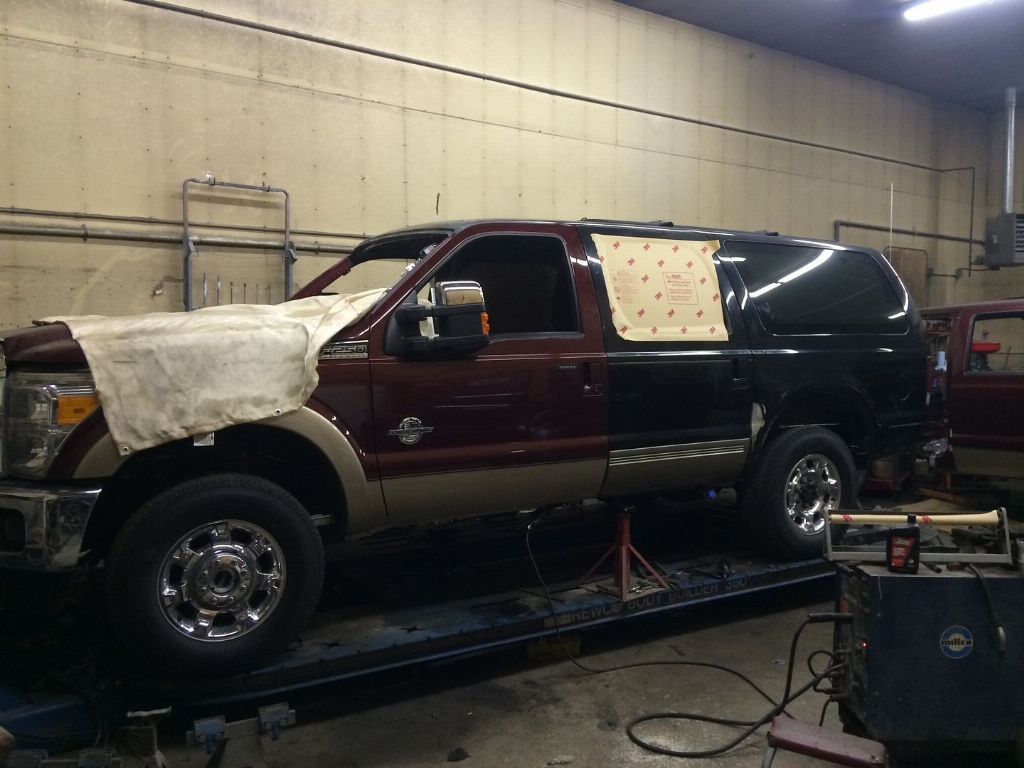

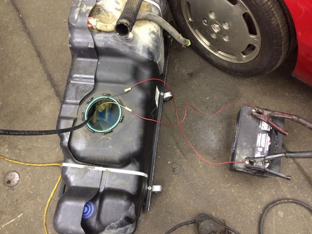

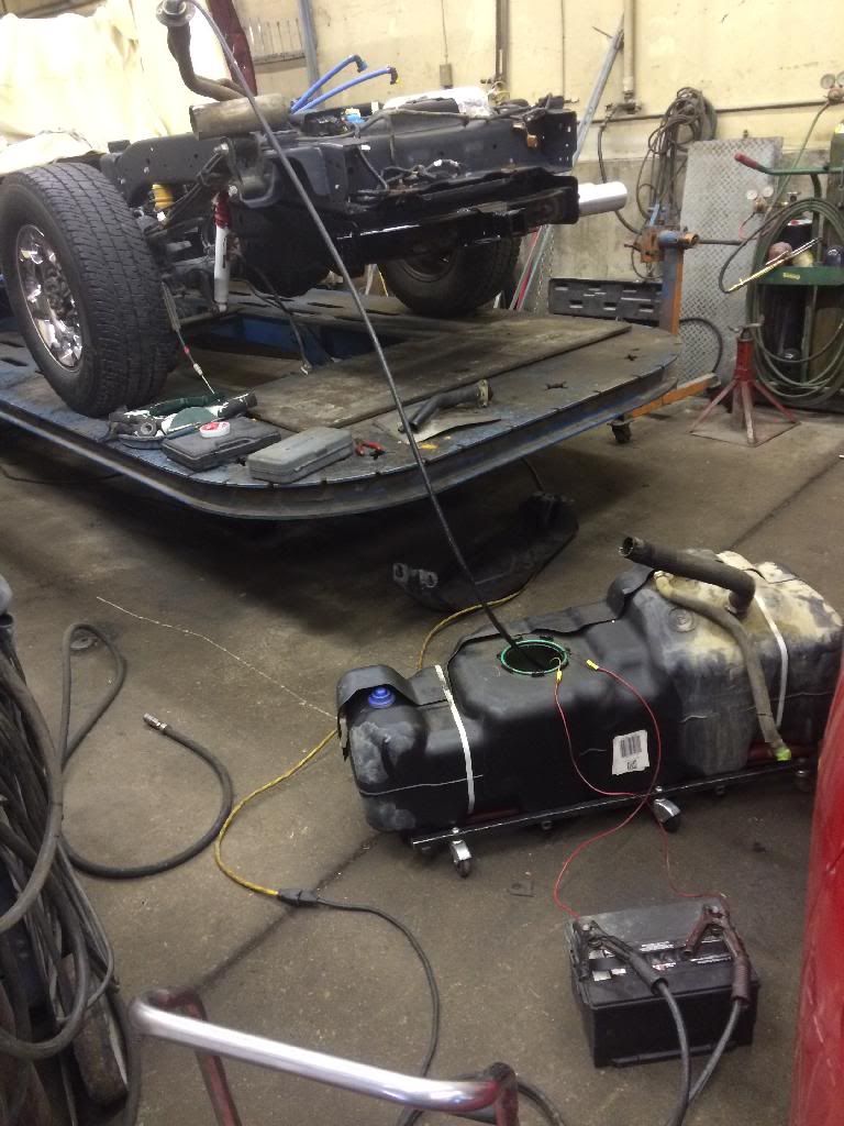

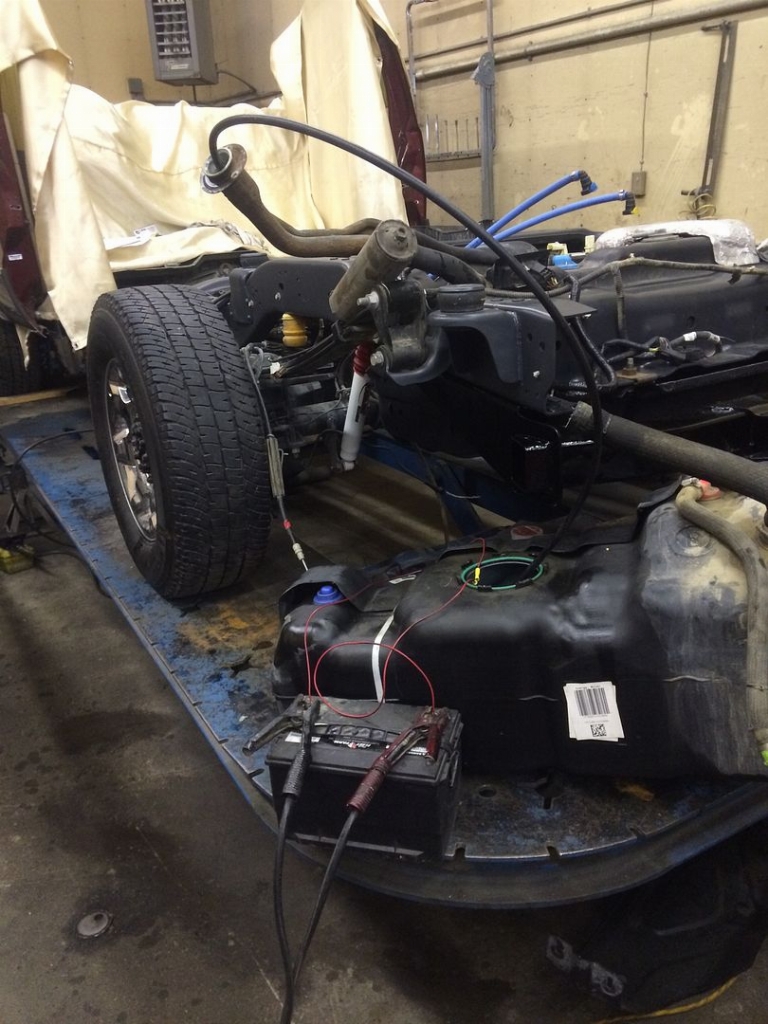

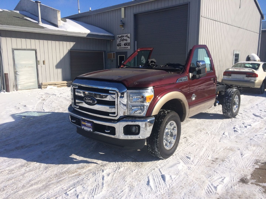

Everything all tided up. Used the V10 pump to transfer the Diesel from the 12 tank to the ex tank, swapped the filler necks and tubes. Got the 12 Excursion running today. Tomorrow but on the body and do the parking brake.
Jan 27, 2014
146

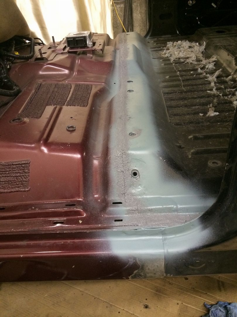

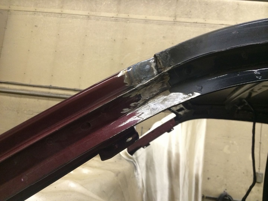

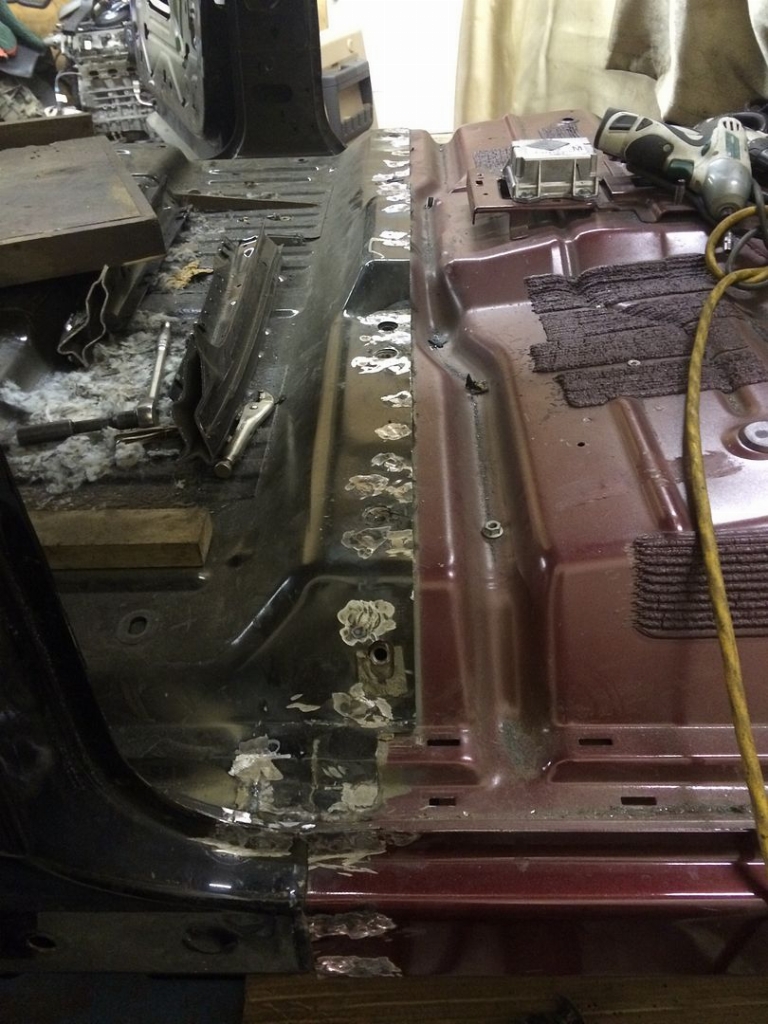

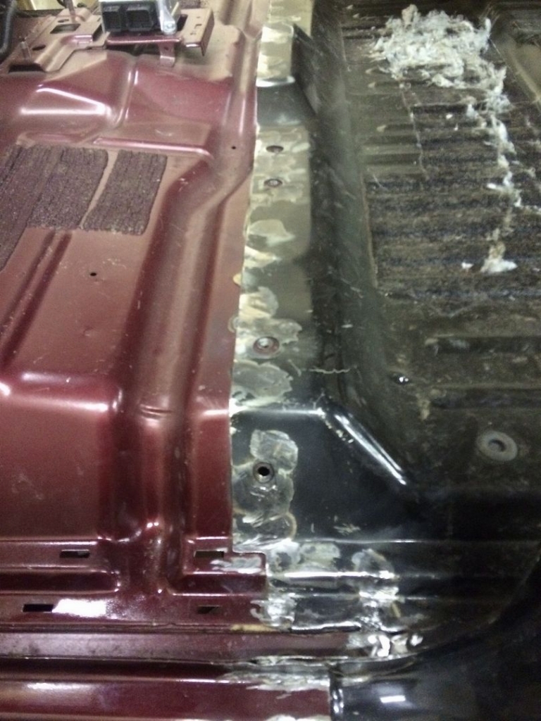

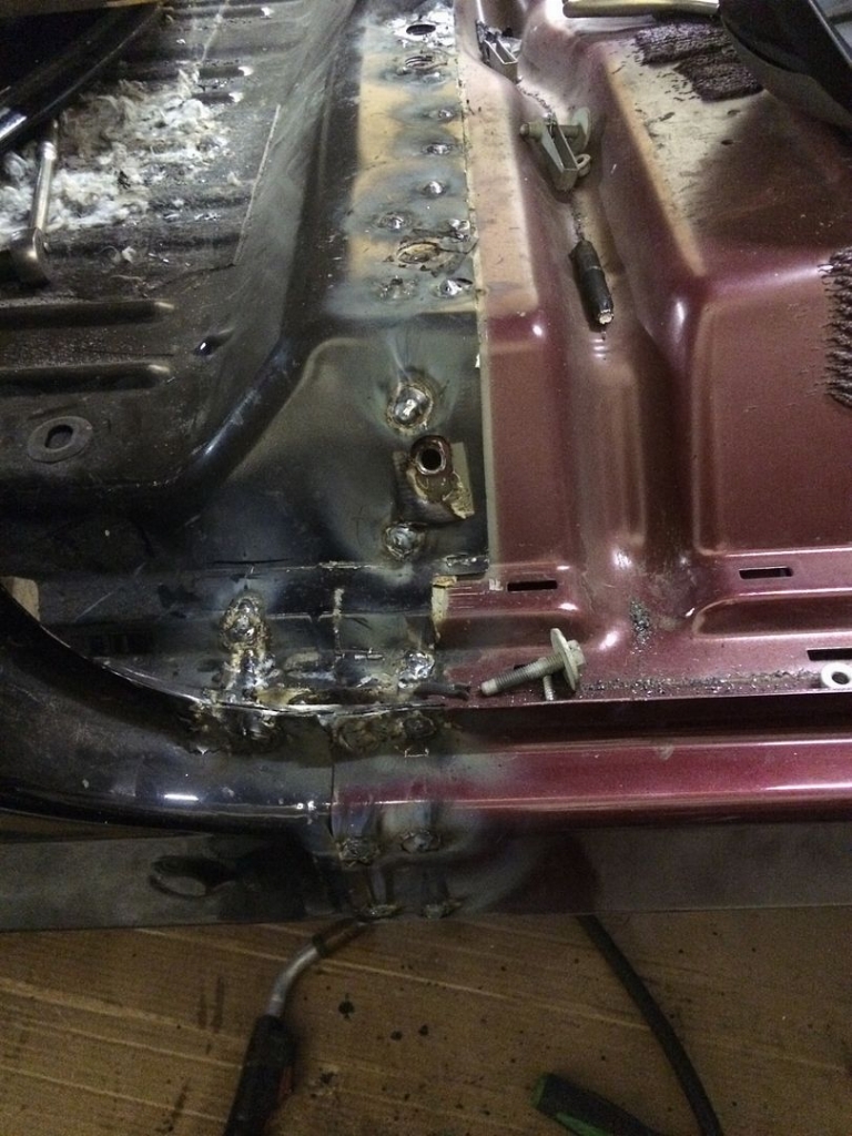

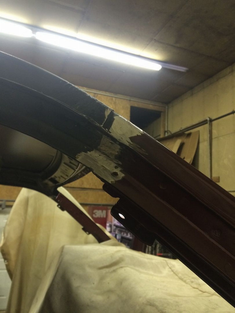

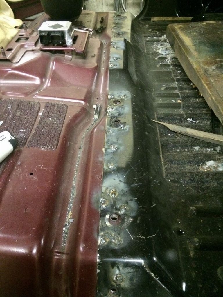

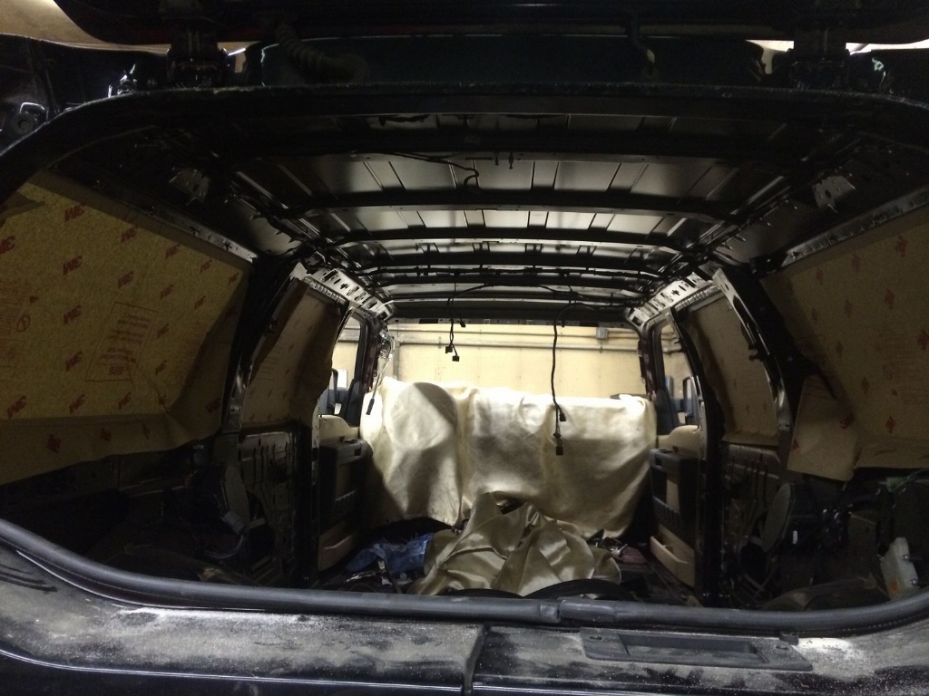

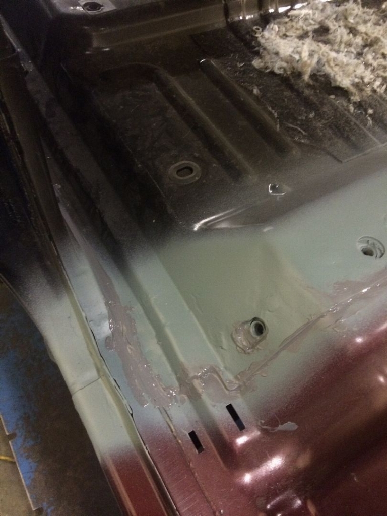

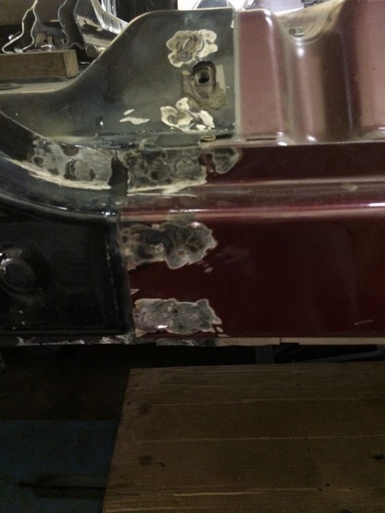

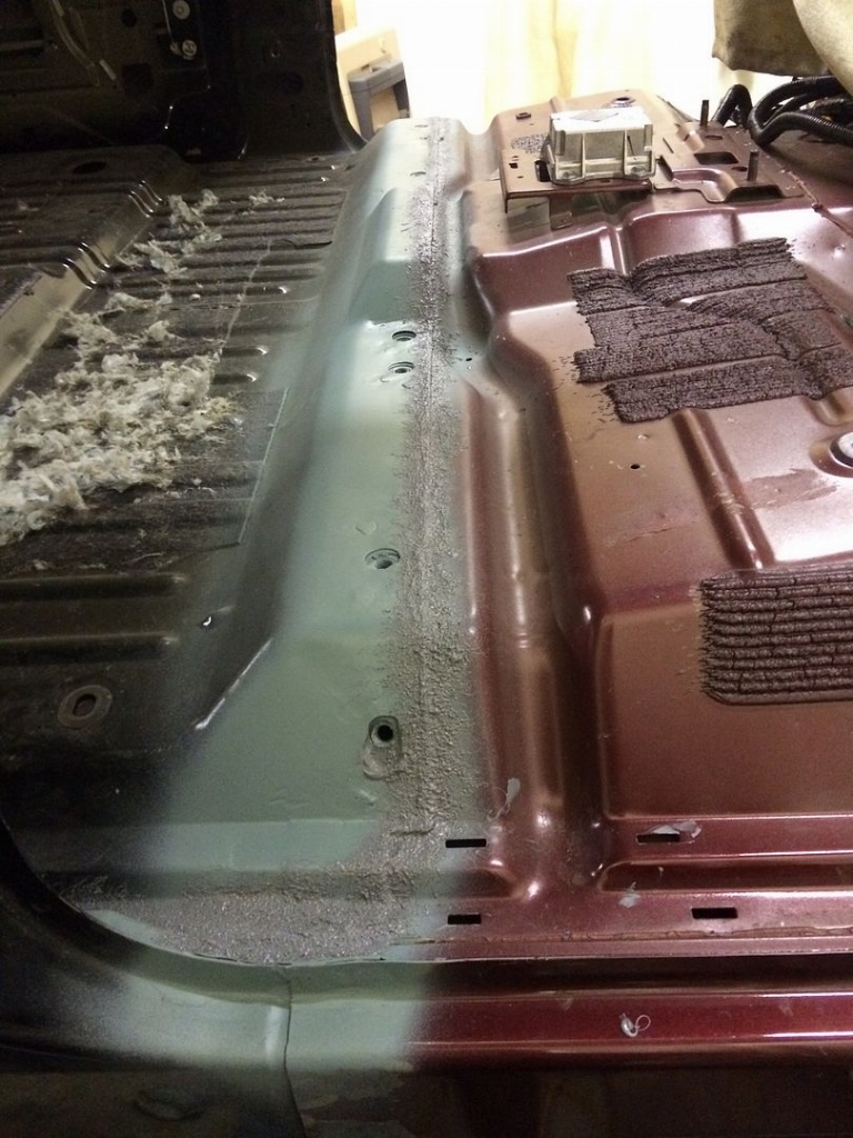

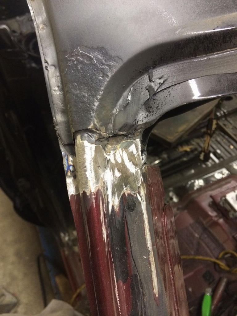

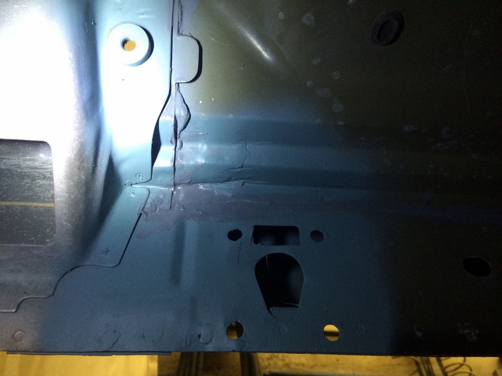

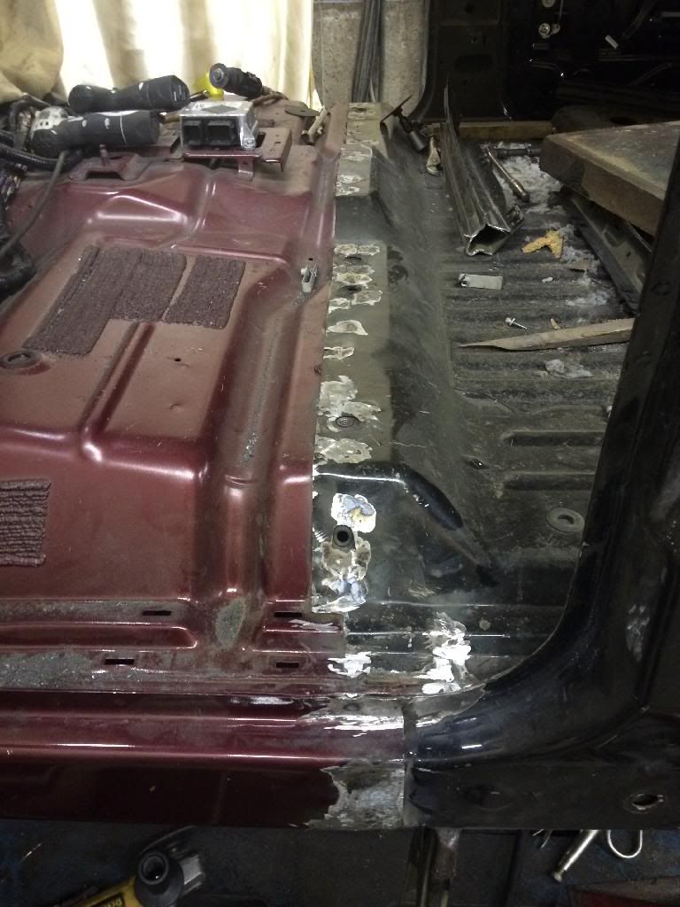

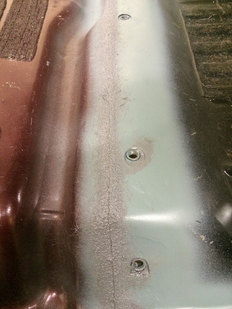

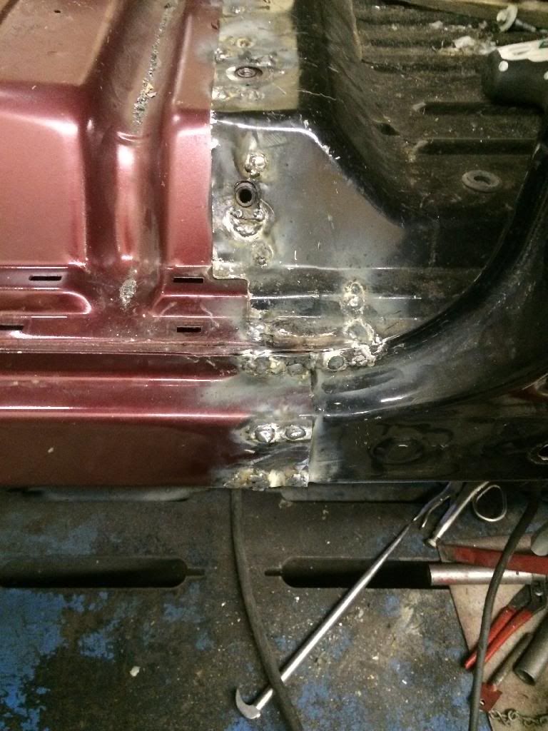

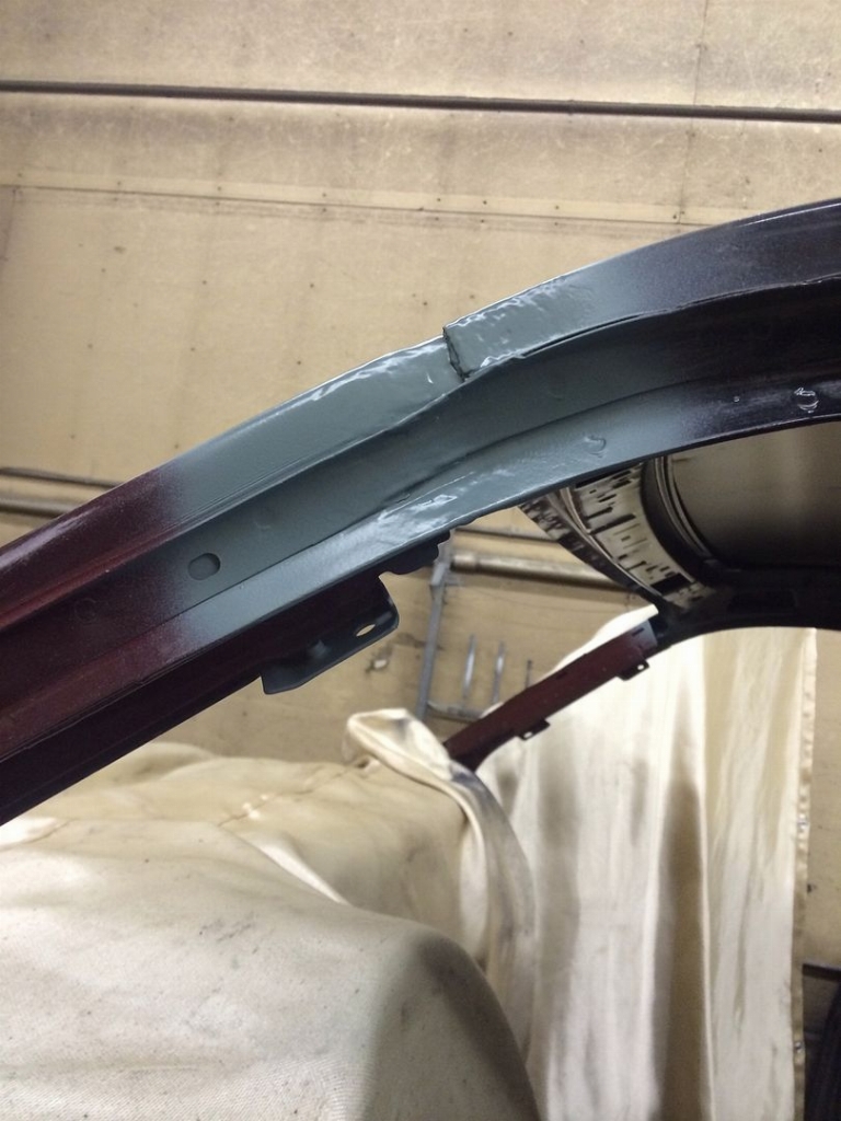

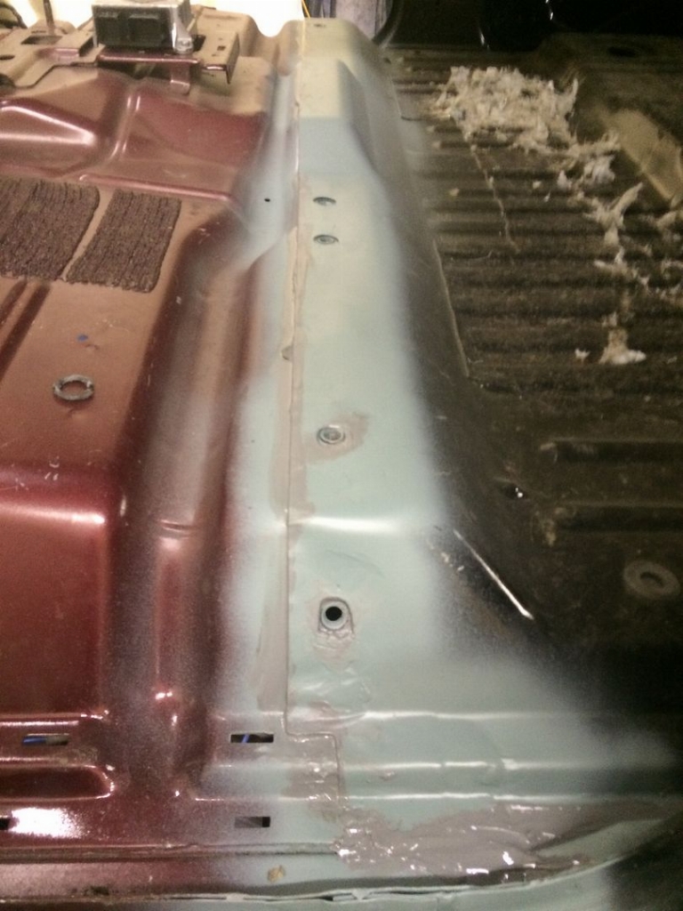

Made a little more room in the shop today, welded up the A pillars and ground down the welds. Tomorrow prime welds and caulk joints.
