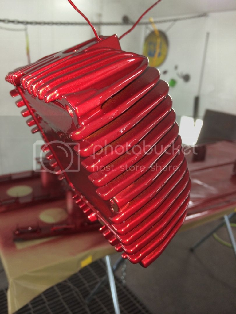

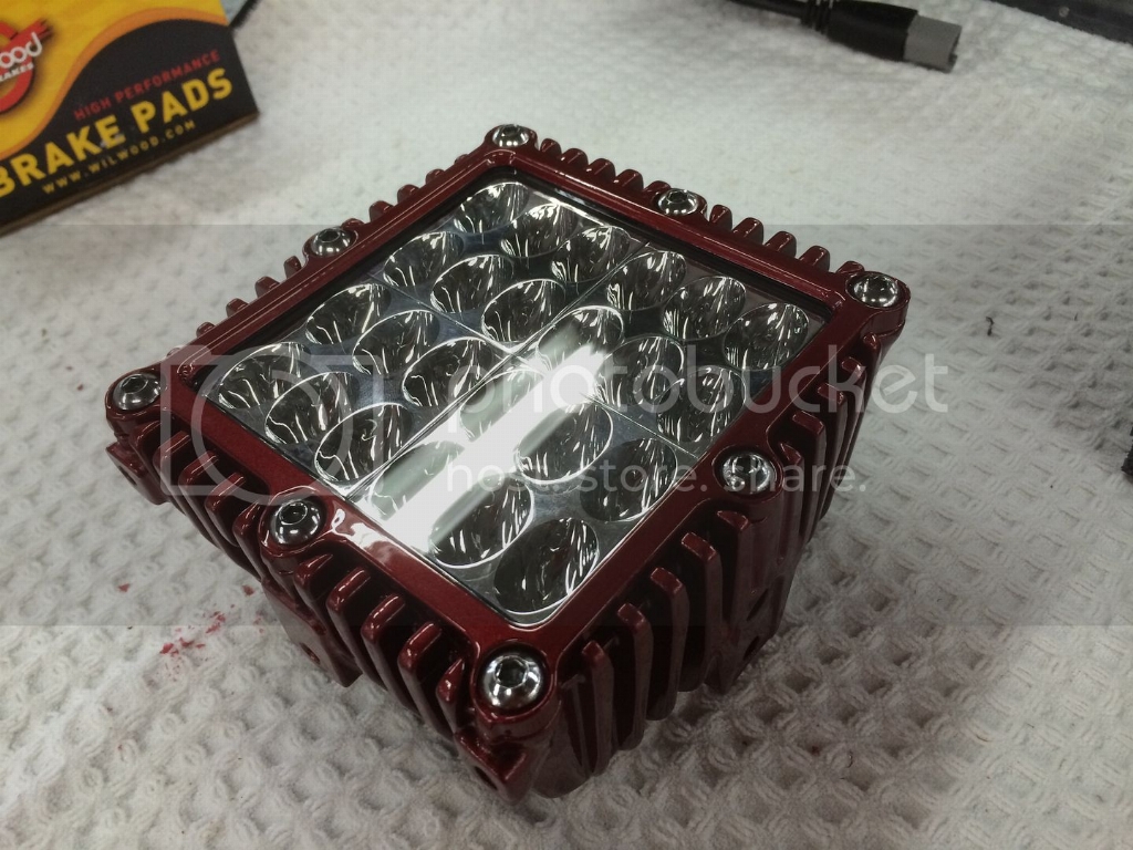

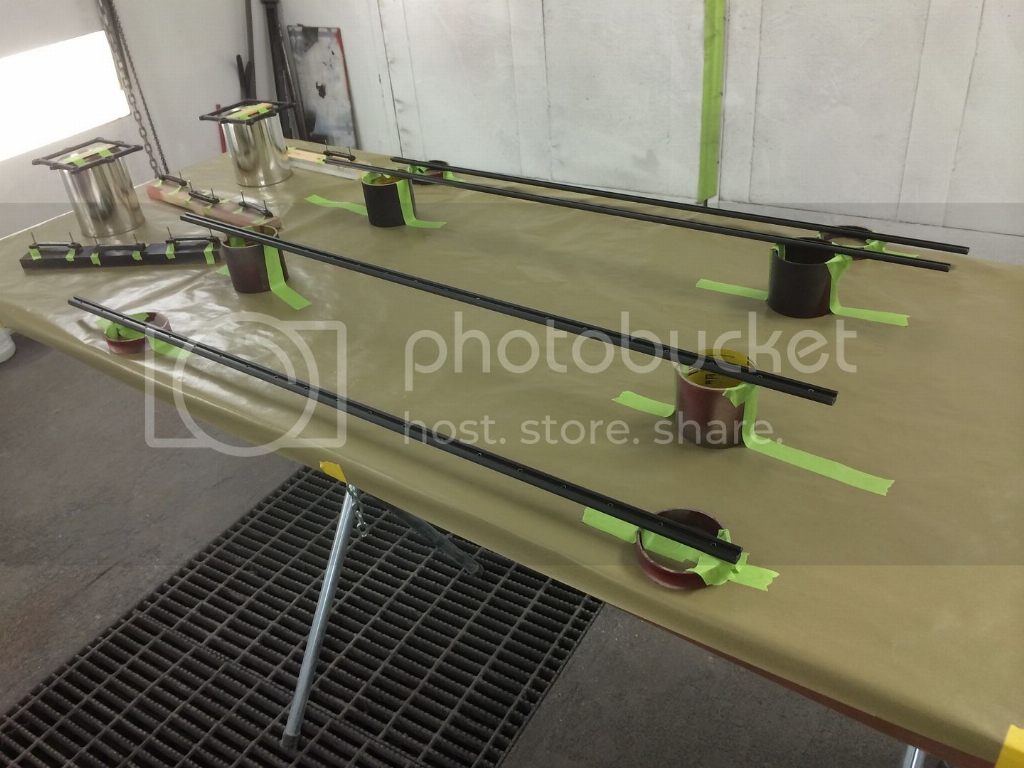

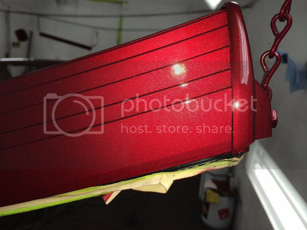

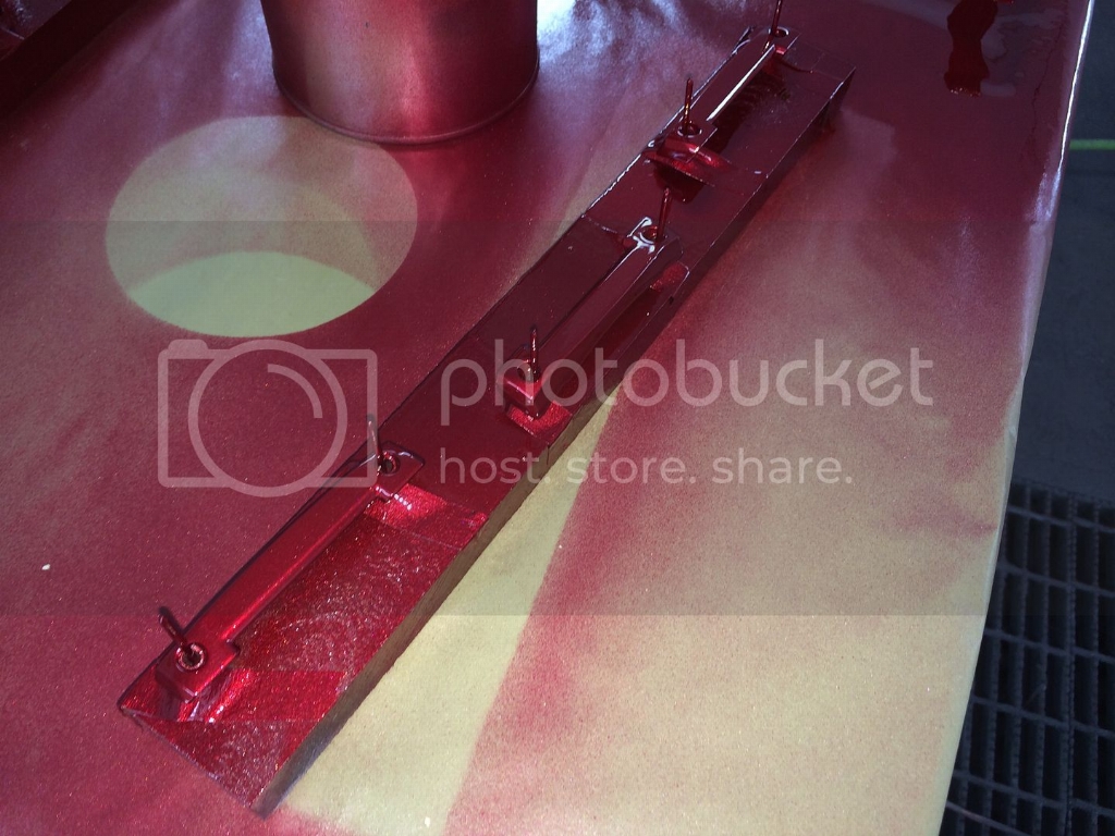

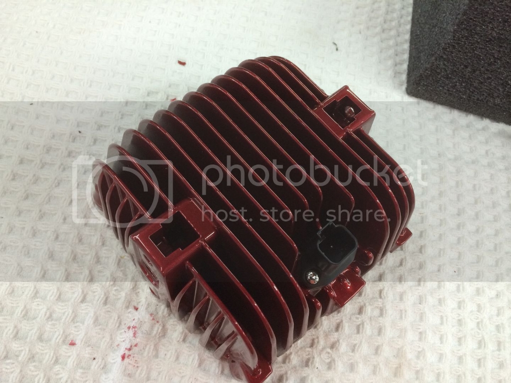

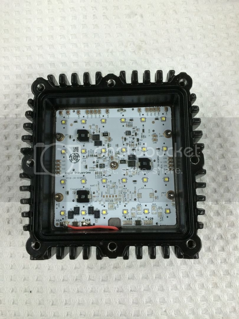

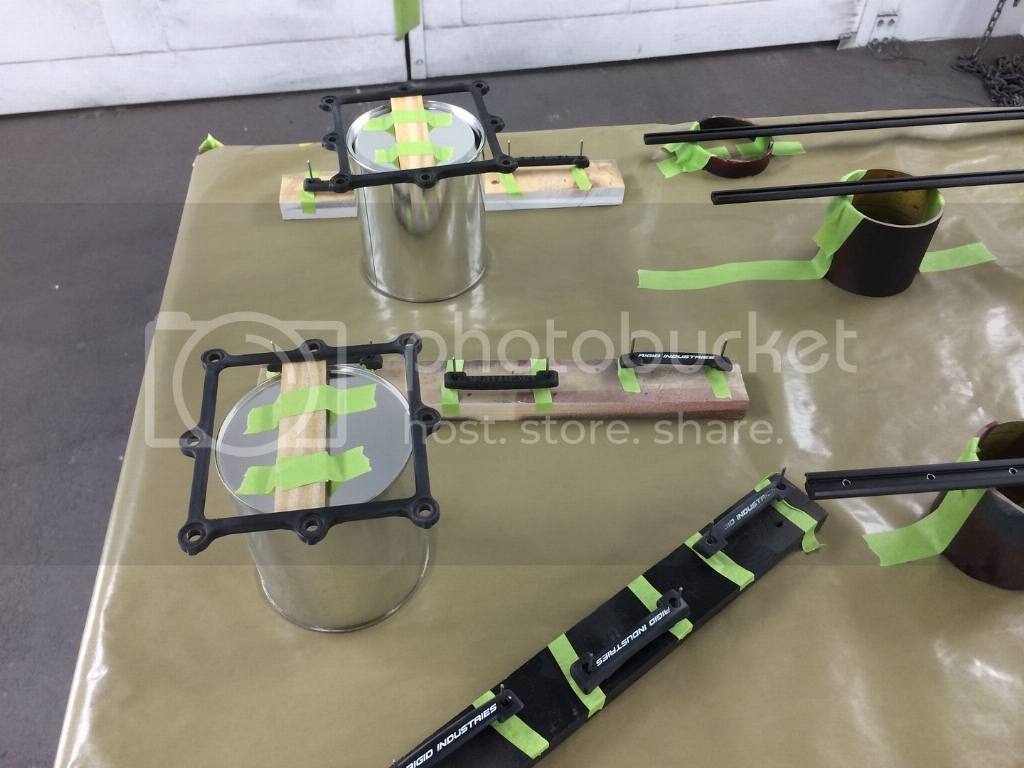

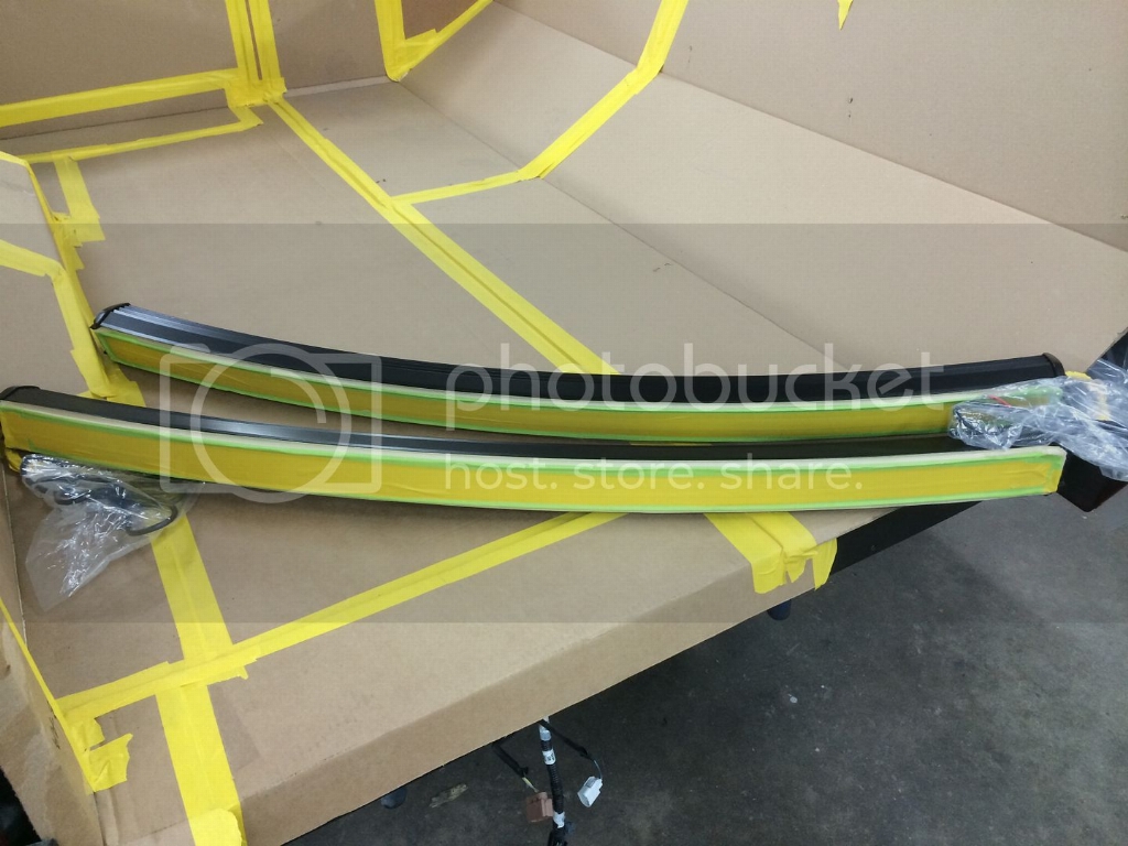

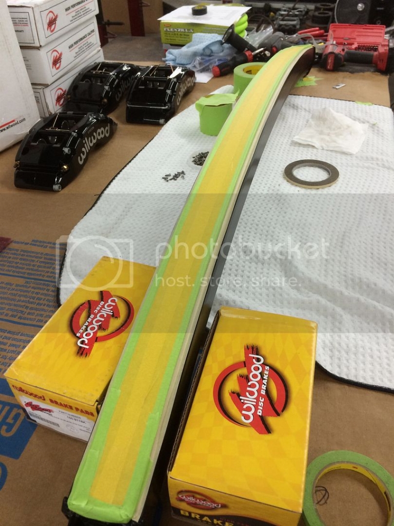

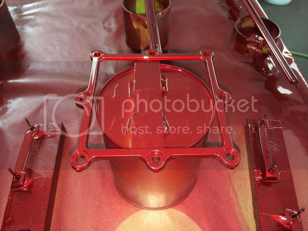

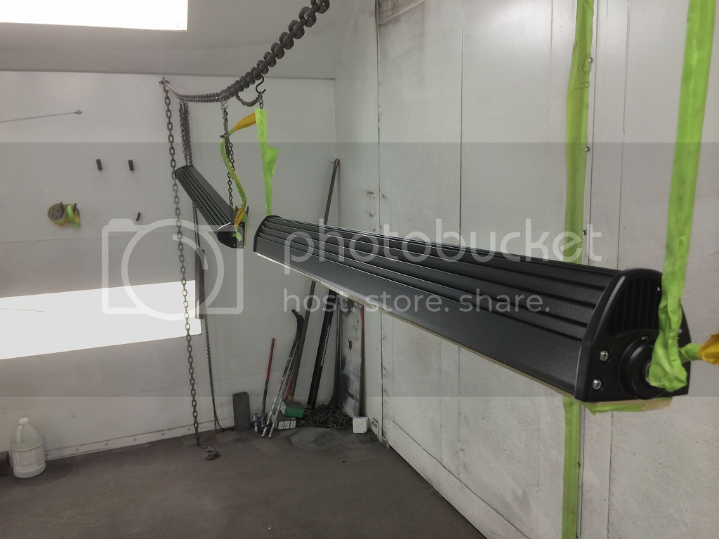

Time to get this thread moving again, time for some more rigid light work. The rigid d2s in the headlamps were painted red so that means the rest of the lights need to so everything matches. Another rather major project just getting all of those lights apart, taped and reassembled. Wow there was so many of those tiny allen screws it was quite unbelievable but I won again. Take a look at these beauties, they look way better in person I think.

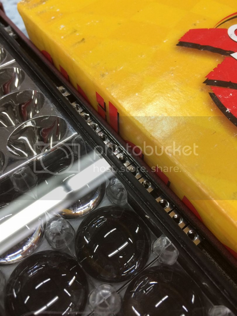

I still can't get over how bright those tiny led's are,

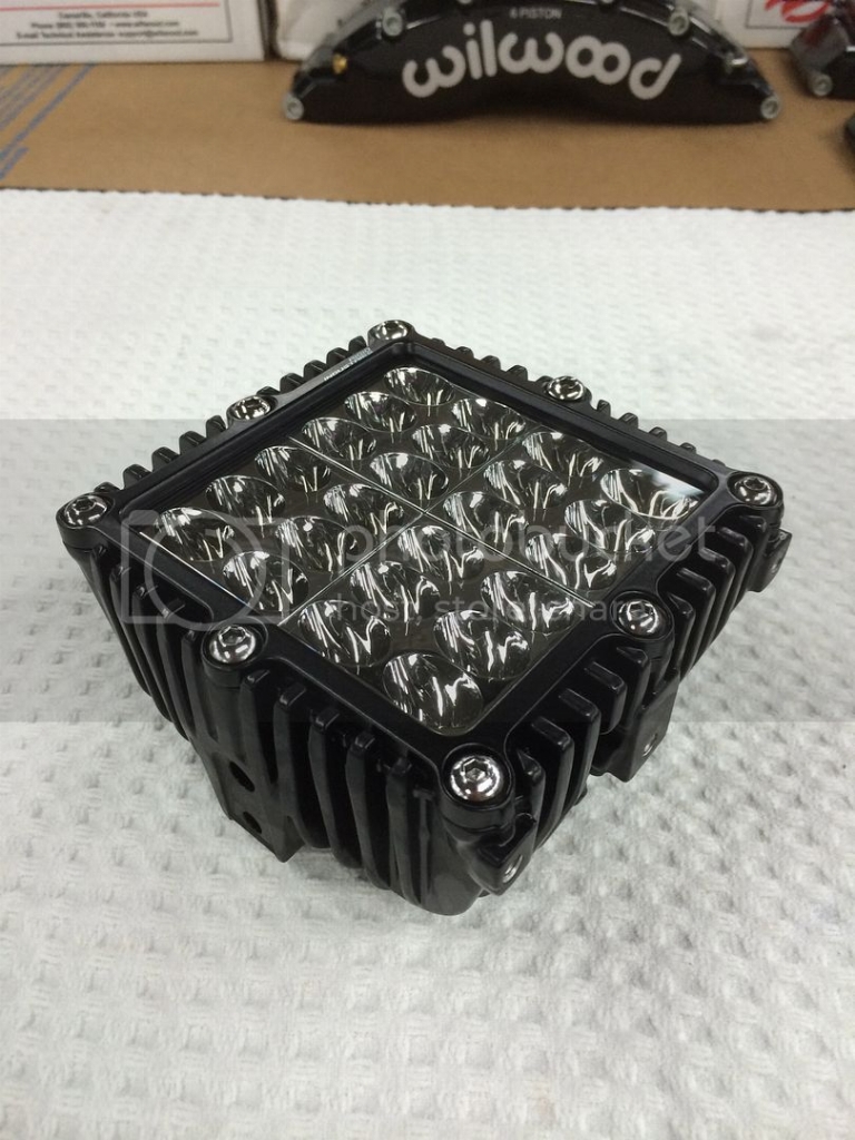

One thick lens on these Q series, by far I think the Q's have the strongest, highest quality housing/lens setup of the lineup.
HUGE!!!

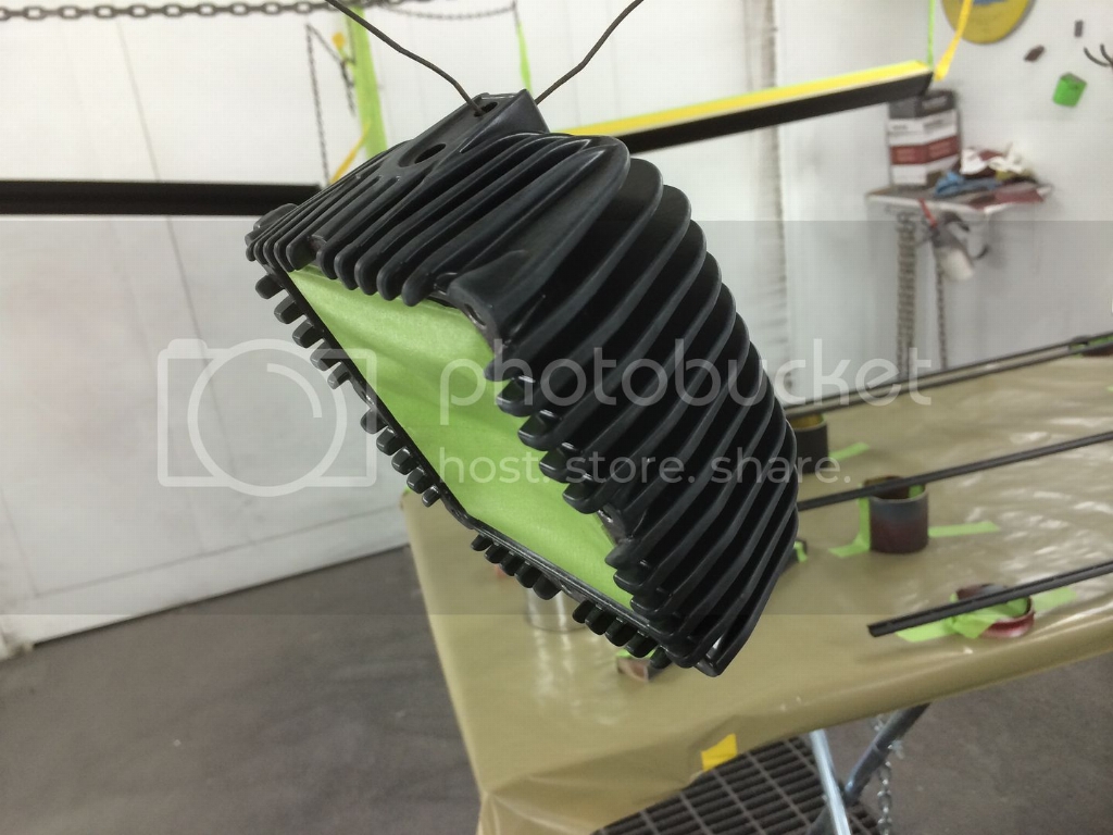

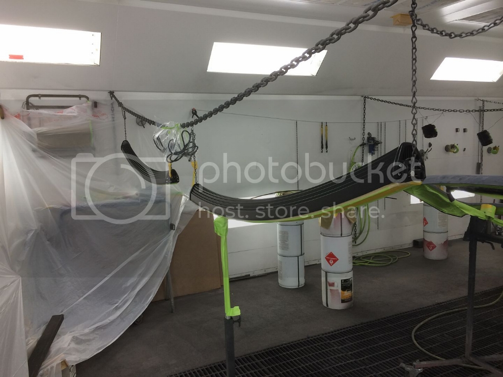

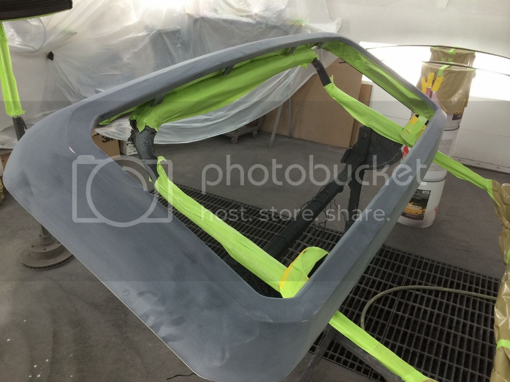

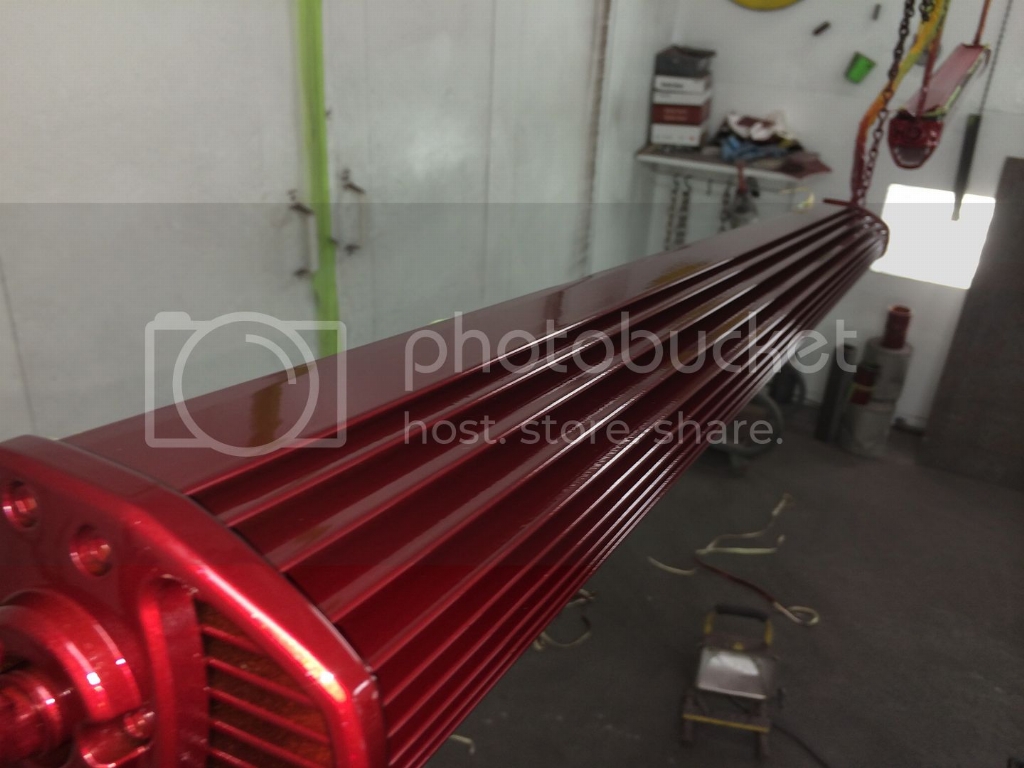

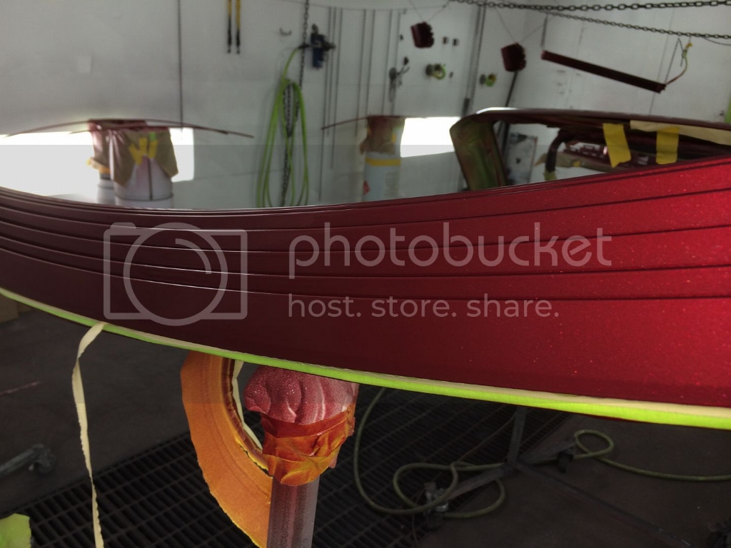

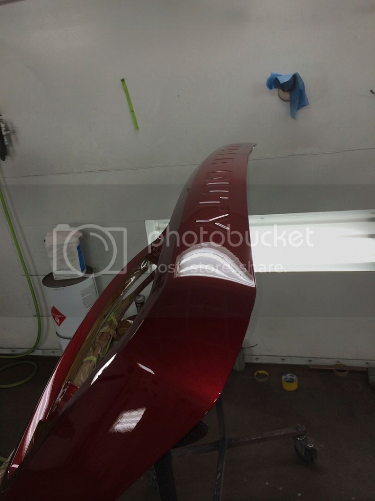

Grille surround finally getting painted, sealer sanded down in this picture,

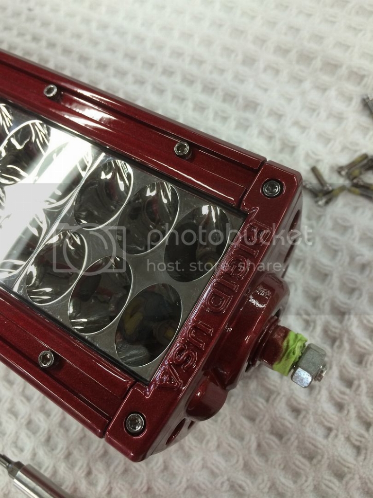

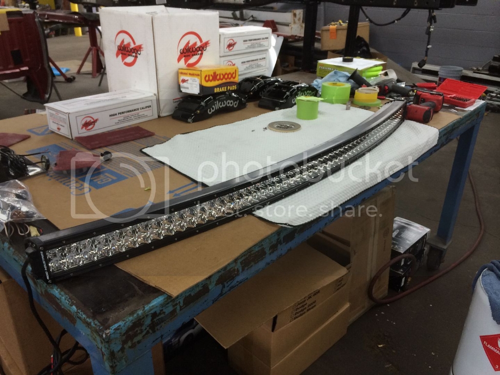

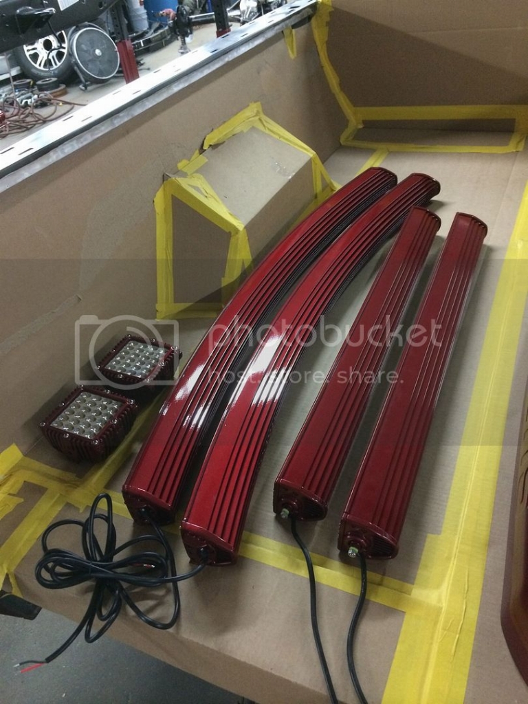

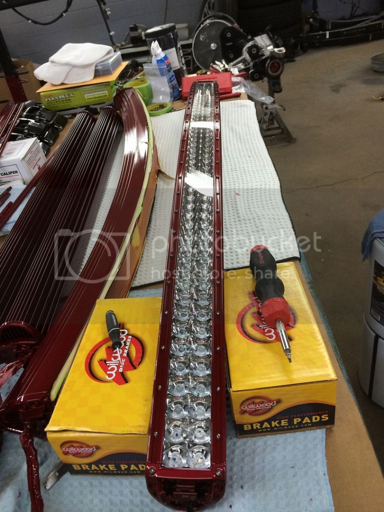

Let the reassembly begin,

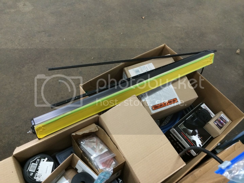

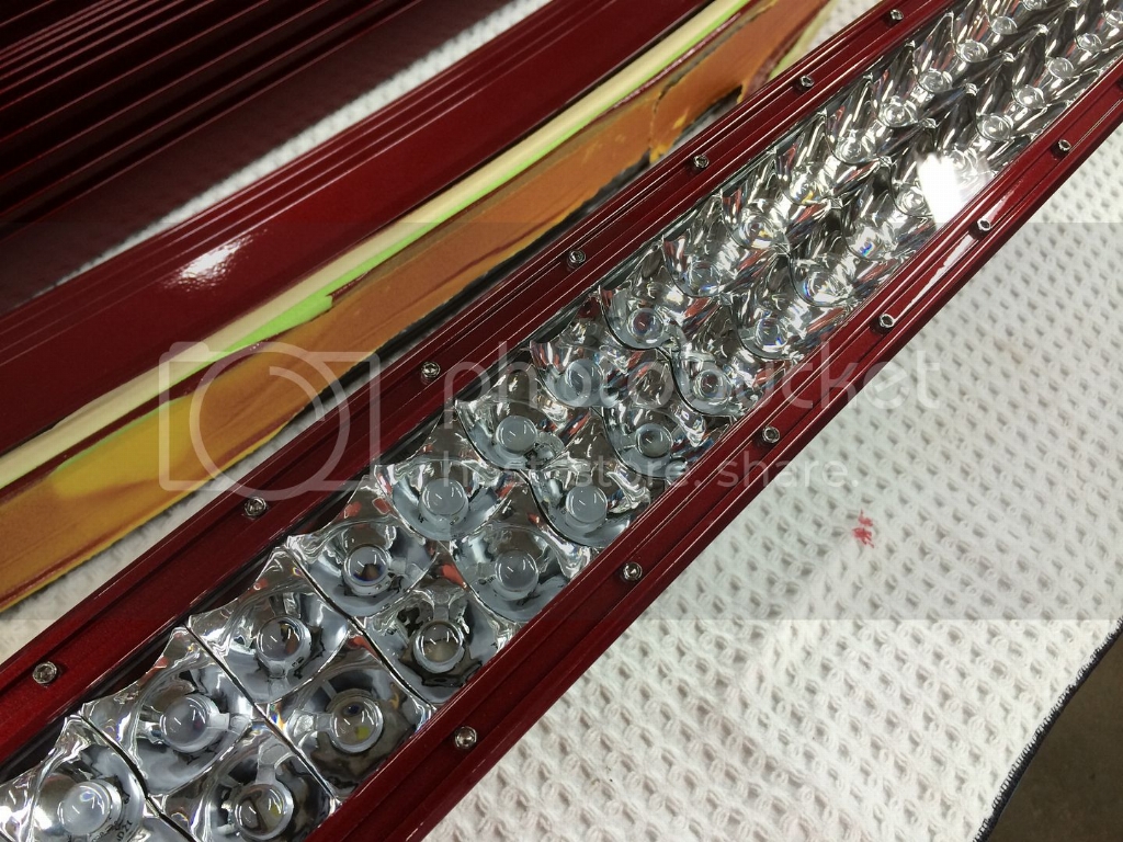

I love these 54''s now, I don't care if people hate on the roof light bars. These curved 54''s flow so much better than a straight or curved 50'' bar. Plus having them painted really should help them look one with the truck I'm hoping.

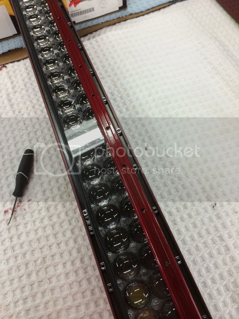

This was on the 40'' bars, all those little threaded plates are what the faceplate screws thread into. You have to manually line up each one of those little plates to line up with the holes in the faceplates, :doh:. This sucked, basically all you can do is use a small pick and arrange them while the faceplate sits on the face as a guide. Then don't move the bar the entire time your threading the screws in. If you bump it at all that little threaded plate slides in the rail and you have to unscrew every single screw, remove the faceplate and re arrange the plate so the screws will line up again. Trust me this happened once or twice at least and of course right at the end when I had like 2 screws left. Wow, I got it though,

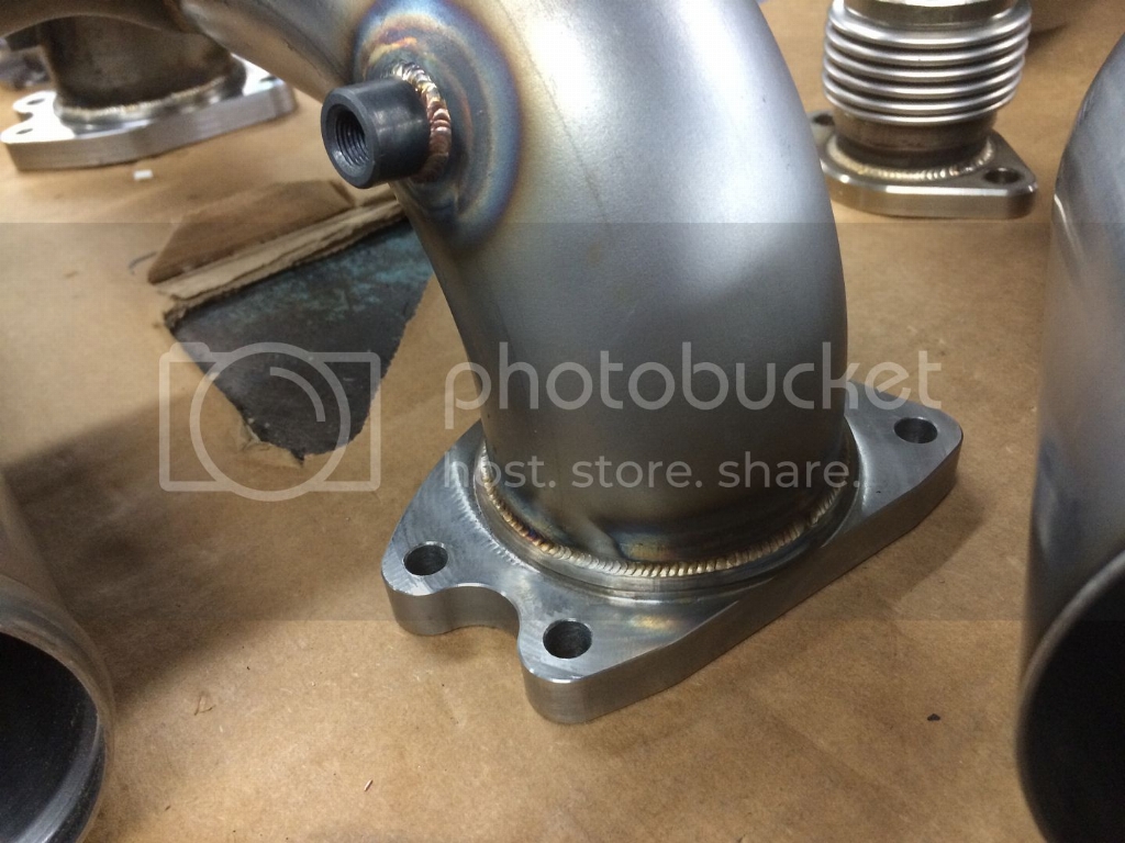

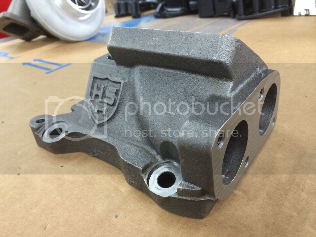

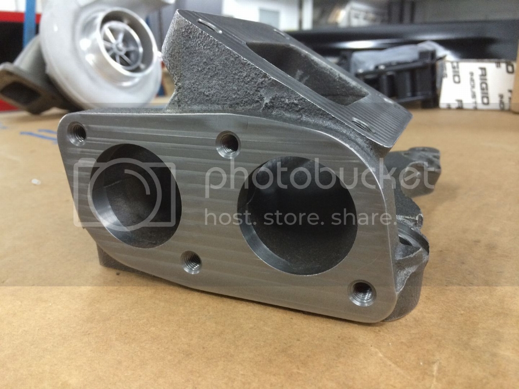

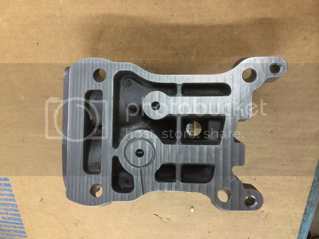

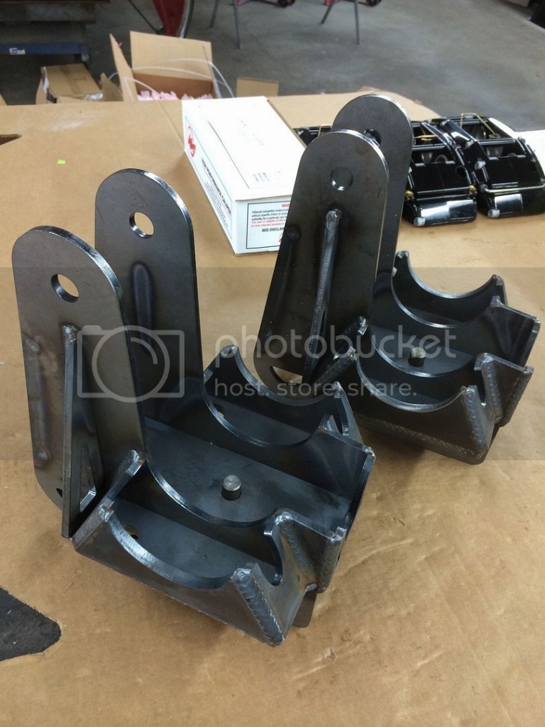

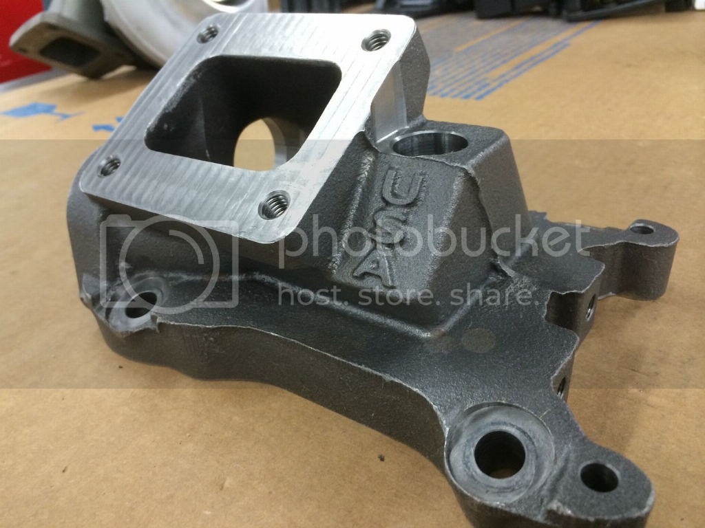

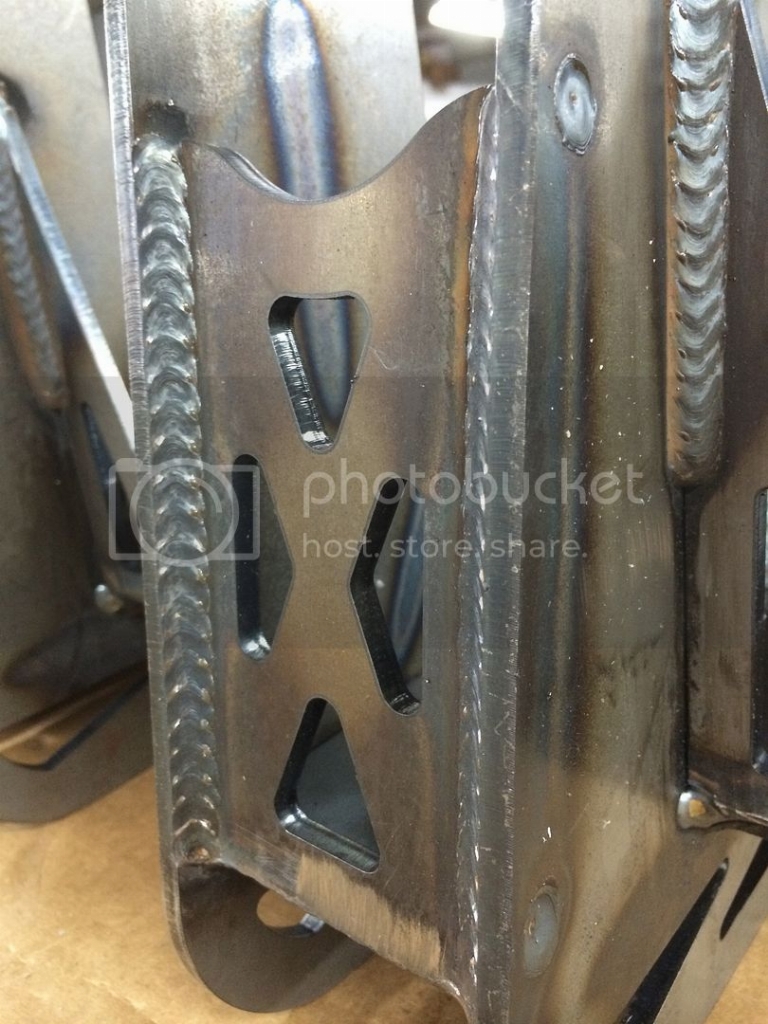

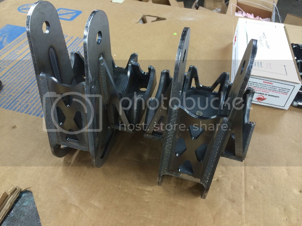

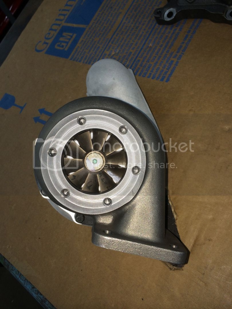

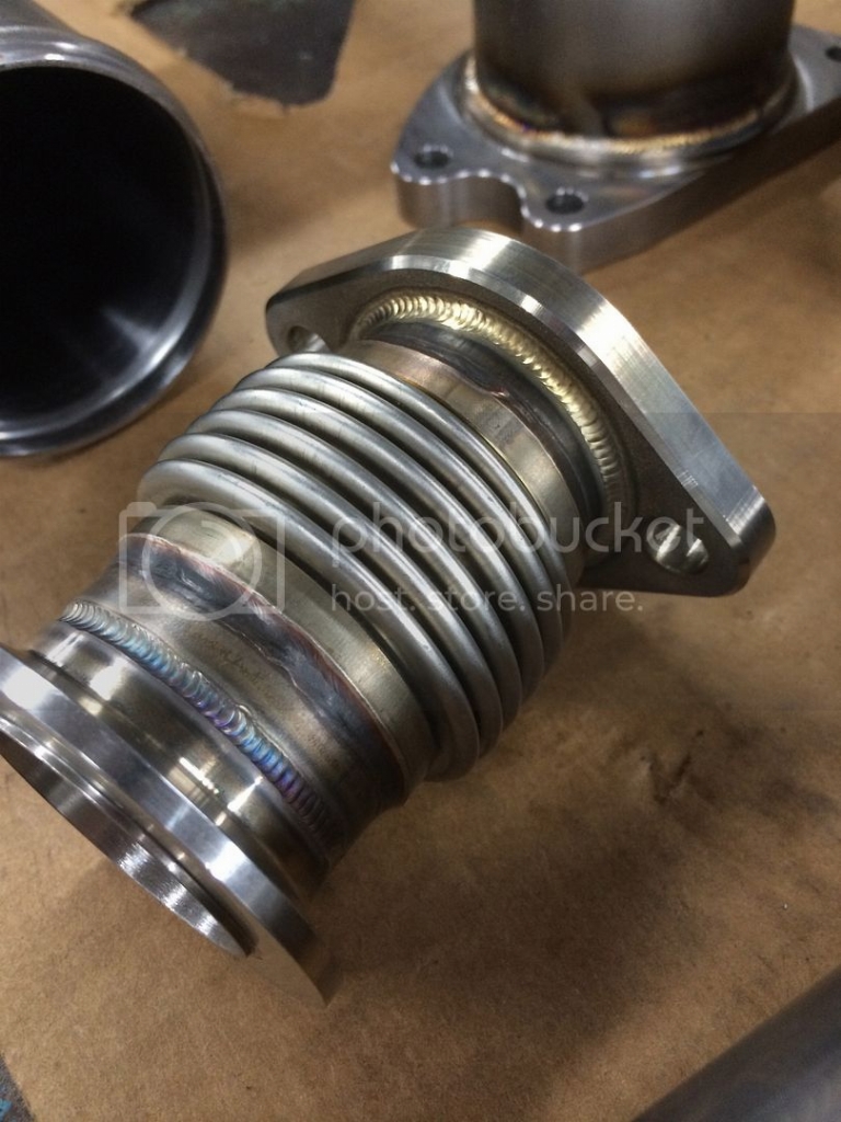

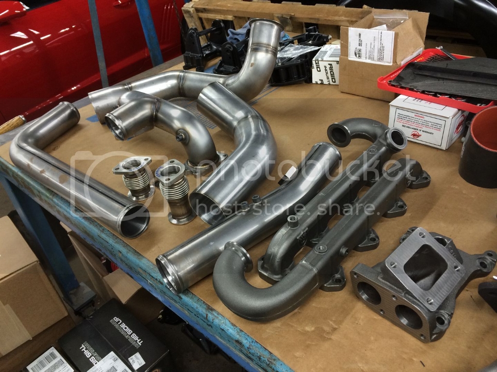

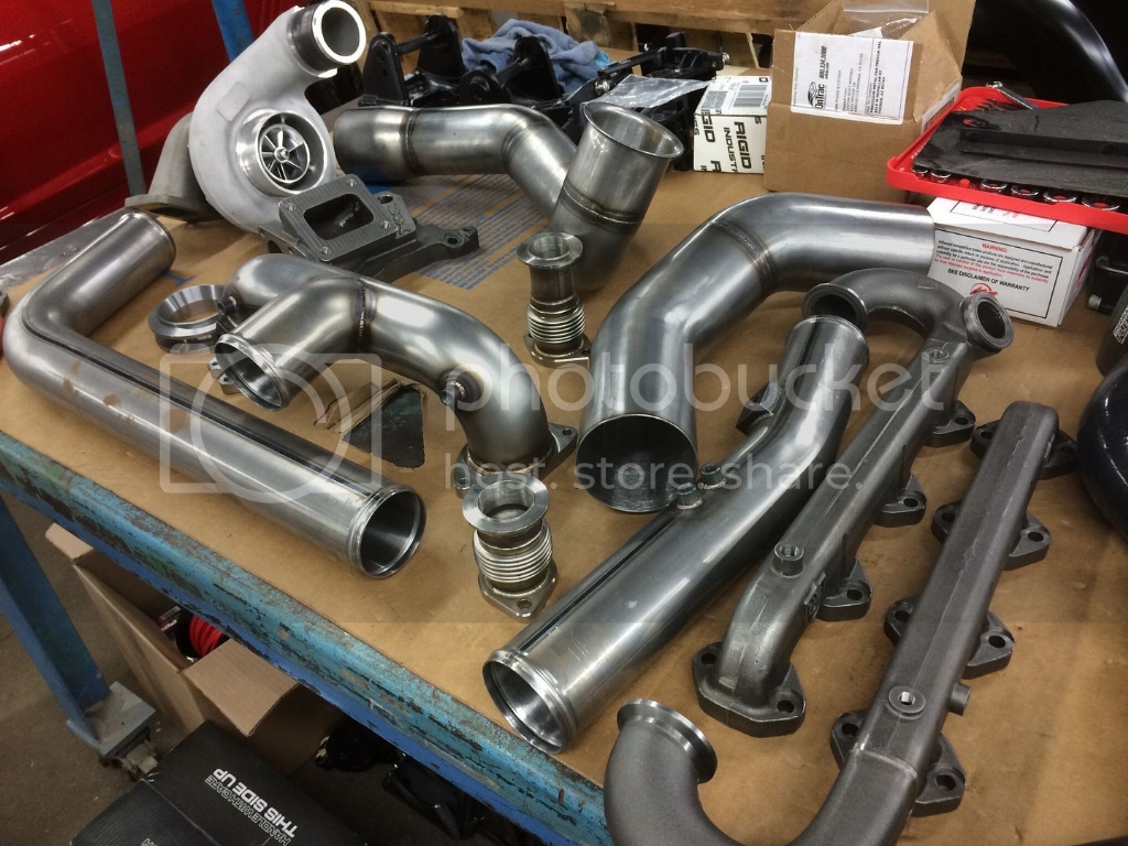

Like I've said I've been working with Bentley@H&S for months now trying to get the long anticipated H&S Motorsports single turbo kit. Well I can say the first kit has landed!!!! If your on the fence on what turbo kit to buy there is no doubt, this is the kit for you. Not one single piece in this kit has been overlooked, it's honestly hard to explain the quality and efforts put into this kit. I'm rather hard to impress and I can say this was probably the most impressive parts I've handled so far.
I'll just get straight to some photos I took, keep in mind I just received this kit friday so things will progress quickly and more photos will be posted.
Note: This is a preproduction prototype kit, you may or may not receive the identical parts in your production kit.
:naughty::naughty::naughty:
Don't worry, there will be more, a lot more getting posted about this kit.
