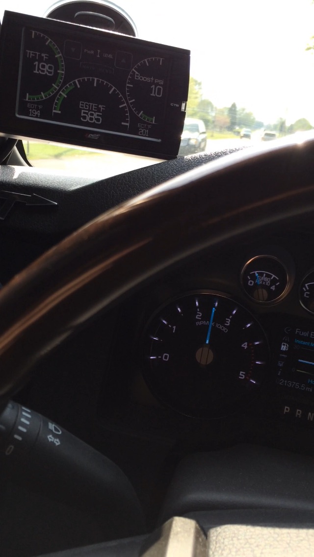

Dead stop, hit 10psi at 2500rpm taking off. Pedal to the floor. I have stage 2 no limit intake, Midwests stainless intake piping kit, and a 4-5" exhaust. Running v7 pip street tune. Zero smoke. Runs like crazy once it spools though!

when using the term " laggy" lets talk about at what rpm you guys are at when you are making 10psi or more.
My truck from dead stop hits 10psi at 2500rpms
same here 10psi at 2500rpm
