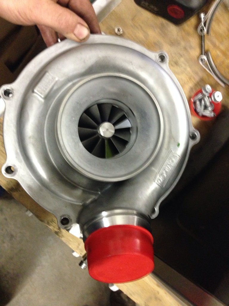

Thanks, it's getting factory ptm flares, grill surround and harely style lights. Unfortunately, it's not an opinion that it has more lag. The '15 turbo is not as impressive as was hoped. Especially after I had the time to tear one down and measure wheels and get the full scoop on the new turbo. It's basically the same turbo only with a single compressor instead of dual, which is why it spools slower. The dual compressor wheel will never be beat for it's instant spool up.
Very interesting. I was under the impression that it was going to be a variant of the gt3788va turbo that is found int he dmax and 6.0 trucks. That would mean larger turbine wheel, larger vanes, larger comp wheel, larger turbine shaft etc...
You are saying it is still very similar in size to the 11-14 turbos :cursing: that sucks
Any chance you got some pics?

It is the same as a 11-14 but with different compressor.

Thanks for the pictures. I have been meaning to try and get my hands on one of these bad boys to see what can be done to it...
