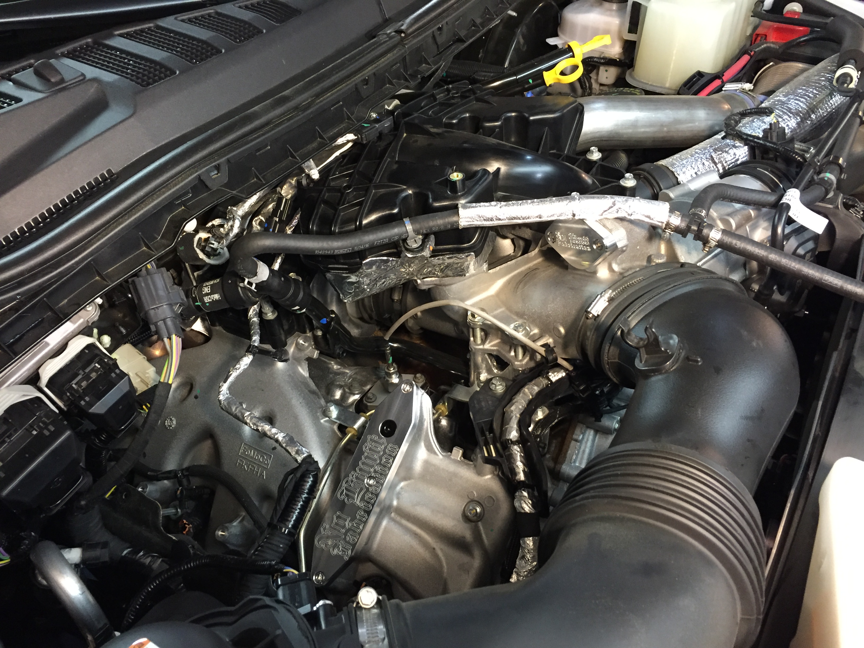

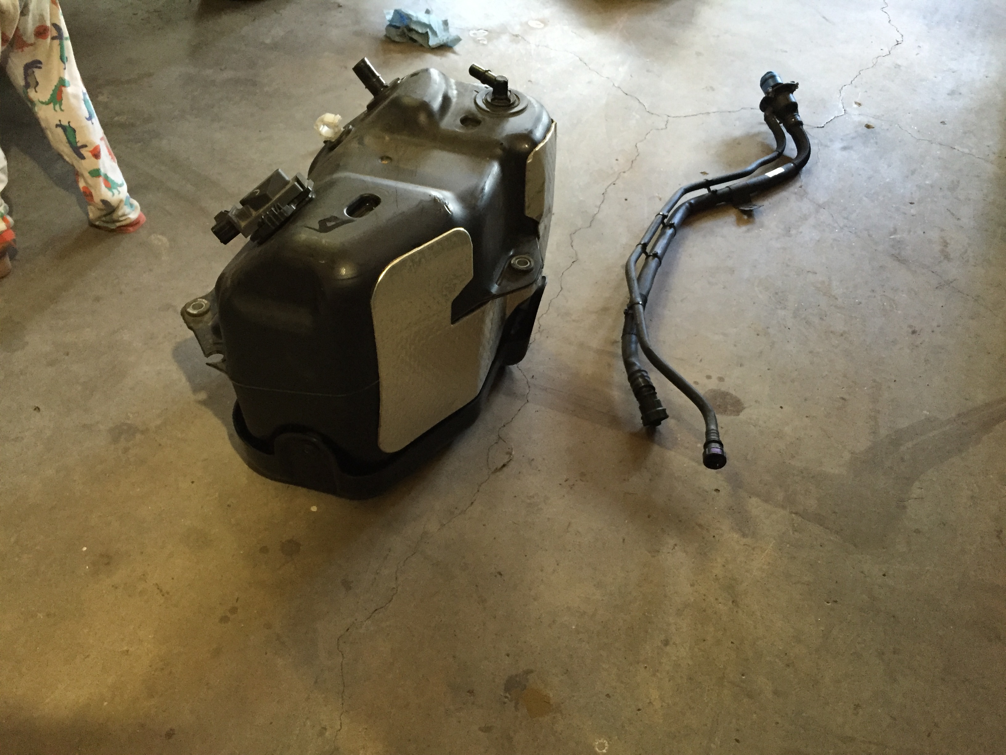

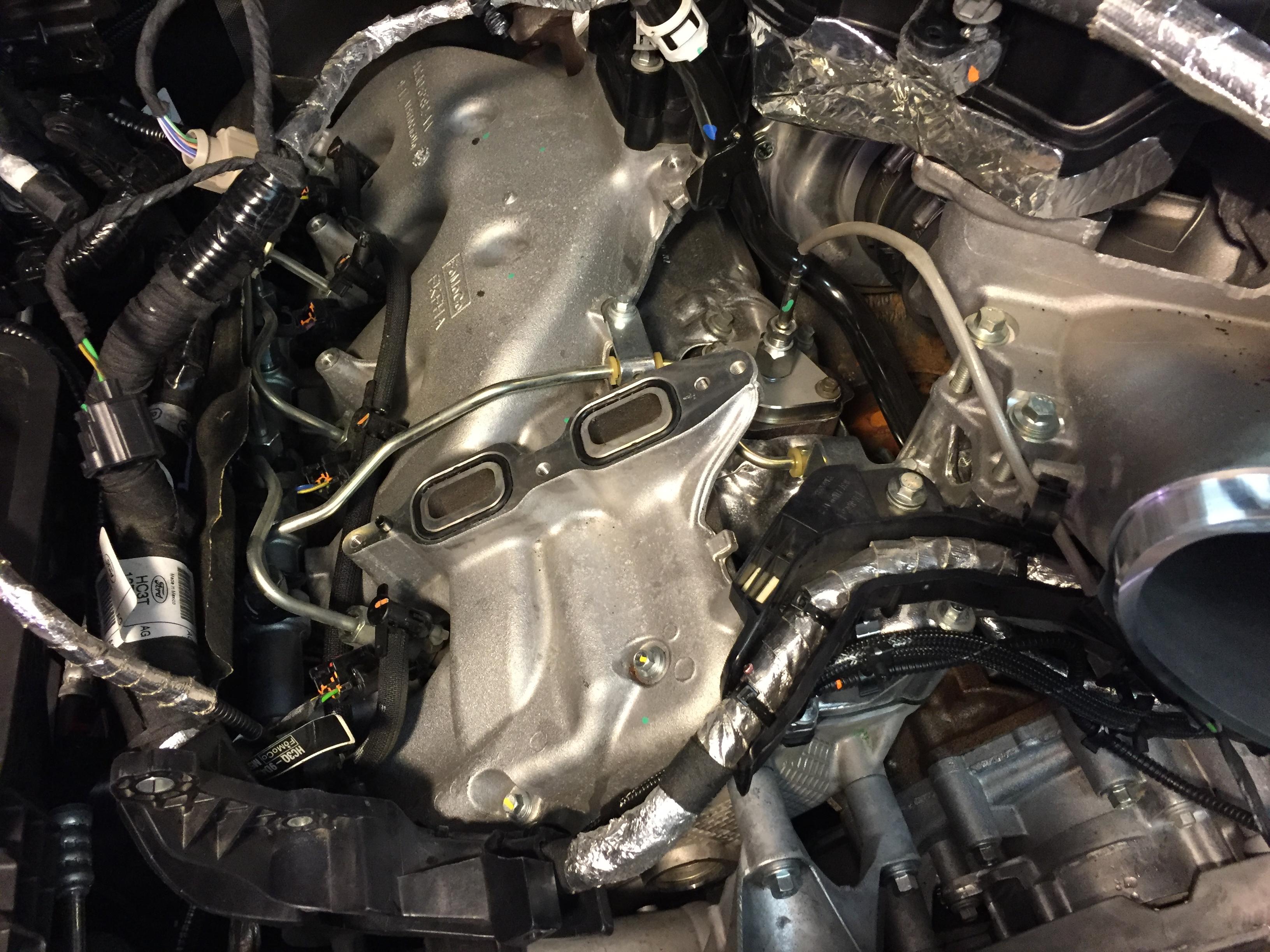

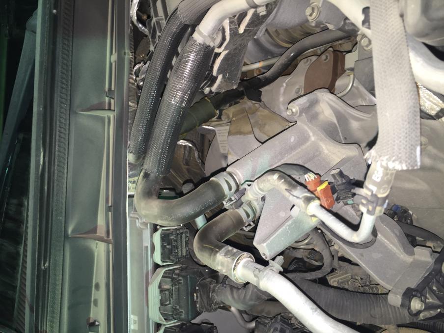

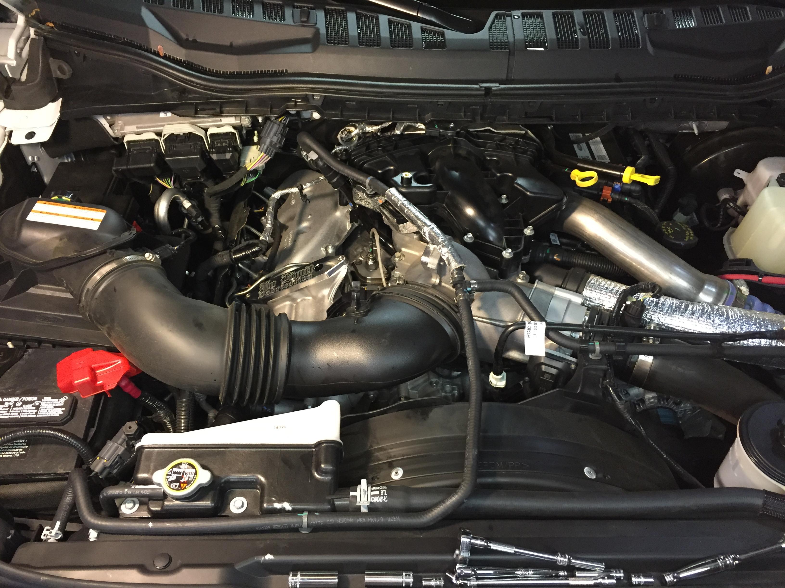

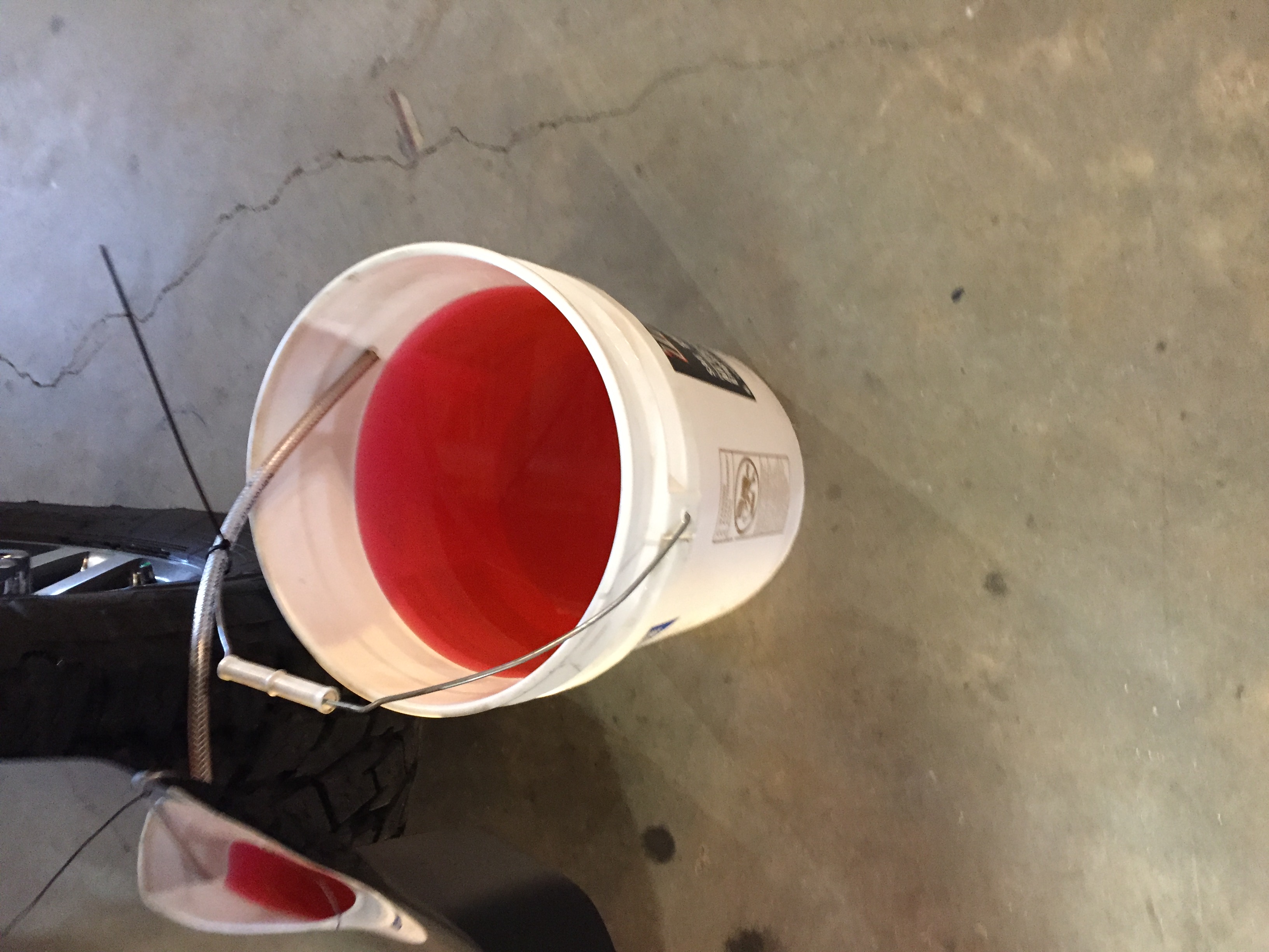

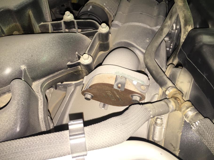

figured out how to upload photos, since i cant figure out the youtube thing apparently
overall it was alot easier than i expected. The passenger side coolant drain is a pain to get opened, drivers side is cake and it seems the drivers side drains the whole system anyway.
I re-used a factory coolant "T" and turned it around, tus eliminating the need for the barbed brass fitting that comes in the kit, and it fits and looks factory this way.
All the bolts are easy to get at, cooler came right out, other than having to work off a ladder it was a pleasure, Almost as easy as my last cummins 6.7.
Bought some 50/50 m coolant just in case, but thus far i still have a little left over from the drain, even after a few hot/cold cycles.
had a de-rate at first, with no CEL, full power thru 1st gear then no more than 8 psi boost. On a hunch i un plugged the re-located egt sensor and she was back to normal. never did get it to throw any codes.

Thanks for the post! Coming from a 7.3 I've never dealt with this stuff before. So it certainly will help me with my installation. My goodies should be arriving later this week, can't wait to get it installed. So you unplugged the egt sensor and it ran fine?

No prolem at all, i had not seen 2017 instructions anywhere on the net so i wanted to post up what i could to help others.
Yes
I installed the probe from the egr supply pipe into the block off plate as you would with afternarket tunes to read egt's but then i remmebered this is a factory tune and that will not read like it will with an aftermarket tune. *** probe would not fit threads
I would suggest unplugging your egr stuff and driving awhile before you remove the cooler. Some people are apparently having issues throwing codes with egr with these export tunes. Part of the reason i am so curious what application exactly this tune is used for is I would like to find out what emissions parts this application does and does not have
Also you cannot un plug the throttle butterfly valve as with the old trucks with this tune. You will get a cel and de rate. Ask me how i know

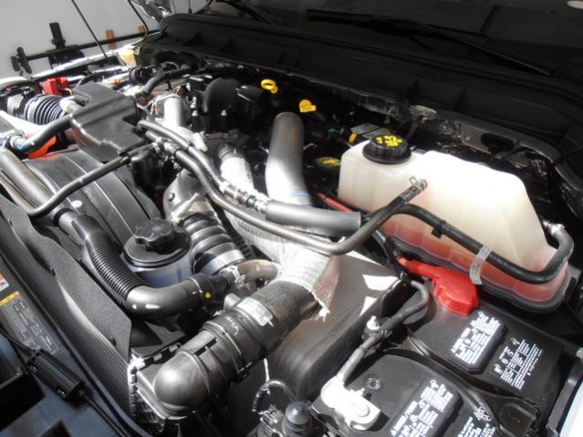

I have seen that egr bypass and the pictures floating around on the net of it installed like the attached. Also i attached pictures of a mexico truck, that has egr but no ***... I look forward to seeing the 2017 versions since they did away with the two hoses that run into the top of the cooler. Im sure it is very similar to aftermarket kits.
