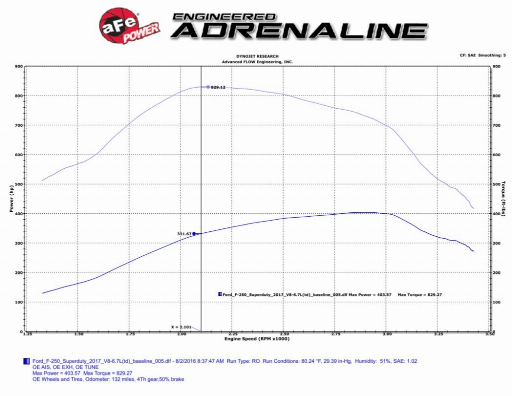

AFe dyno test.

It's the most choked up and restricted 400hp I've ever driven lol. My stock '15 felt more lively to throttle input then does my '17. With that said it definitely feels like the '17 has more power at full throttle.

Glad I'm not the only one who thinks it's feels more sluggish, my 15 was more responsive. I read they limit torque in the first 3 gears on the srw trucks now which might explain why.
