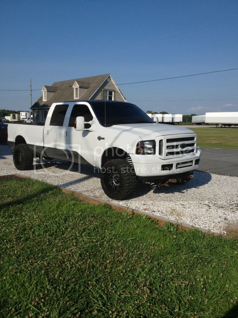

im running a 20x12 and 35/12.50 on a 2.5" leveling kit. trimmed the fender wells hard and some on the pinch welds.. i clear flexed offroad now. nothing visible from standing looking at the truck has been cut

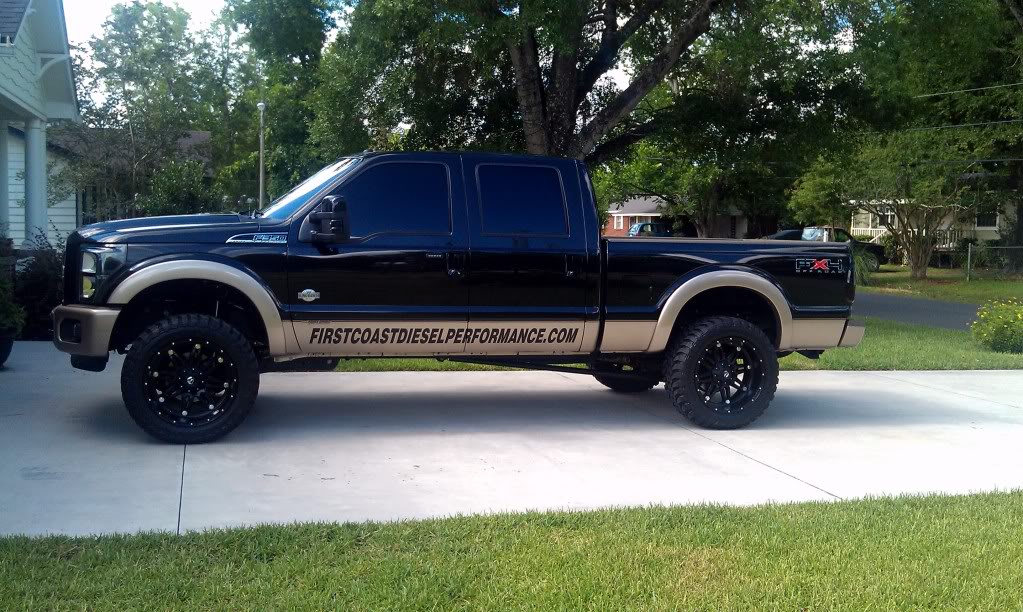

This was 325/60/20s ....it was a 34" tire and with my 2.5 leveling kit it rubbed alot,after cutting the liner and the pinch weld back I had no problems except at full lock.
