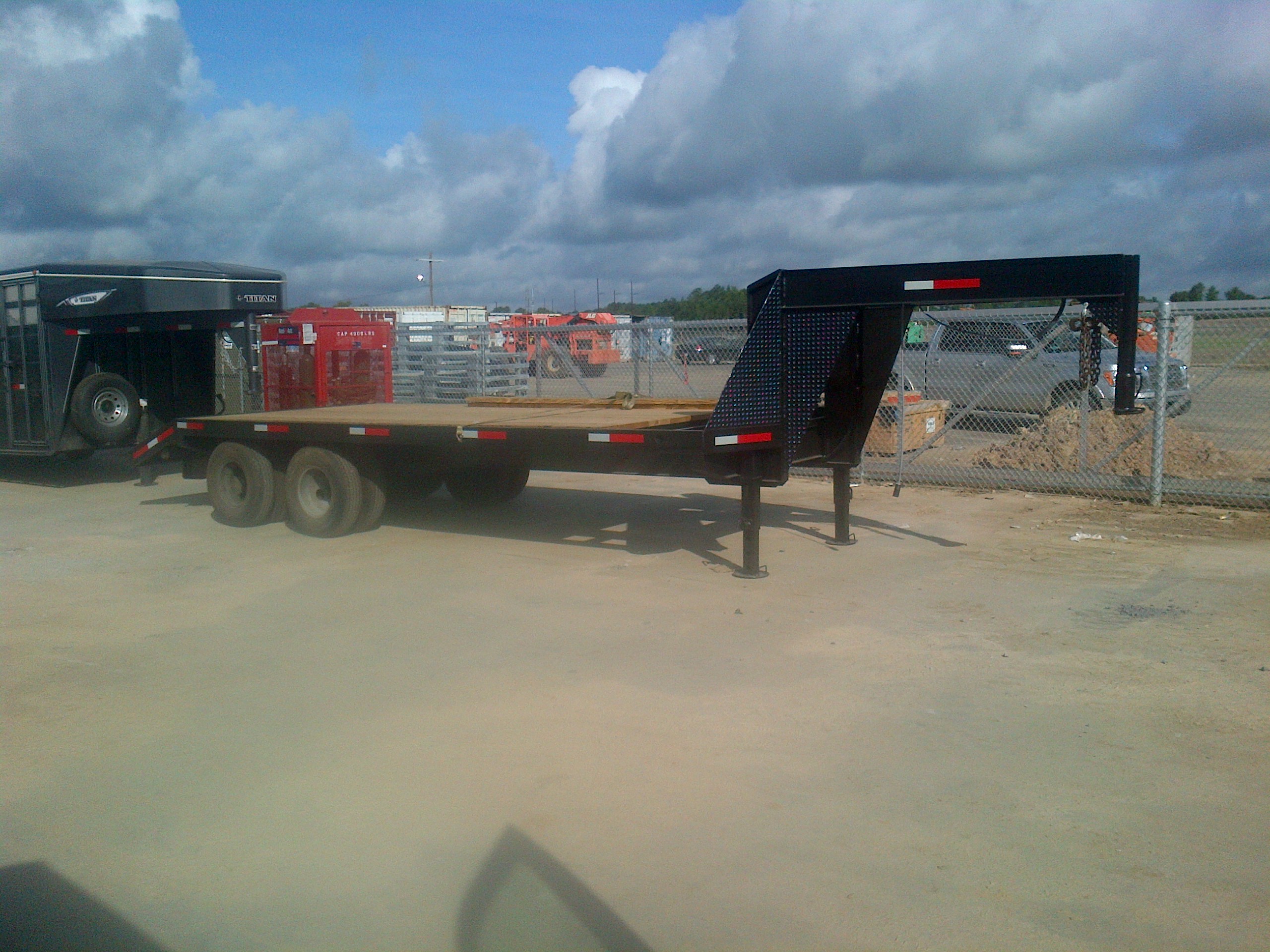

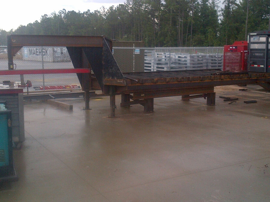

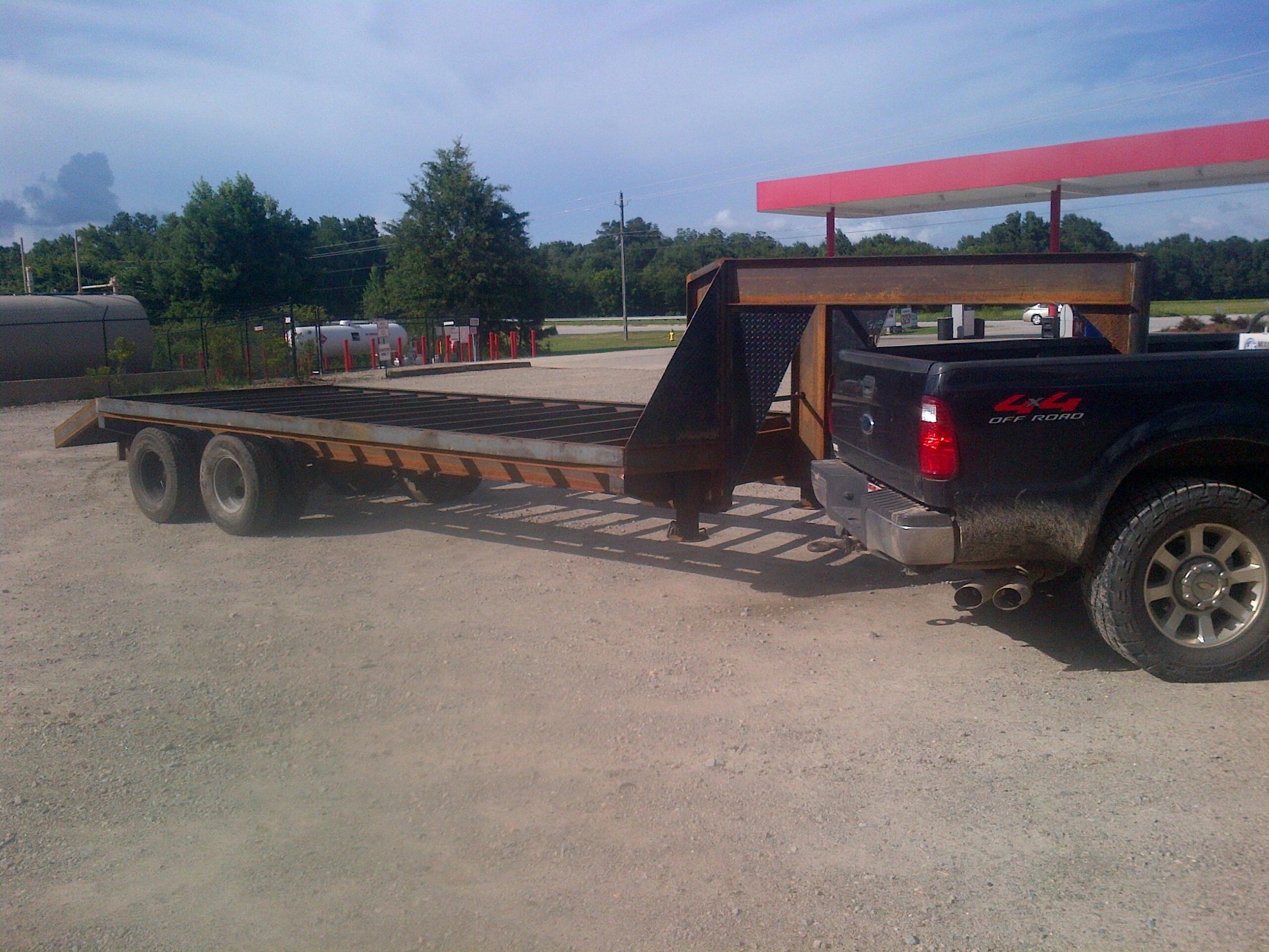

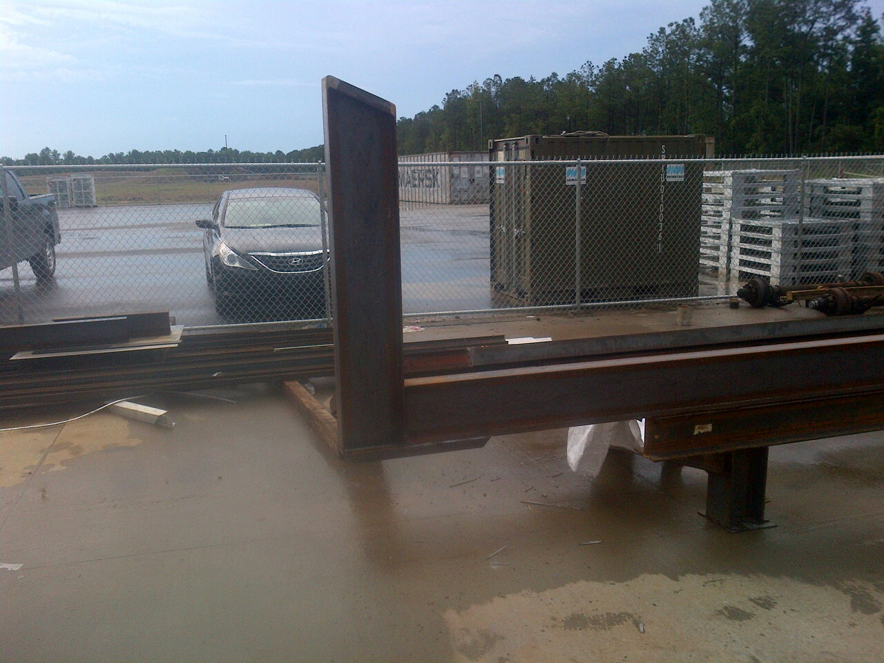

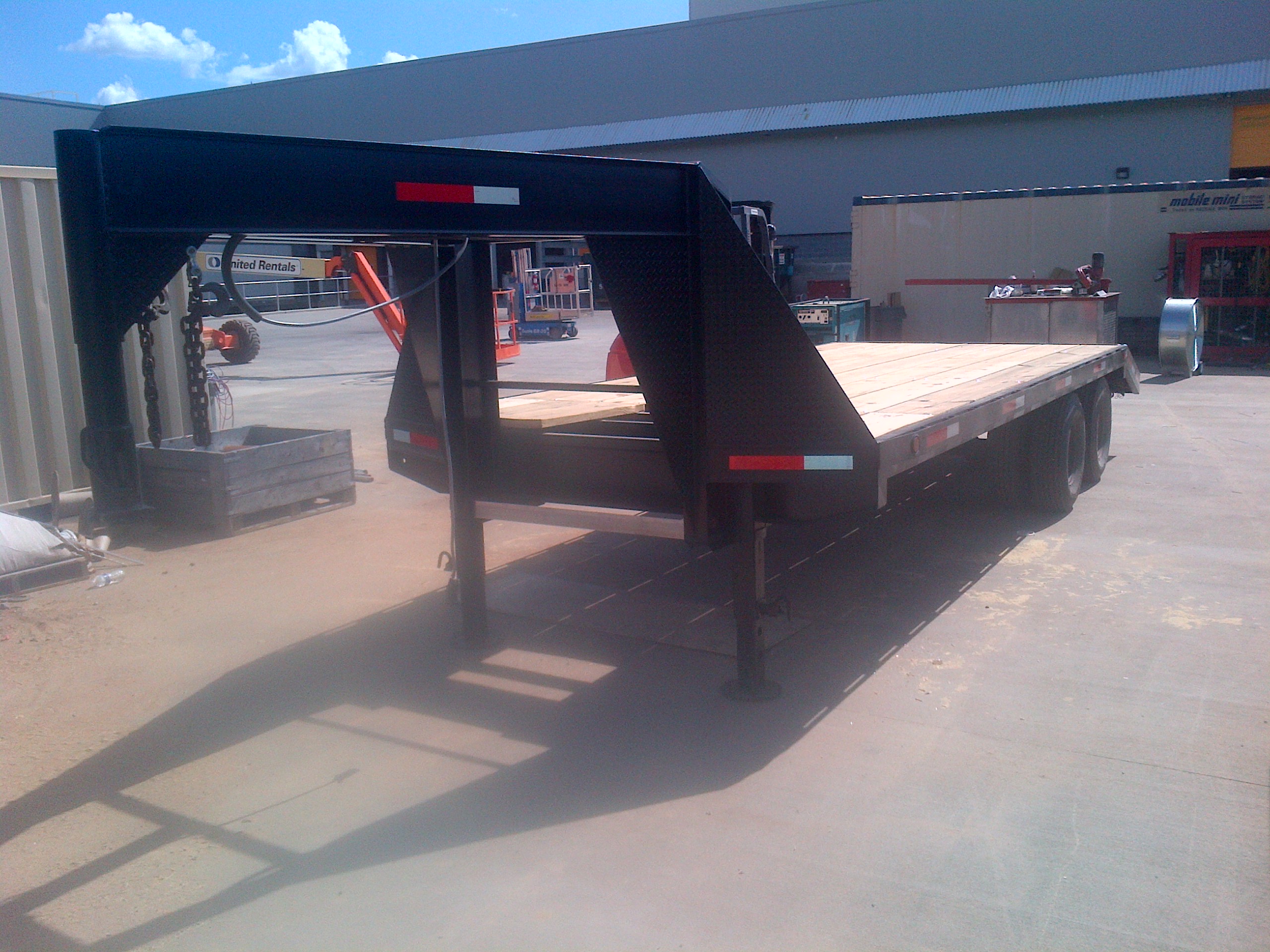

here are some pictures

why so short? to me it kinda looks goofy. very nice work on the building though. i need to do this as well but when i do it will be atleast a 22ft deck with a 5' beavertail..
on edit maybe it is the angle of all the pictures that makes it look short? i dunno. looks good though. whats your plans for it?

Most I have seen are made with 3" channel runners on 24" CL. This is 4"x5.4lb channel on 16" CL.
Main frame rails are 10x19lb.
