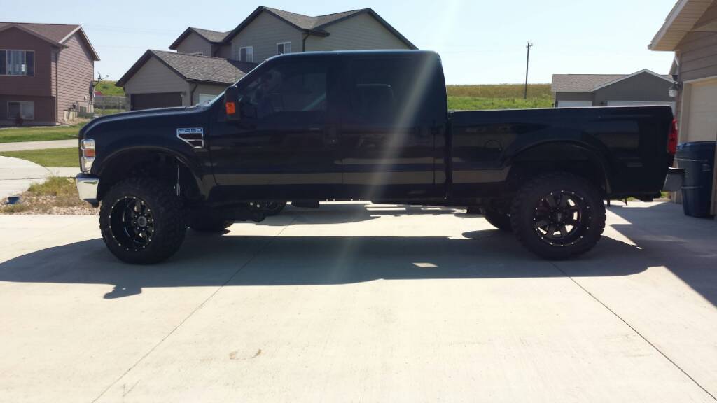

Just put mine on today with two jack stands and a 4ton floor jack. Everything went smooth with no fitment issues. I'm really happy how it came out and the truck drives better than it did with the 1.5 inch ready lift leveling kit I had in to for two years. Only tough parts are loosening the big frame side track bar bolt and that was about it. Start 1030 this morning and was done by 4 included was a trip to the hard ware store lol
